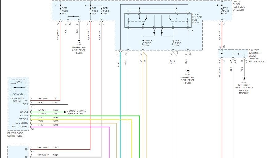

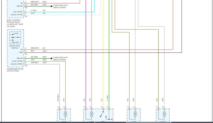

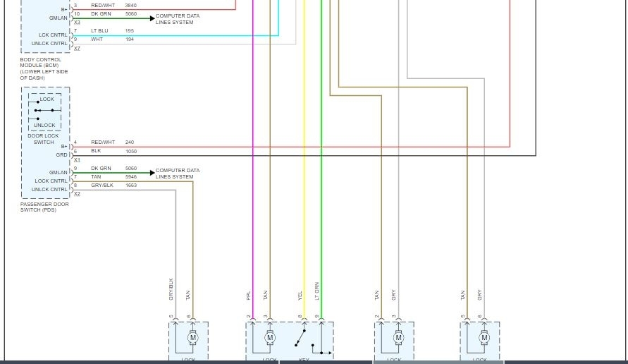

I keep hearing a clicking coming from the left rear door panel. sometimes the windows want to roll themselves down. the radio comes on with only a travel sound most of the time but has worked maybe three times since I’ve owned it. I’ve checked the fuses and they all seem to have power on the left side fuse box.

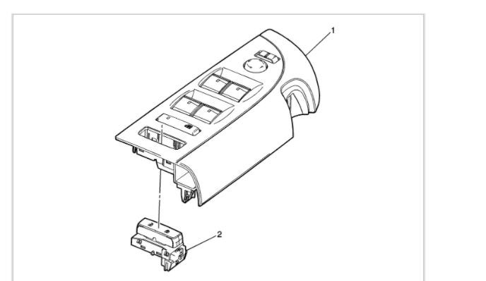

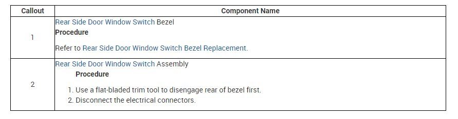

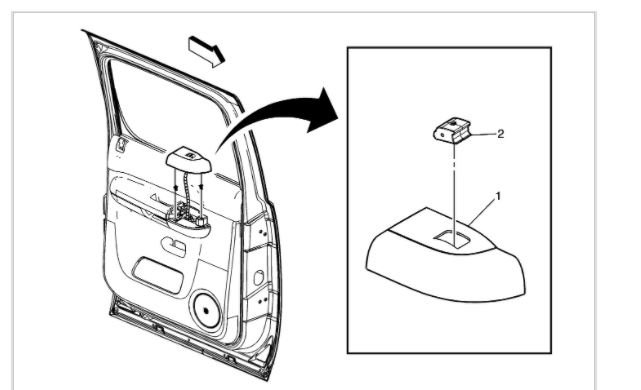

I would go to the door and remove the window switch to be sure it is not window related.
https://www.2carpros.com/articles/electric-window-repair
I would also remove the master switch at the left front door for the power lock. The lock actuator may be the clicking noise in the door.
