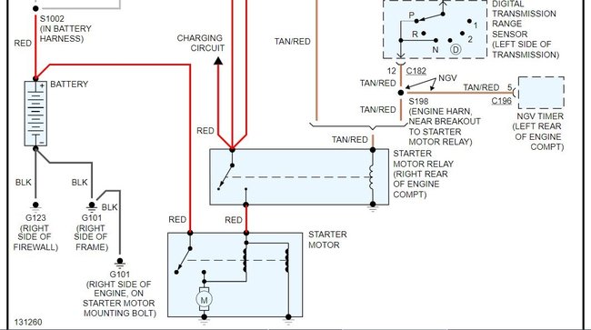

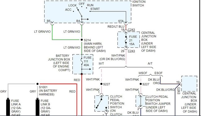

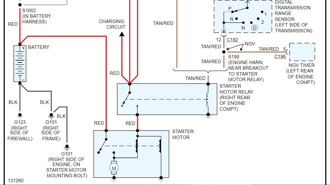

I attached a wiring diagram for you to view.
Check the fuse for starting. Fuse 21 in the under dash fuse panel. Check for power on both sides in the start position.

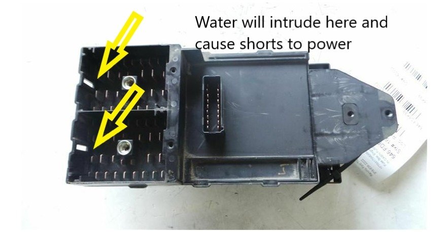

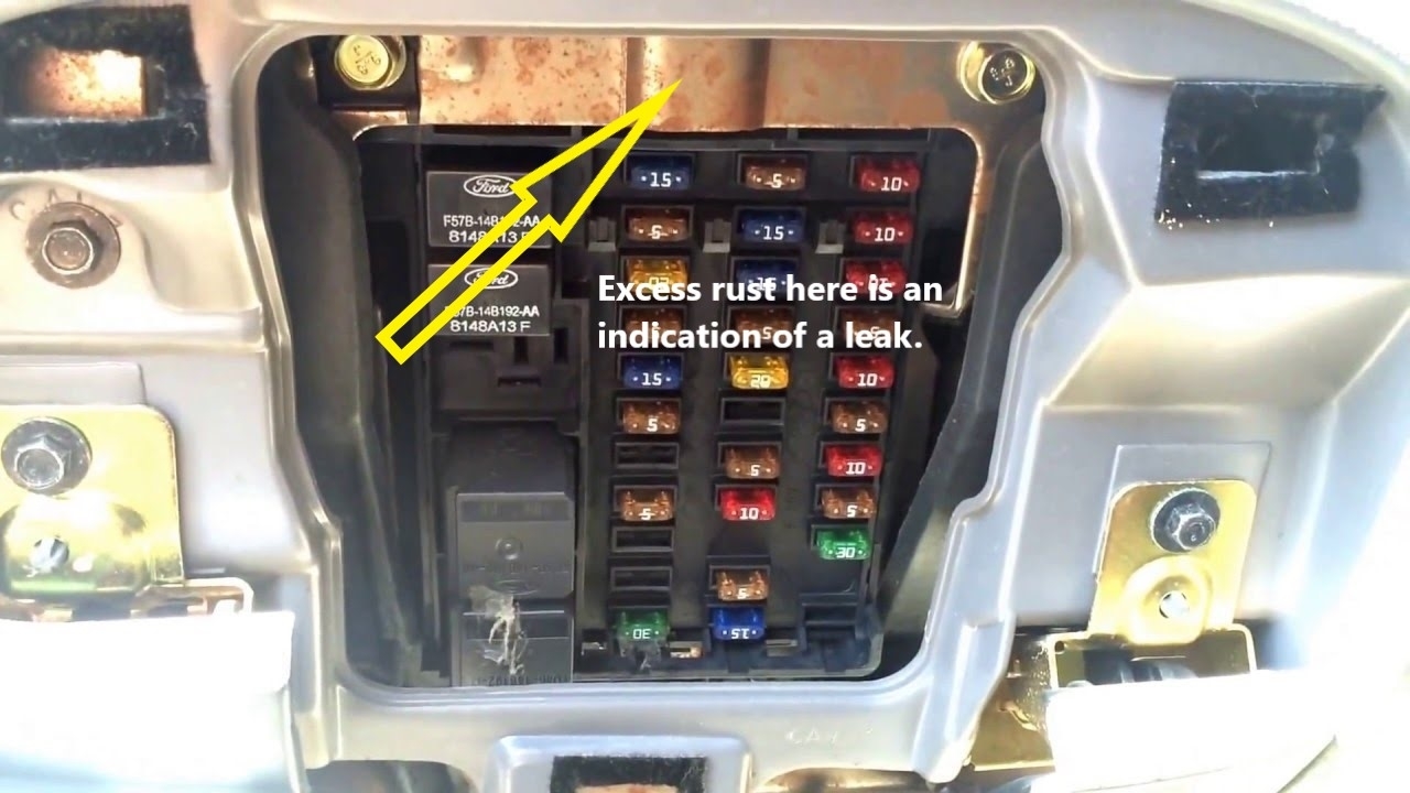

On these trucks the windshields leak water onto the interior fuse box on the driver's side and also can ruin the gem module that is bolted to the back of it. Have a peek under the dash and look for excessive rust and of course water drippage.
