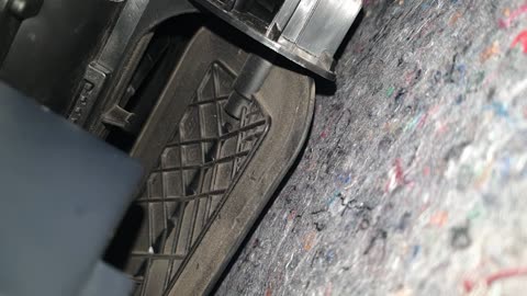

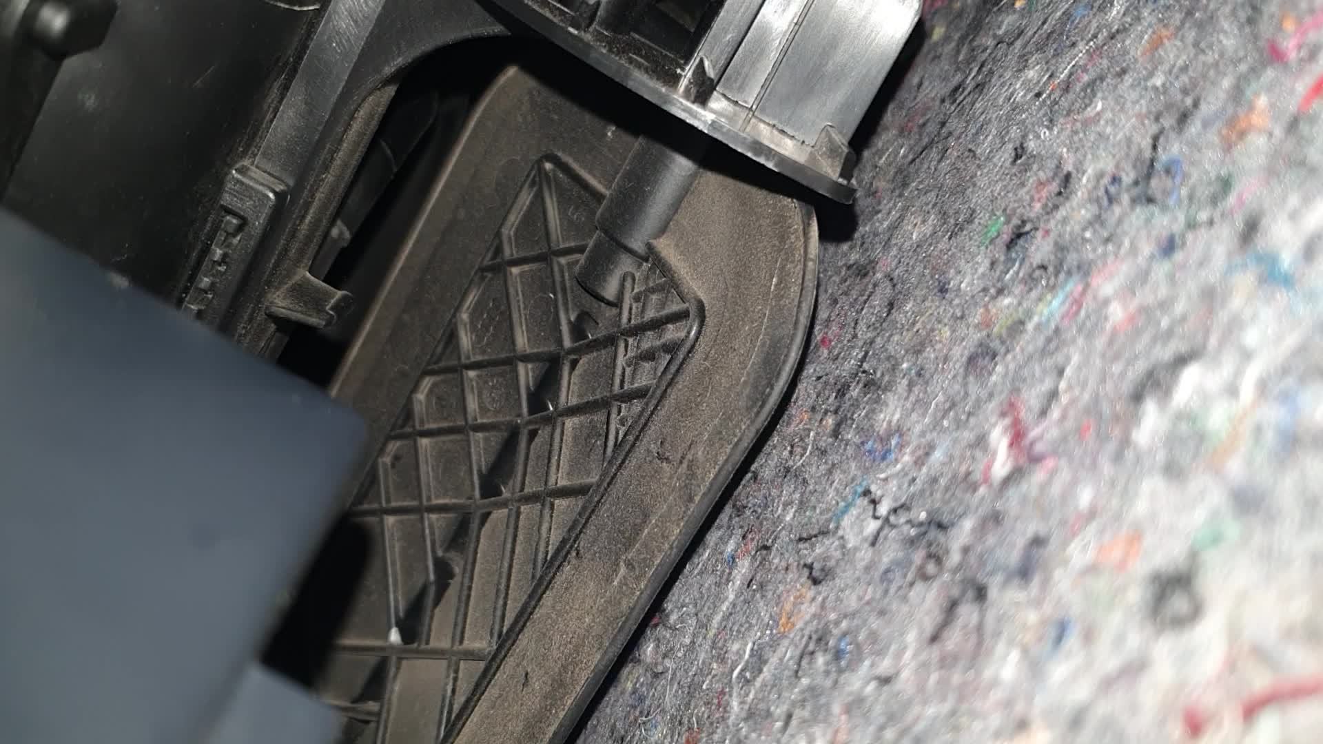

Clicking behind glove box in foot well when starting or in reverse
2013 SEAT IBIZA
52,000 MILES
CONNOR LOVATT
  • 5 POSTS
Something to do with air recirculation the video may help more? It's almost like it can't seal properly. Any help would be appreciated on how to fix.

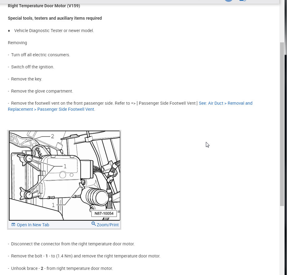

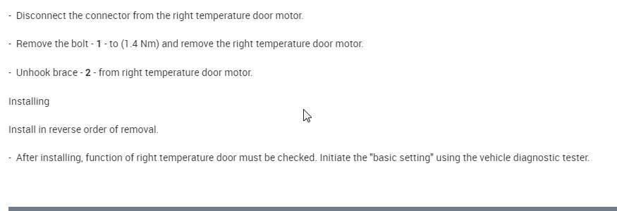

That is the actuator clicking. This is pretty normal for these when they fail. Basically the computer stops the actuator when it sees the resistance in the circuit go up due to it reaching the stopping point. When they plastic gears inside the actuator strip, it never reaches that point of resistance so it just starts clicking like that.
Unfortunately we don't have a manual on your vehicle to give you specifics but here are the instructions on a VW which is very similar.
Let me know if you have questions. Thanks
