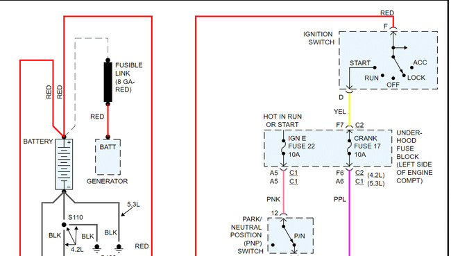

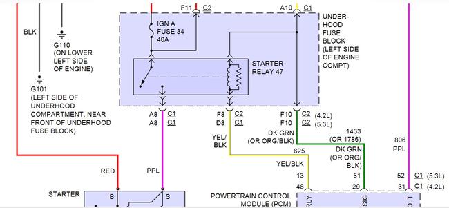

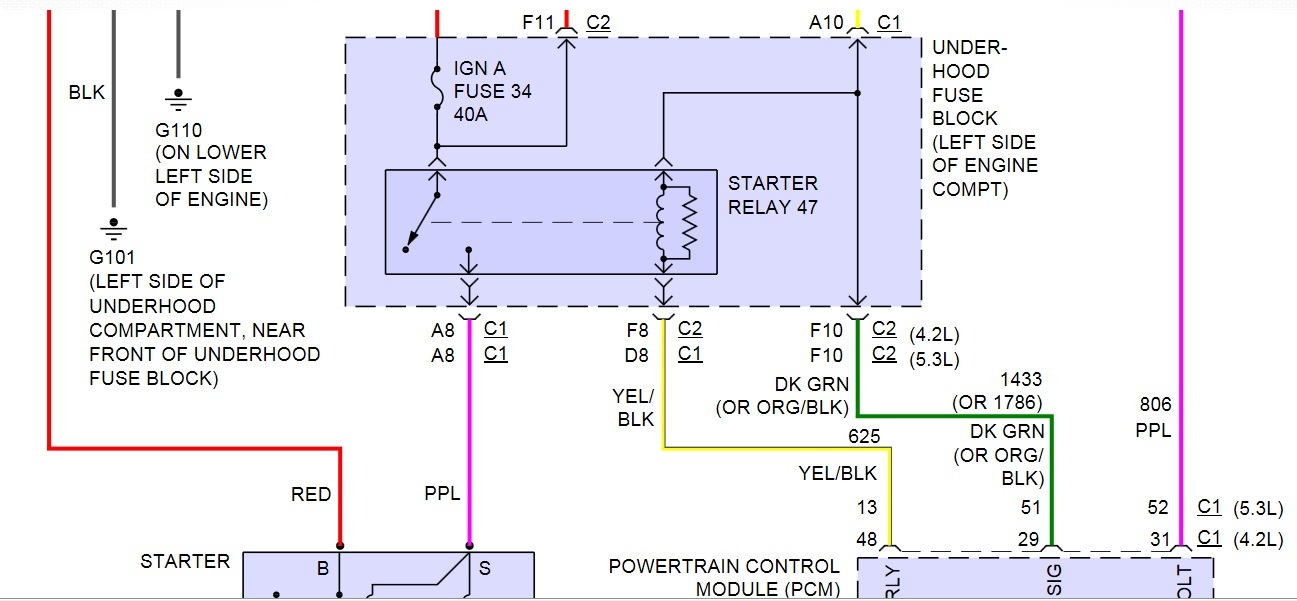

Turn the key to crank clicks one time and there's no start. I have cleaned all the top side connections. I can crank it by jumping the solenoid with a screwdriver.
Mar 6, 2020 at 9:28 AM
  • 110,244 POSTS
If you can jump the solenoid and it starts, then there is a connection issue. Is the smaller wire on the starter clean and tight?
I need you to check something. Have a helper turn the key to the start position while you check for 12v at the smaller wire on the starter. Here is a link that explains how it is done:
I noted that you cleaned all connections on top. Have you done anything at the starter itself? Also, have you tried to see if it starts if it is in neutral?

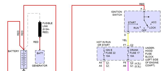

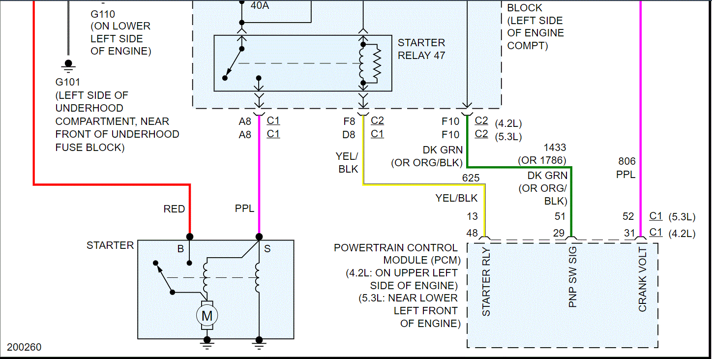

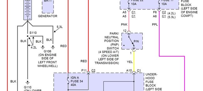

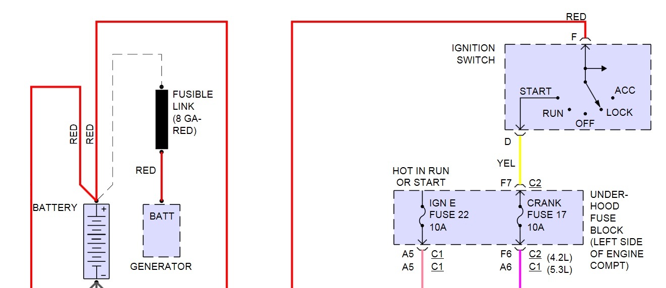

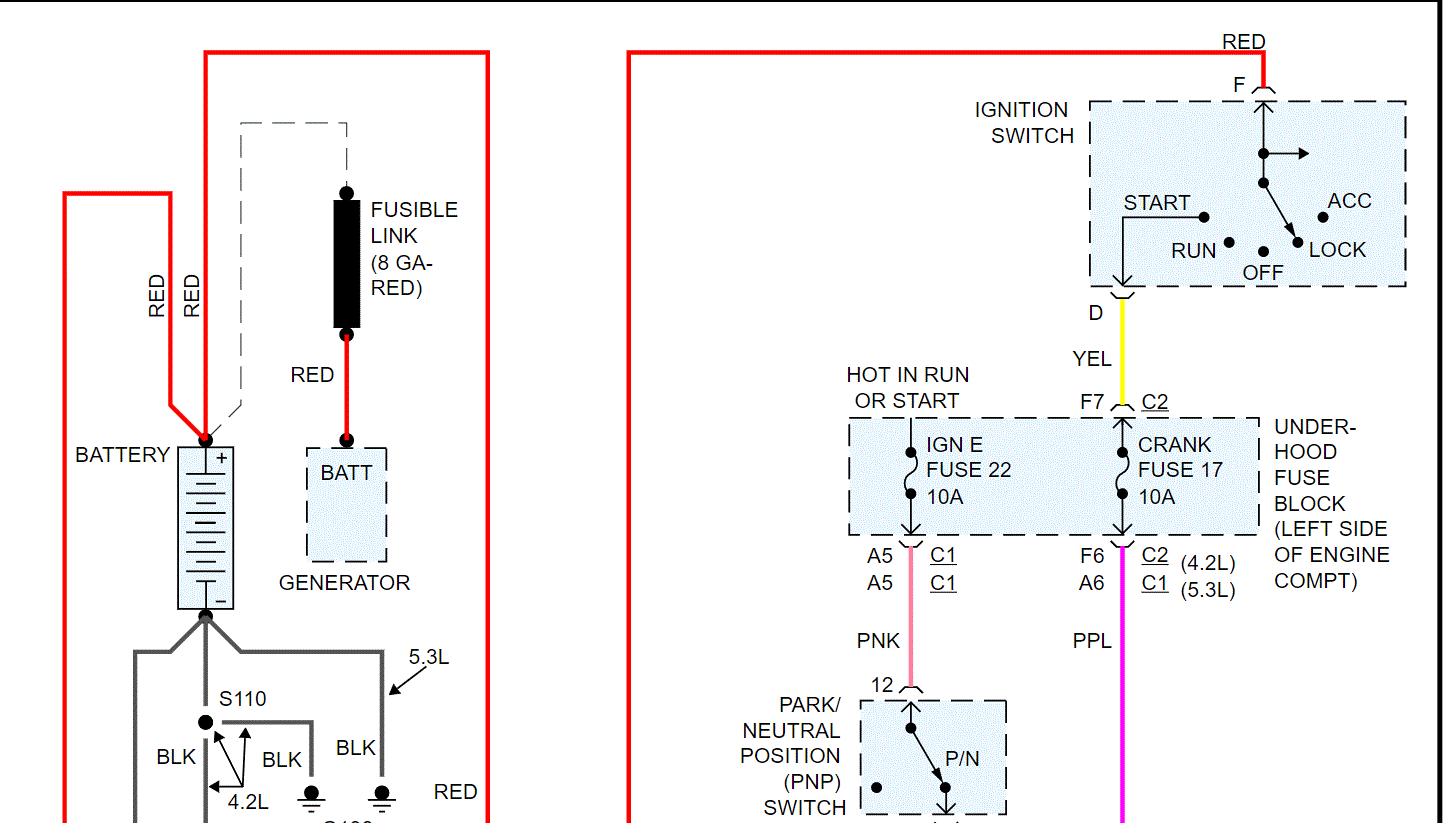

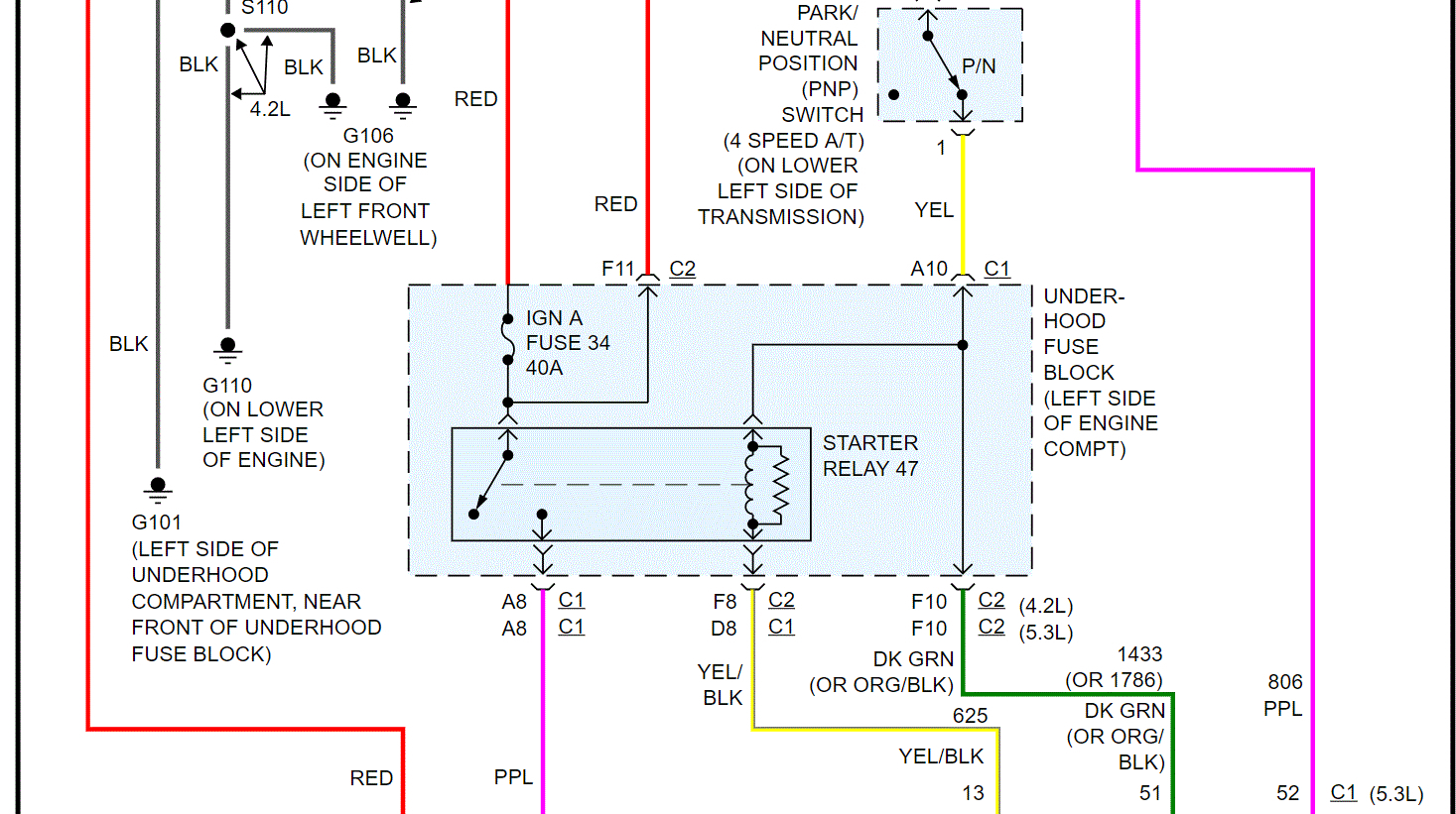

I attached three pics below that are the entire starting system schematic. I overlapped them so you can follow them. Make sure to check the fuses indicated in the pics as well as the relay.
Here are a few links to help when checking:
and
and

If no security lamp on the dash lite when you try to start, if starter motor won't crank, have to check circuits at starter motor. Be sure battery has a full charge and battery connections, good.
To check fuses, you check the fuse isn't blown, also check for voltage on the fuse circuit. The purple wire at the starter, should be hot with key in the crank position and starter relay energized. Any starter testing on the vehicle, make sure tranny is in park or neutral and the parking brake is set. The red wire at starter is battery voltage, hot all the time.
