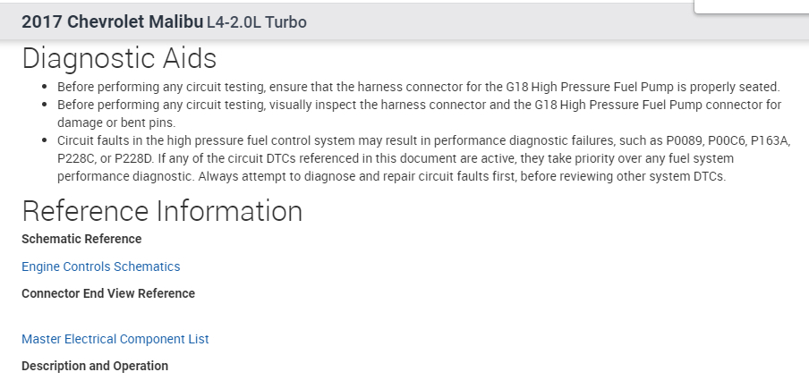

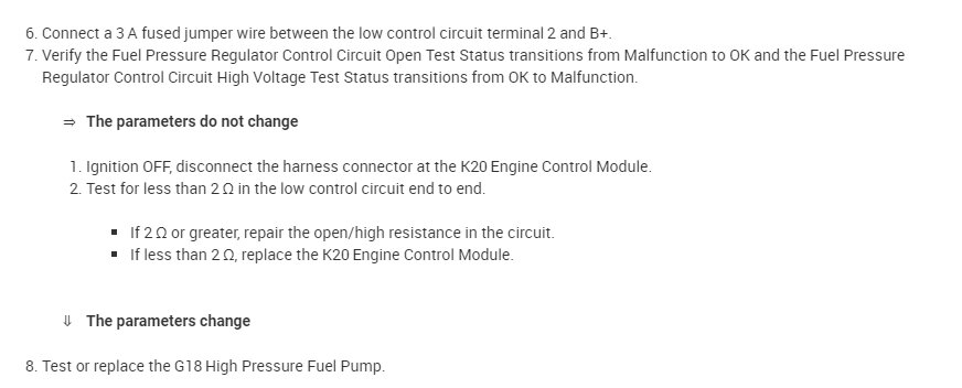

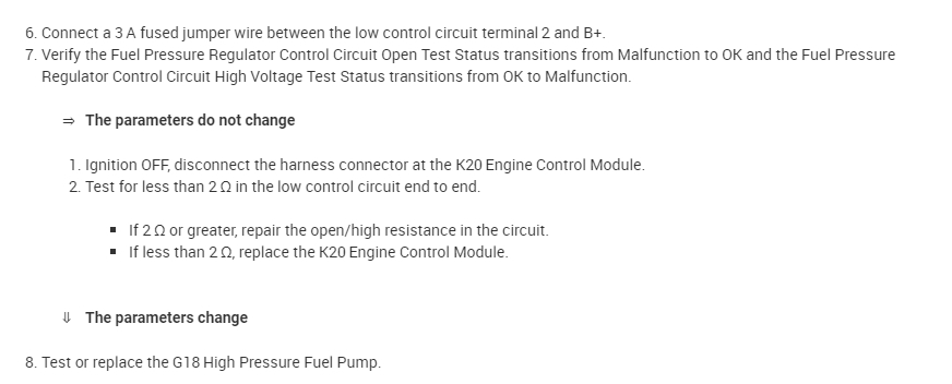

I had a code p00CA. so, I replaced the fuel rail fuel pressure sensor, when I went to start the car it would just keep turning over so I pushed the button to stop it and then I waited a couple minutes and then pushed the start button again and it did absolutely nothing so I took the sensor back out and found that it didn’t match the one I originally took out so I got what I believe is the right one and installed it but I still get no response when I push the start button, dash lights and everything else comes on as usual and still get reduced power display along with the check engine light, I’ve checked battery and went through ground wires and mostly all the wire connectors, fuses , I’m a little frustrated.
Aug 24, 2023 at 2:45 PM
  • 110,241 POSTS

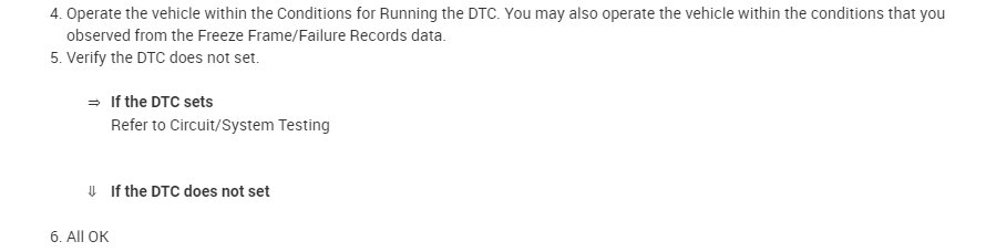

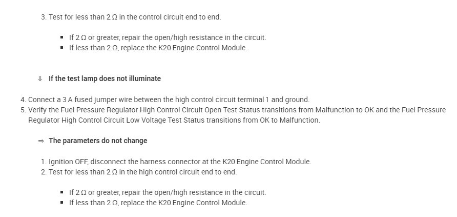

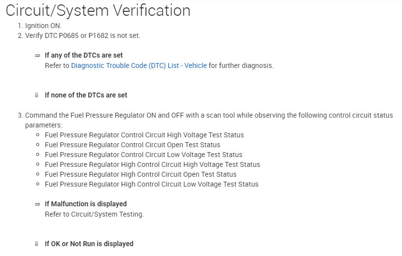

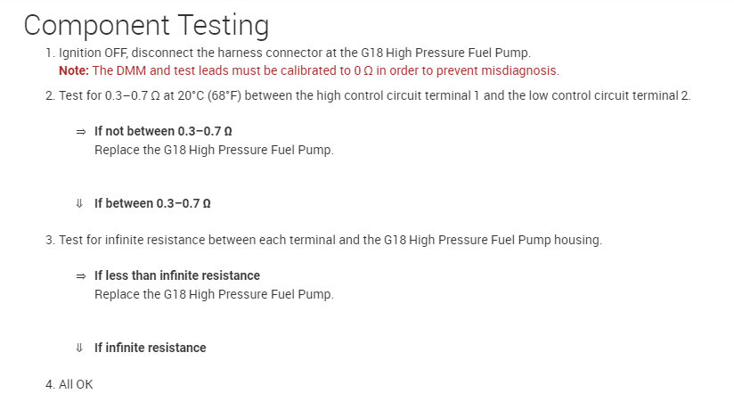

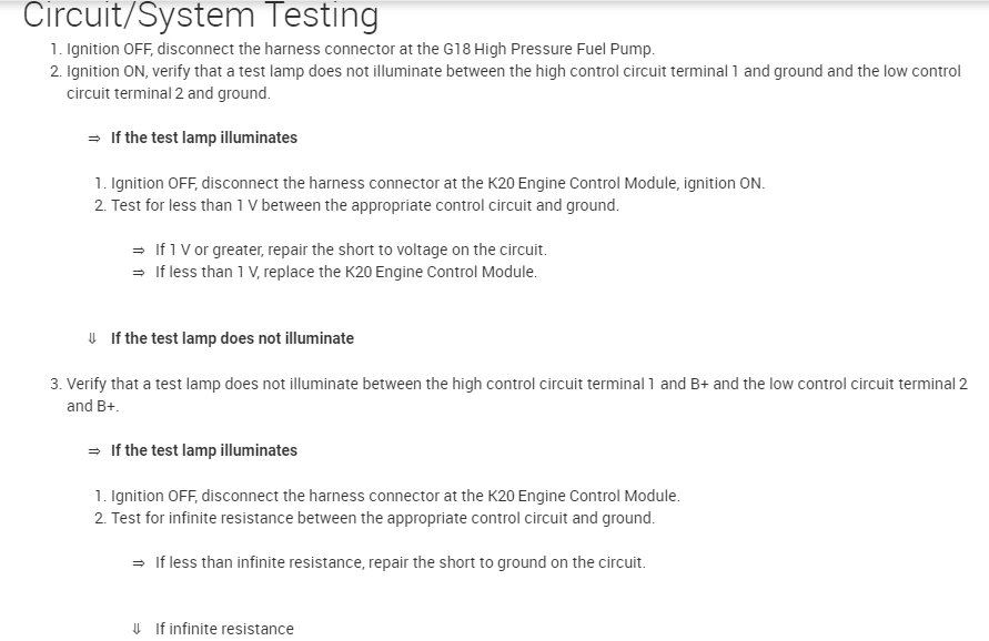

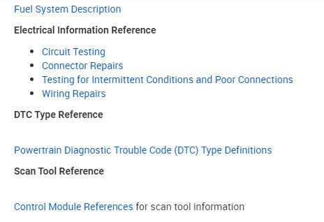

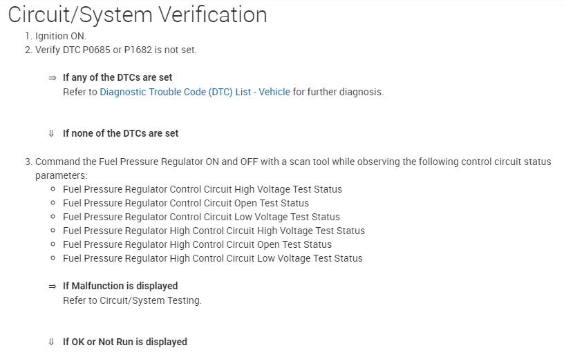

The code, P00CA, indicates the ECM detects a short to voltage in the high-pressure fuel pump actuator high control circuit.
The cause could be a wiring issue, connector, or it could be related to the high-pressure fuel pump.
I attached diagnostics below. Take a look through them and let me know if you are comfortable performing them.
