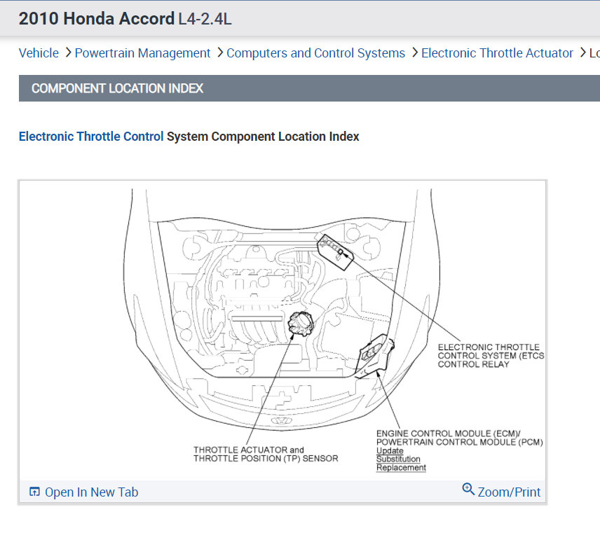

Hi, is there a way to clean the throttle body without having to reset the computer to do the idle relearn. Honda want's an hour of labor and my scanner is not capable of this function. If i understand correctly. It is the TPS % value that is being reset. I read posts of nightmares after cleaning with the idle. I know not to push the motor open manually or while hooked up electrically . Please help me understand and do what is the correct thing to do. Thanks, Neil
Jan 16, 2021 at 8:43 AM
  • 55,399 POSTS
Yep, just leave the throttle body wiring connected and don't move the butterfly. this guide will help walk you through with diagrams below to show you how on your car:

Here is a guide to hep you clean the throttle body and the instructions on the ECU relearn below.
ECM/PCM Idle Learn Procedure
The idle learn procedure must be done so the ECM/PCM can learn the engine idle characteristics.
Do the idle learn procedure whenever you do any of these actions:
- Replace ECM/PCM.
- Reset ECM/PCM.
- Update ECM/PCM.
- Replace or clean the throttle body.
- Disassemble the engine or the transmission.
NOTE: Erasing DTCs with the HDS does not require you to do the idle learn procedure.
Procedure
1. Make sure all electrical items (A/C, audio, lights, etc.) are off.
2. Reset the ECM/PCM with the HDS.
3. Turn the ignition switch to ON (II), and wait 2 seconds.
4. Start the engine. Hold the engine speed at 3,000 rpm without load (A/T in P or N, M/T in neutral) until the radiator fan comes on, or until the engine coolant temperature reaches 194 °F (90 °C).
5. Let the engine idle for about 5 minutes with the throttle fully closed.
NOTE: If the radiator fan comes on, do not include its running time in the 5 minutes.
