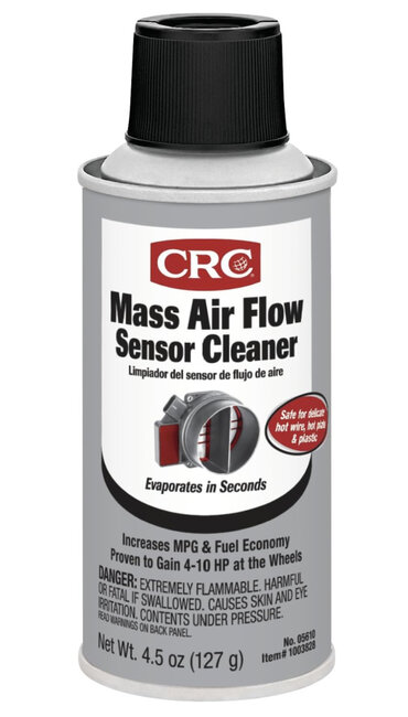

It is possible if cleaner got on the Mass Air Flow Senor or MAF. You can try cleaning it with a special cleaner. I will add an image for you.
Unplug it and remove it from the vehicle.
Only handle it by the plastic connector part.
Follow instruictions on can. It evaporates pretty quickly but let it dry a couple hours to be safe.
Re-install and plug back in.
See if the car starts.
Here is a link to some cleaner:
https://www.amazon.com/CRC-05610-Mass-Sensor-Cleaner/dp/B00BPMCJKQ/ref=asc_df_B00BPMCJKQ?tag=bingshoppinga-20&linkCode=df0&hvadid=80470559180673&hvnetw=o&hvqmt=e&hvbmt=be&hvdev=c&hvlocint=&hvlocphy=&hvtargid=pla-4584070147491965&psc=1
This is a good brand, I use it myself. Your local auto parts store should have some as well.
