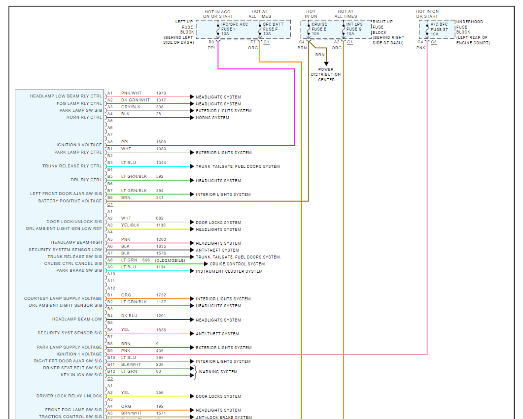

My car has been acting weird lately. All my gauges start jumping around and my stereo stops working. It would just die then hard to start. Anyways I checked the BCM, and it had water damage on the connectors. They were green. So, I cleaned them off with electric cleaner plugged it back up and now it won start. Security light comes on but it's not flashing, I hear the fuel pump come in just no crank. I ordered a new BCM, it just needs new connectors. Could it be a security issue? Pass lock? The dome inside lights won't come on or stereo either. But the security light isn't flashing, it's just on.

Security will not be an issue if the light is not flashing but a bad BCM can cause the not start issue and the gauges jumping around, if the engine is cranking over strong the battery is okay. I have also seen a bad alternator cause this issue as well due to throwing AC voltage.
This guide can help see if that is the problem once the engine is running:
I would run the codes to see if any are stored which will help us see what's going on.

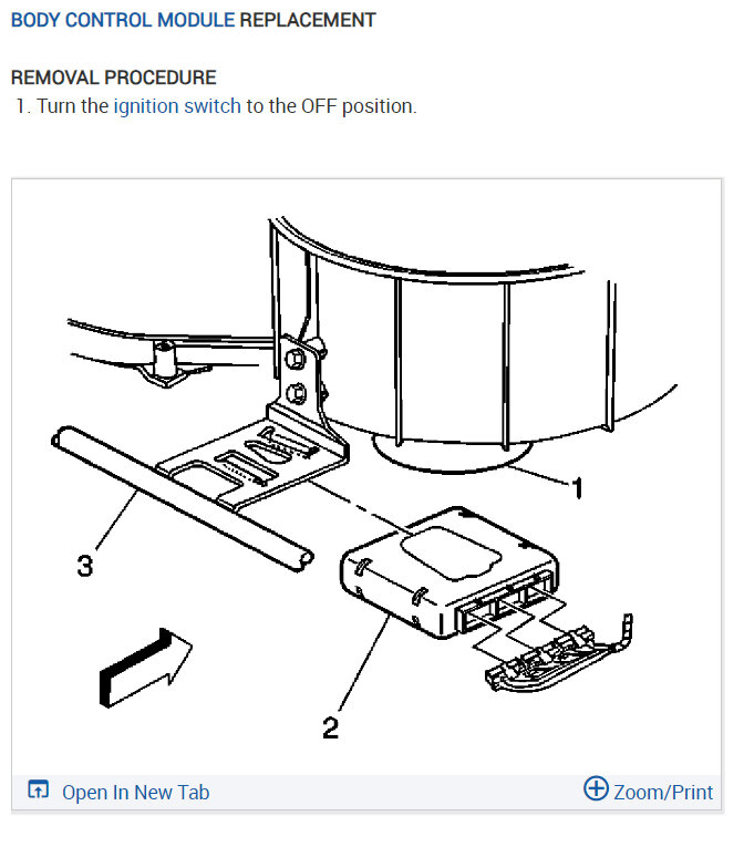

Here is how to change out the BCM correctly. You can order a preprogrammed unit by searching eBay or Google. Check out the images (below). Please upload pictures or videos in your response to the problem so we can see what's going on.

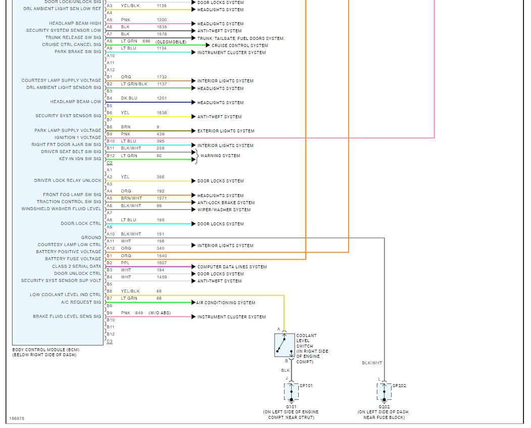

I already ordered a brand new one and it says its plug and play no flash required so hopefully that's the case, but I got the three pigtail connectors today and noticed when I cut my old ones off that there are multiple wires with the same colors on each connector. I really need a pin out diagram of the BCM and connectors to help me figure out what goes where. I don't know how I'm going to figure out which pink or light blue wire goes where since there's double on each connector.

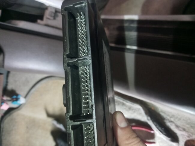

Also, when I had my other BCM connected it threw u1000 code class 2 serial and a theft deterrent code. Plus, one of the pins on the BCM broke off and is stuck inside the old connector, I'm guessing because it was so corroded.

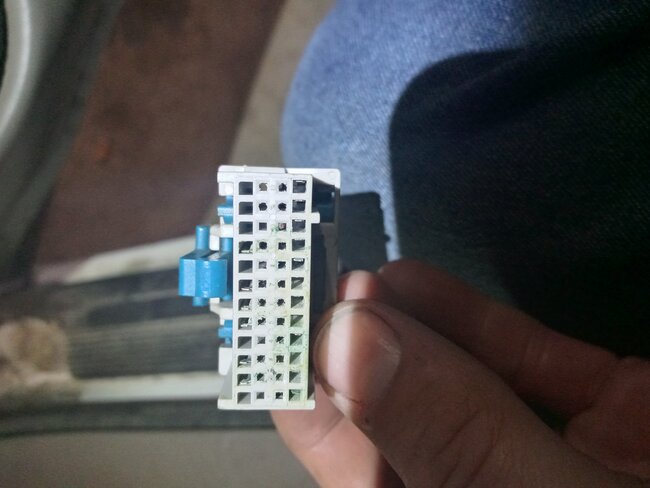

This is the old middle connector with the pin still stuck inside it. I was going to try to pull it out and solder it back on the BCM but just decided to buy a new one. Guess I'll find out if Rockauto was truthful about the new one being plug n play unless when I plug my old BCM back up with new connectors and it works.

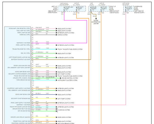

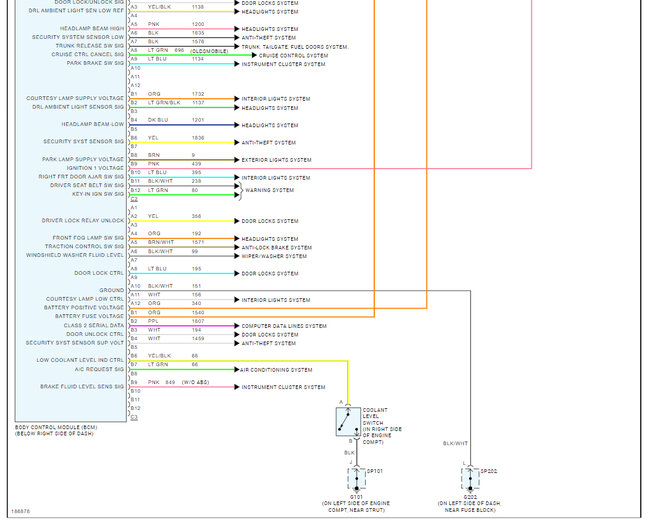

Here are the BCM wiring diagrams and a guide to help you check the wiring:
Mar 25, 2024 at 1:55 AM

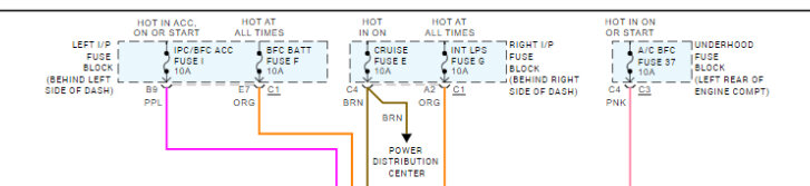

Mar 25, 2024 at 6:08 AM
  • 55,395 POSTS
Maybe, I would turn the key on and check for power at these fuses, here is a guide to help:
You should have power at all of them. Check out the images (below). Let us know how it goes.
Mar 26, 2024 at 2:19 AM

I need the wire pin out of the BCM. I have the new bcm hooked up but my security light is on and i have codes coming up. Airbags and theft deterrent.
Mar 31, 2024 at 1:47 PM
  • 55,395 POSTS
They are not giving the BCM pinouts on Alldata. You are going to have to use the BCM wiring diagrams above.
