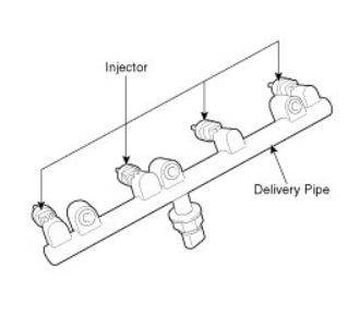

After 225,000 kilometers I want to clean the injectors, so I have to disassemble and reassemble them. Can you explain the correct procedure step by step and what tools do I need to carry out this operation?
Thank you very much.
Alessandro.
Sep 23, 2024 at 5:02 AM
  • 55,433 POSTS

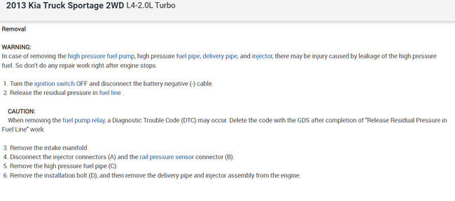

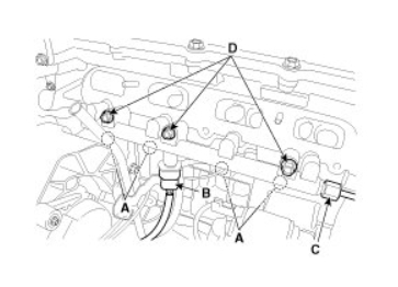

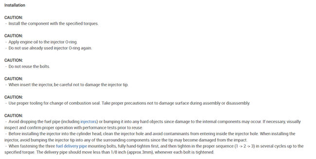

They make a cleaning kit that you attach to the fuel injector too. This one works great for $40.00:
https://amzn.to/3ZC4Kl2
Just remove the fuel injectors and attach the kit with air pressure. Check out the images (below). Let us know if you need anything else.
