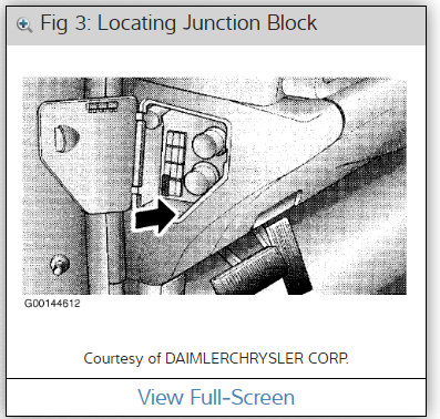

All of the instrument cluster gauges stopped working?
1996 DODGE RAM
20,000 MILES • 5.9L • V8 • 4WD • AUTOMATIC
BIGJIMSAXEN
All my fuses are good. Also, my wipers are not working too.
Sep 26, 2022 at 1:21 PM
  • 55,224 POSTS

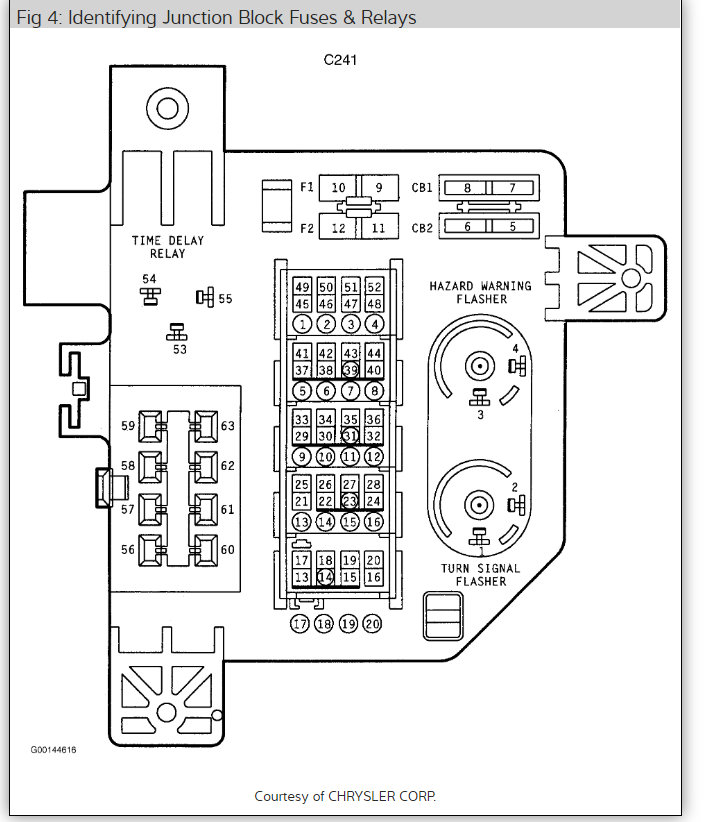

We need to check for power at fuse #8 and fuse #12 in the fuse panel on the left side of the dash.
Here is a guide and the fuse locations to help you with the test:
Check out the images (below). Please let us know what you find. We are interested to see what it is.
Sep 27, 2022 at 3:40 AM
BIGJIMSAXEN23
All the fuses are good. Still no cluster or wipers.
