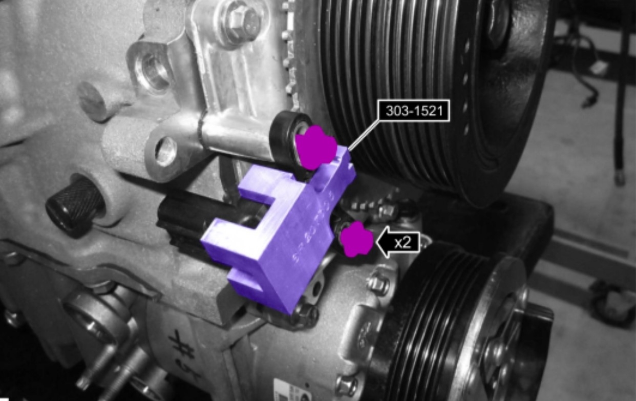

How do I align the ckp sensor
Aug 28, 2025 at 12:17 AM
MECHTRIX
  • 529 POSTS

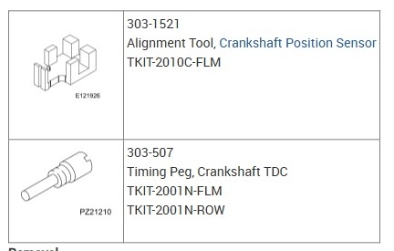

First Theres an alignment tool you need to get for the job
You set the piston at tdc then
Precisely align the sensor to the trigger wheel on the crank shaft in the specified area of the trigger wheel with a Ford special alignment tool (303.1521.) Or equivalent..
Then it needs to be checked and reset with a scan tool to ensure that the timing of the sensor to the trigger wheel is correct
So there's no problems left behind like misfiring or a no start scenario..
So if youre going to atempt to do it make sure you have the special alignment tool first becuase its a extreamly precise alignment procces that you need the tool for
Let us know if youre going to attemp this job well be glad to help
Good luck hope this helps
Aug 28, 2025 at 1:53 AM
STEVE W.
  • 15,349 POSTS

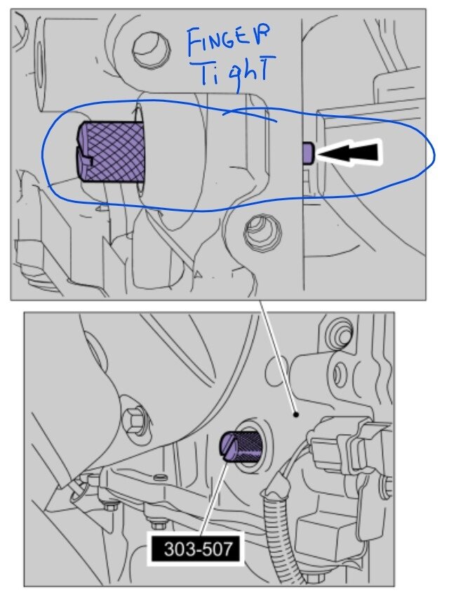

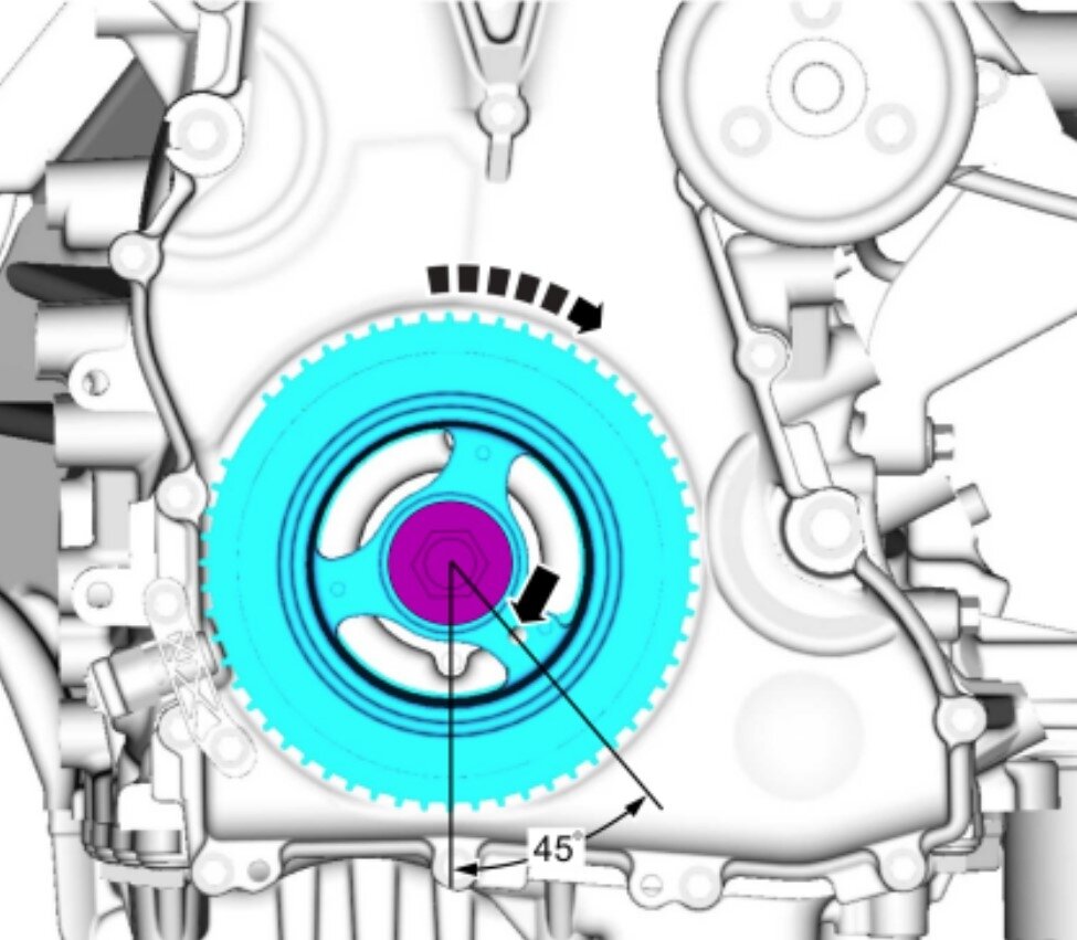

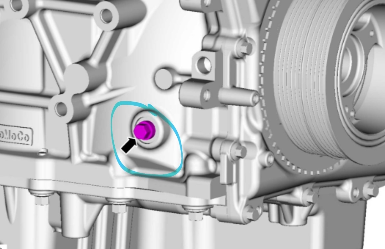

As Mechtrix said you need the correct alignment tools to put the crankshaft in the correct position and then use a different tool to set the CKP. You can usually find them as loaner tools. Then you pull the right front tire and splash shield. Then disconnect the CKP. Now before you go farther you will want to install the small lock pin, for that you remove the bolt on the side of the block and rotate the crankshaft clockwise until the hole in the balancer hub is at 45 degrees from TDC. Now you install the pin finger tight and rotate the crank so it just touches it. Now you can remove the sensor. Next install the new sensor and plug it in. Take the special alignment tool and make sure the sensor lines up with the TDC pin on the reluctor wheel. Move it around until it does. Now tighten the bolts to 62 inch pounds Remove the guide, the timing peg, install the bolt back into the block. Reverse the other steps to put it together. Now use a scan tool to reset the Crank monitor. If you don't have a scan tool you might look at FORScan. They have a windows version that works with a dongle and gives you full control just like the OE tools the dealers use.

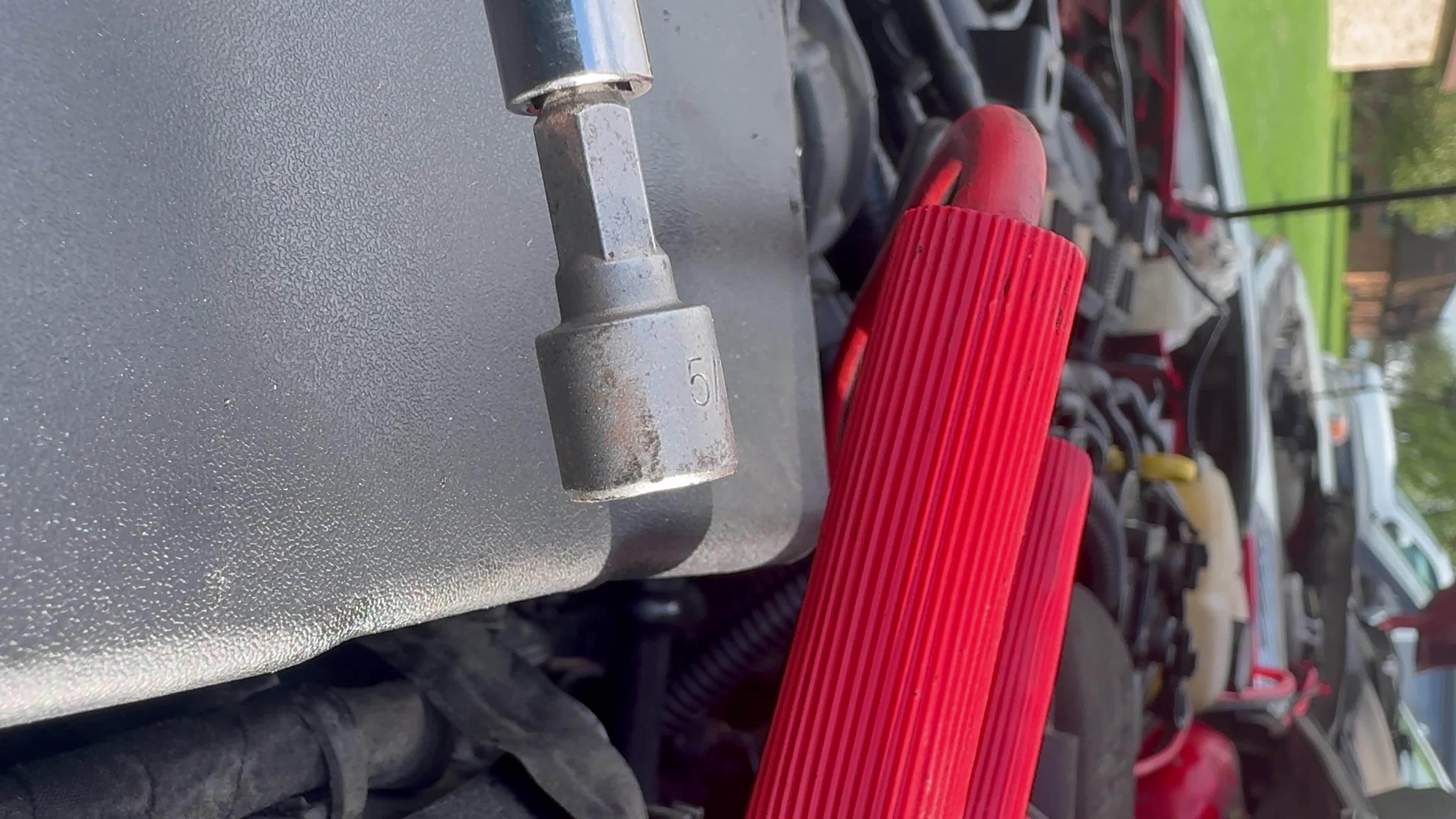

Here is the video of me cranking it over
Aug 30, 2025 at 12:44 AM
STEVE W.
  • 15,349 POSTS
Well cranking sounds OK with no lope or struggle.

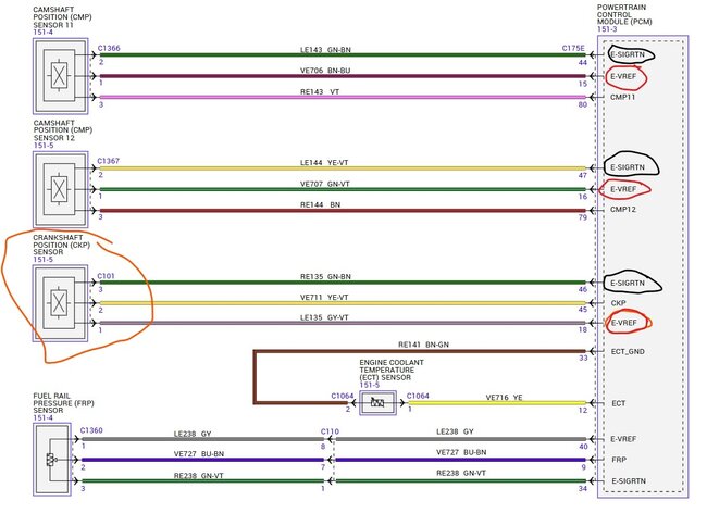

Ok guys I’ve installed new CKP and when cranking it the tac doesn’t move and of course no start. I don’t believe that the tac was moving before I replaced it either so I’m assuming it is a wiring issue any thoughts???

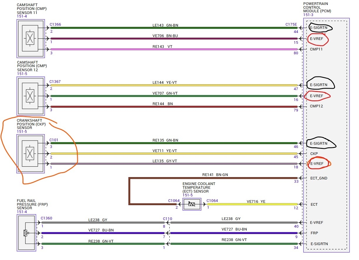

Check both the crankshaft and cam sensors for a good voltage reference and ground. The attached shows the wire colors. You said you did the head gasket, did you use all new timing components as well? What was the reason for the head gasket swap?

Steves right Also the crankshaft position sensor becuase its also a eng speed sensor does both jobs on this car check that too that would be the most likely for what you're experiencing

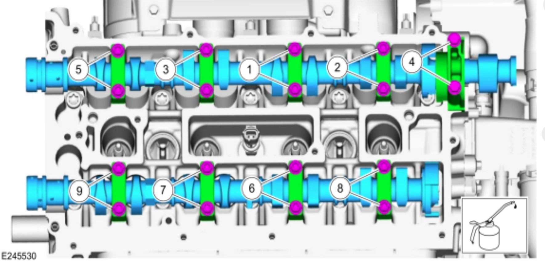

Does anyone have the tightening sequence for the cam caps I can’t find them anywhere
Sep 12, 2025 at 4:50 AM
STEVE W.
  • 15,349 POSTS
Look close at the parts you used, see if they were marked correctly. Also check the caps to be sure they are correct. Torque is a 2 step process, Lubricate the camshaft journals with engine oil, then you tighten them in steps. 2 turns on each bolt in sequence. From the center out as shown.
For the first stage you bring them all to 62 inch pounds. Let them set a few minutes, then continue to 142 inch pounds.
