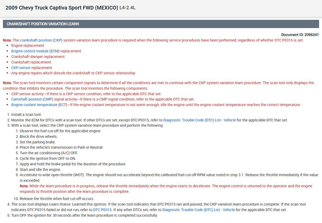

Hi, does a new crankshaft position sensor need to be re-learn to start the engine?
How can i do this?
Apr 18, 2024 at 4:45 AM
AL514
  • 5,668 POSTS

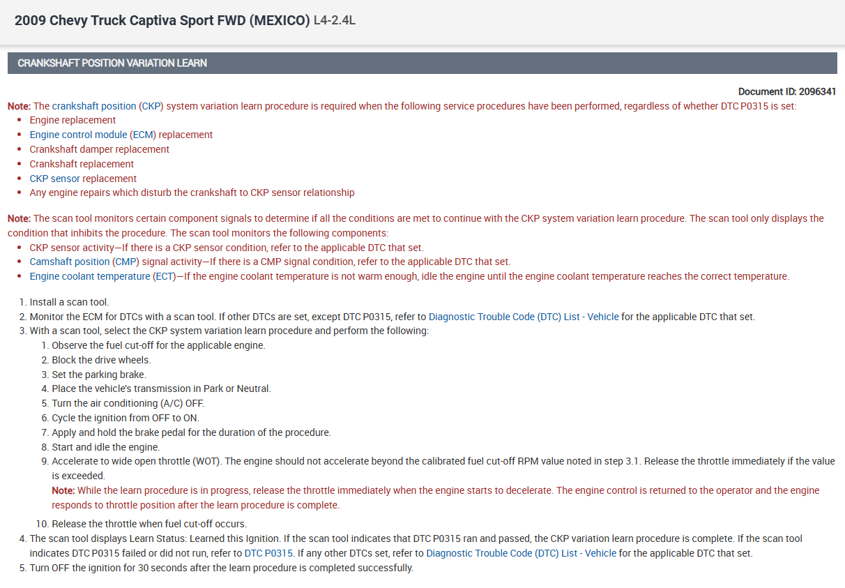

Hello, this is the only Captiva we have listed in All Data here. It's a 2.4 liter non turbo engine, and it shows the instructions for the Crankshaft sensor Variation Learn procedure, take note of the instructions carefully.
