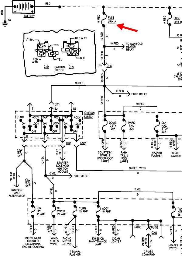

No lights, radio, nothing. New battery and new solenoid. Ground wire to odometer smoked and everything quit working.

After looking at the diagram, it appears you are likely to find everything okay up to this point. If that is the case, the best suspect is fuse link "A" pointed out by my red arrow in the diagram. That feeds the horn, ignition switch, and most of the lights. It is not shown as being inside a fuse box like all the other fuses, so this is most likely going to be a fuse link wire. It's shown as a 14-gauge wire feeding a fatter 10-gauge wire that goes to all the other circuits. That makes the fuse link the weak link in the chain. I can't find a drawing that shows the link's location, but chances are it comes right off the battery's positive cable. Fuse link wires have a dull color that denotes their current rating. They're meant to be a slow-acting fuse. When it burns open, the insulation is designed to not burn or melt. To test one, just tug lightly on it. If it acts like a wire, it's okay. If it's burned open, it will act like a rubber band.
When fuse link wires burn open, the arcing leaves a carbon track behind. That is enough for a tiny tickle of current to get through that a digital voltmeter will pick up and falsely show the full battery voltage of 12.6 volts, but only when no current is trying to flow. By having the head light switch turned on, or any other load, that carbon track is much too restrictive for current to flow through it. That's when you'll find 0 volts further down the line. That's the whole reason for having the light switch turned on during these tests.
A test light also needs current to operate, and when current can't get through the carbon track, the test light will be off while the voltmeter might have shown 12.6 volts. This is why the test light is faster and more accurate. For this to be true, it has to be a standard test light with a light bulb inside it, not one of the new electronic ones.
