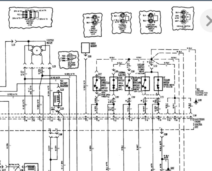

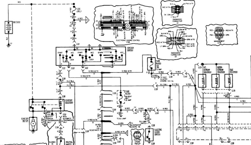

I’ve searched far and wide to find a good diagram of the engine control module but can’t find one. I am installing a painless wiring harness part #: 10150 and it doesn’t talk about connections to the EEC. I just need the wiring diagram so I can figure it all out. I am doing this for my Dad and he doesn’t want to remove it so any help other than the nutter bypass is appreciated!

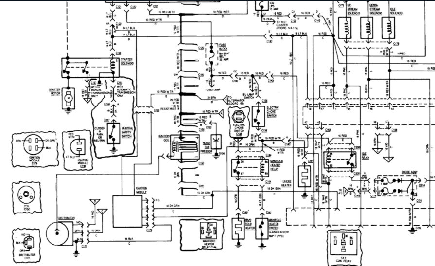

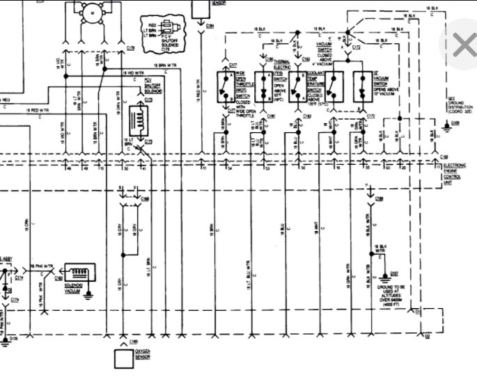

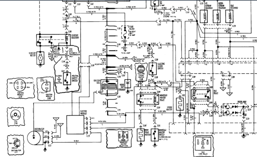

Here is the wiring diagram you requested. I've cut it into 4 pieces so you can view larger. Let me know if you can view. Hope this helps and thanks for using 2CarPros.
