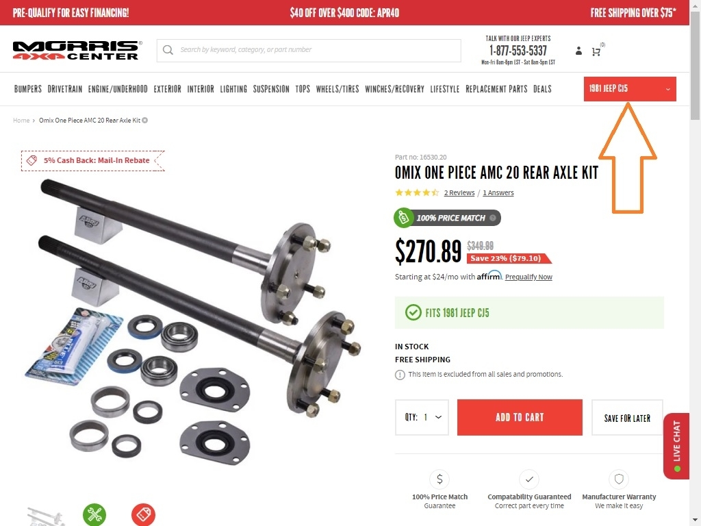

This is what I found while searching for decent pocketbook friendly axles.
They normally are sold in pairs.
https://www.morris4x4center.com/omix-amc-20-rear-axle-kit-16530-20.html?gclid=CjwKCAjw1v_0BRAkEiwALFkj5tOBq_8E7kUsdzrYYVYNMB1IsVFmHWhKYdwWg6kPaD91SwVq31MSCBoCl5gQAvD_BwE
(I screenshot it below)
If you didn't already know, one axle is longer than the other.
The width of the axle housing was narrower 1976-1981(yours),
AMC widened the stance from 1982-1986 (not yours)
