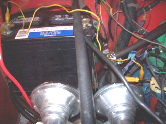

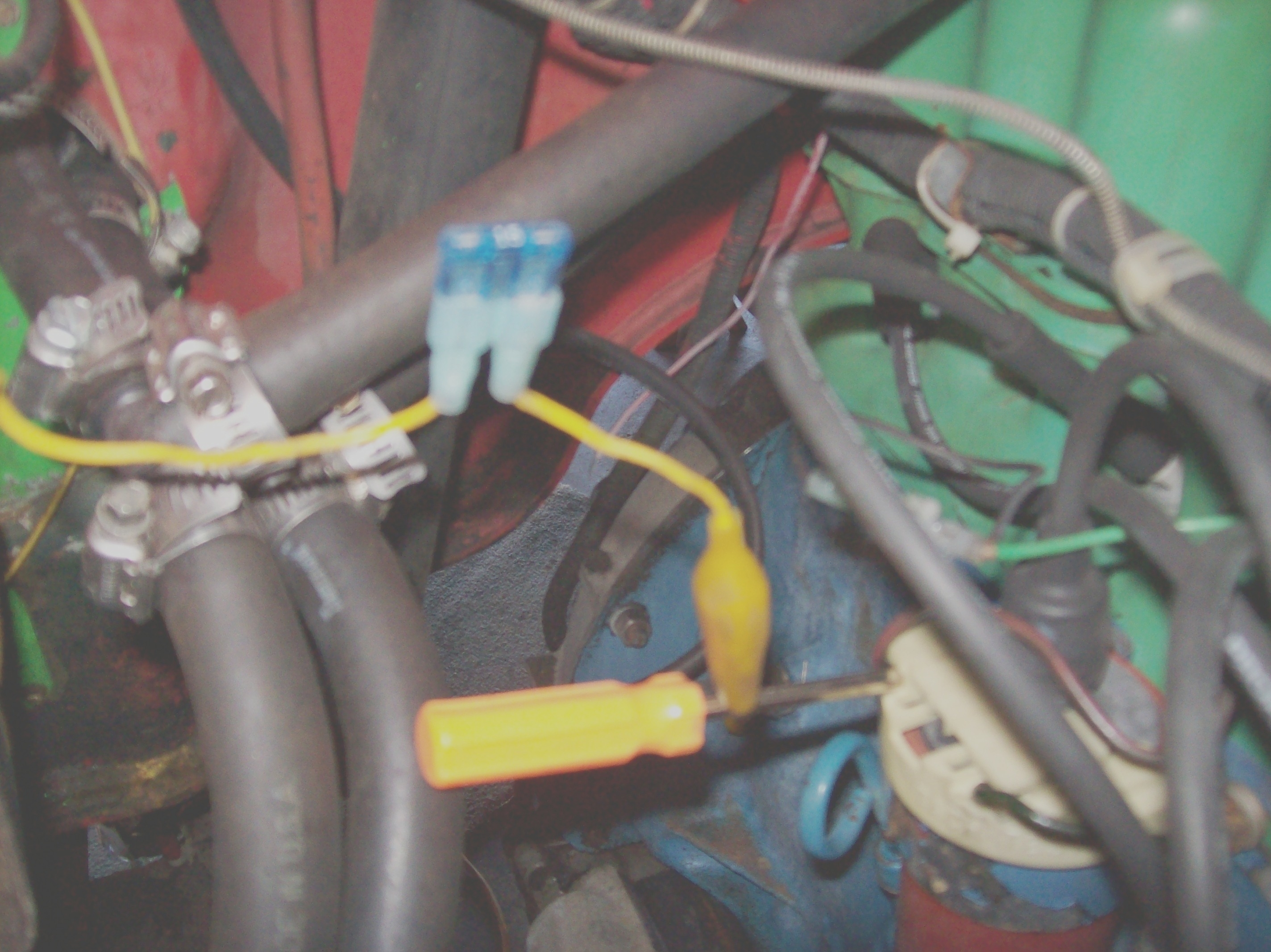

Run this test,
It will maybe clue me in on what you have done to your poor baby!
Jumper wire from the positive side of the battery to the positive side of the coil.
Click on my two pictures below
If it will run, the only way to kill it will be to disconnect the jumper. We have just bypassed the "on" position of the key.
What are your results?

Okay, so the Jeep runs when I connect it like you said. What do I need to do now?

Great!
A couple of possibilities.
Let's weed an easy one out now.
Fire it back up.
While you are hearing that raw power being generated,
Take that jumper loose at the battery.
Does it run or shut off?

It shuts off when I remove the wire.
