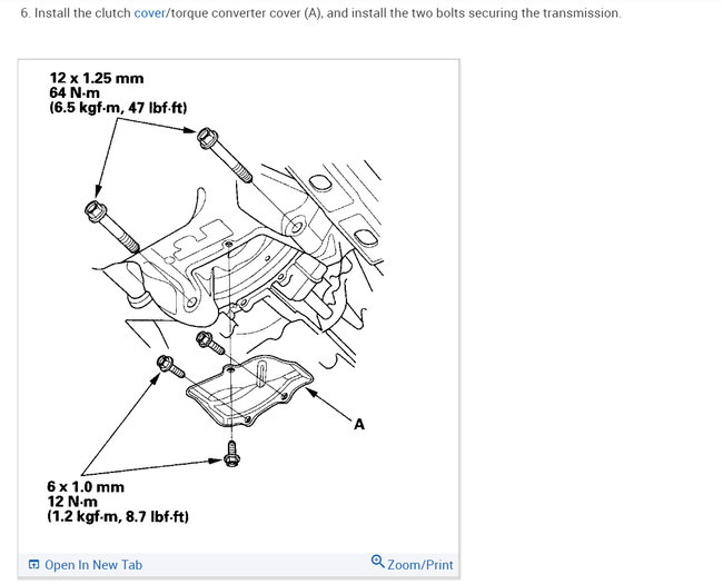

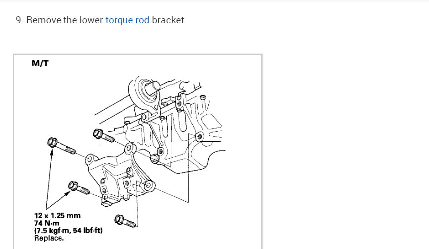

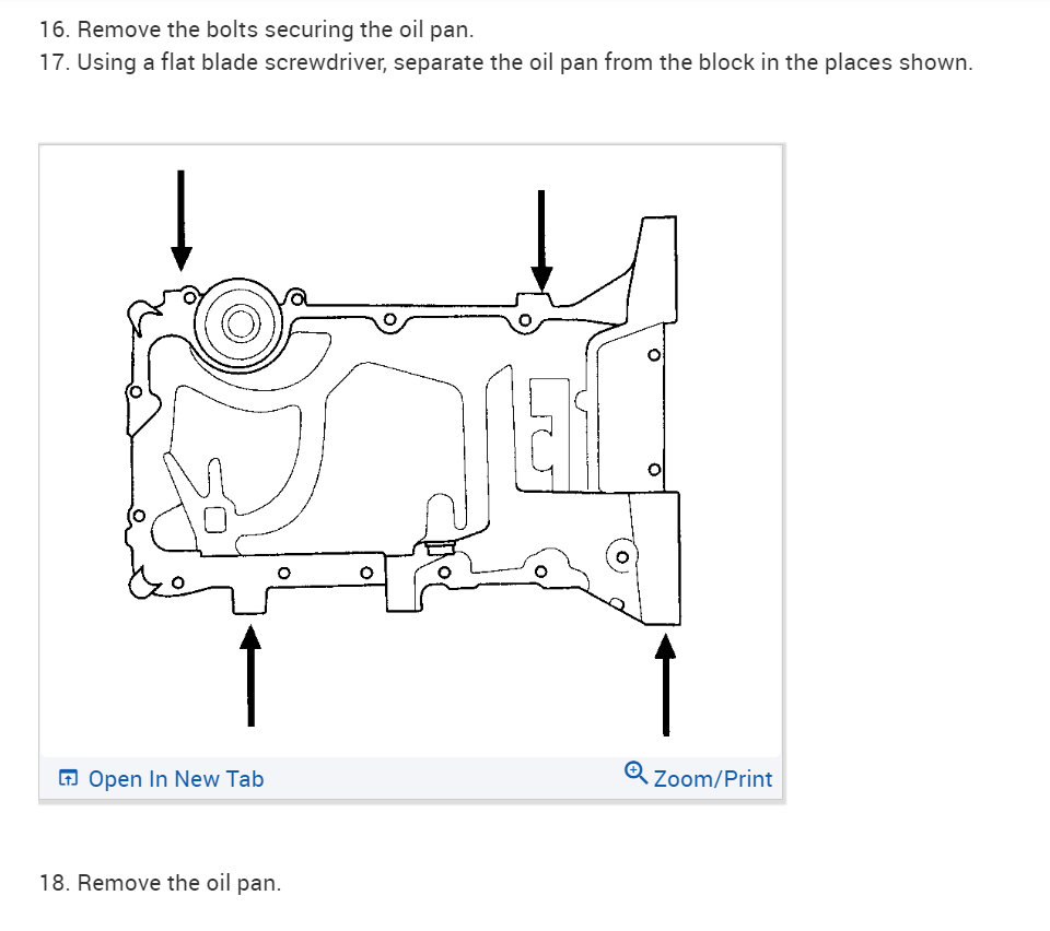

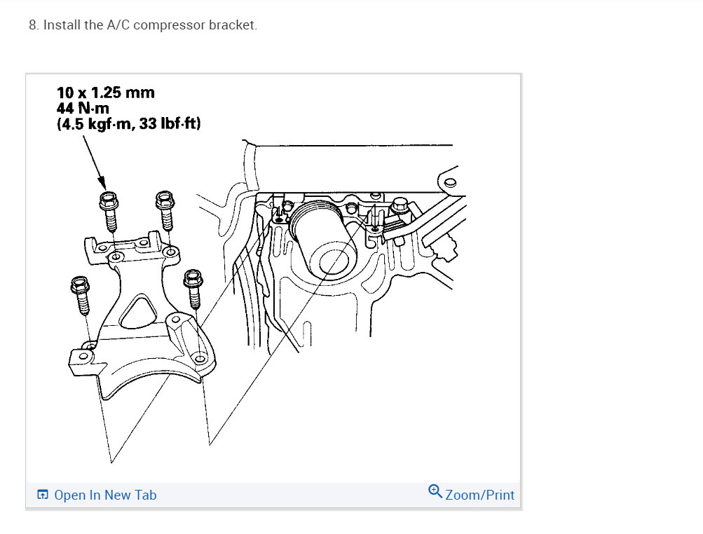

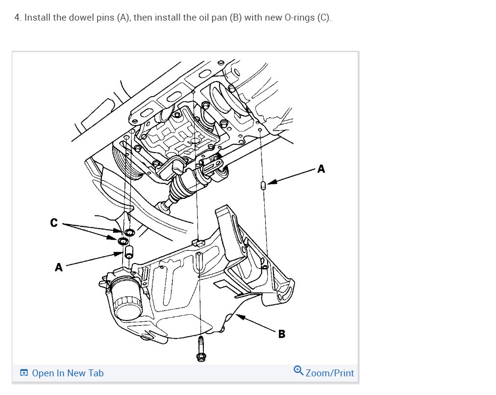

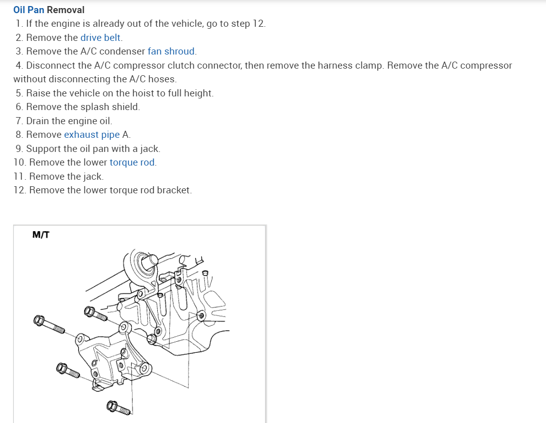

Okay, I'm dropping my oil pan and I'm stumped. Do i have to take the alternator off and exhaust pipe as well as compressor?
The car listed above is an EX-model.
Sep 19, 2022 at 4:45 AM
AL514
  • 5,700 POSTS

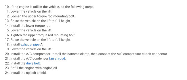

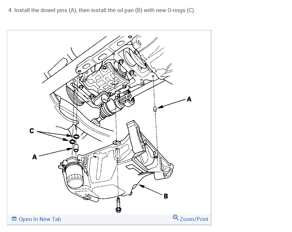

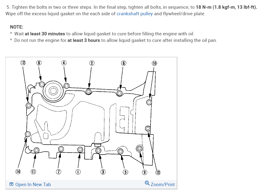

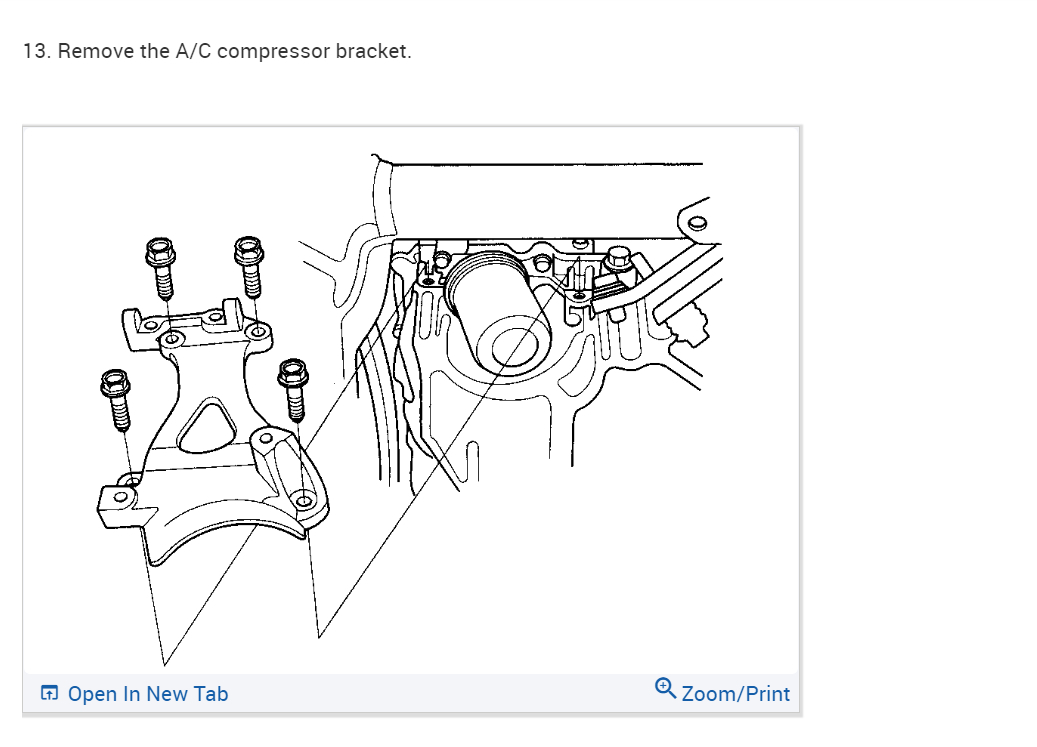

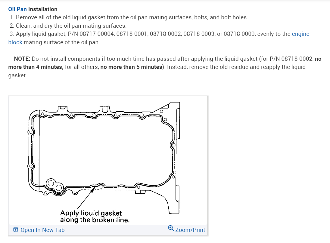

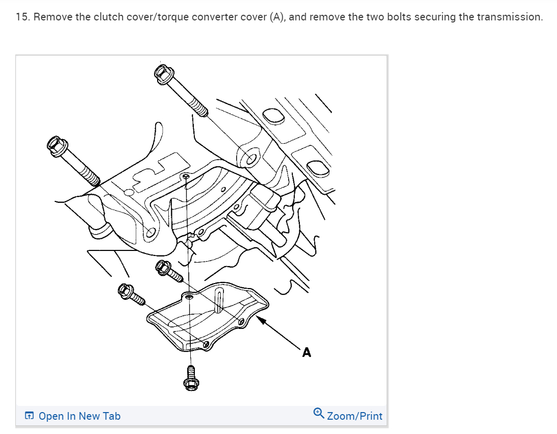

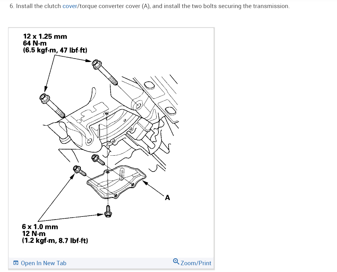

Hello, yes on these the A/C compressor needs to be unbolted but not the hoses. Just the electrical plug for it and move it out of the way. Exhaust pipe A needs to be removed, that's the section in the way. I'll post the instructions for removal and installation. These are difficult ones to do on the ground. The first diagram is steps 1 to 12. Step 14 is not there, as it's for automatic transmission.
Step 9 on the Installation is a mistake, its install not remove, but it does give the correct torque specs.
Sep 19, 2022 at 5:26 AM
