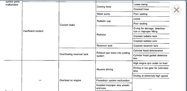

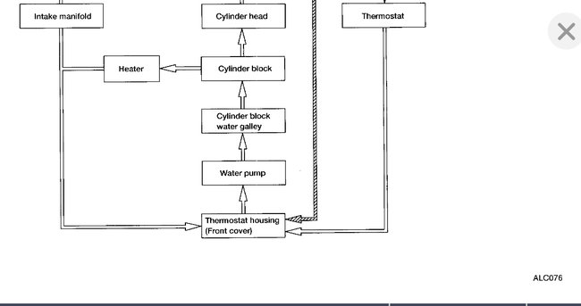

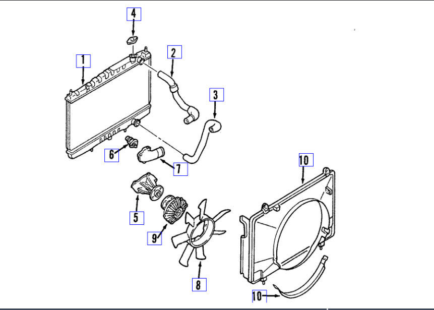

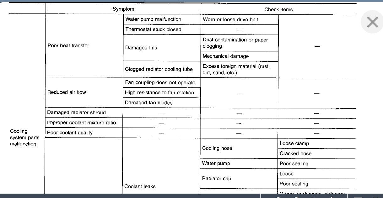

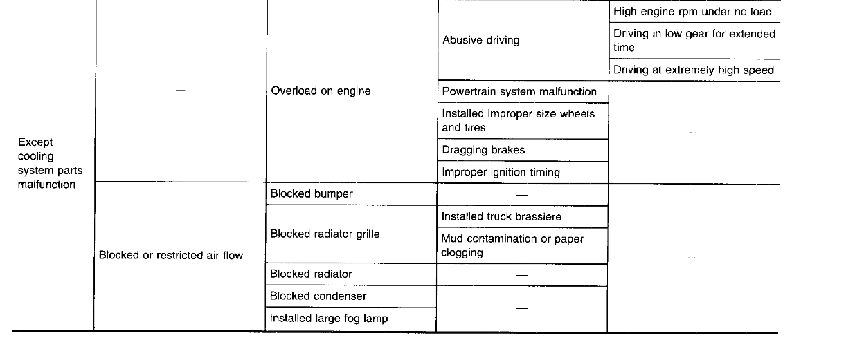

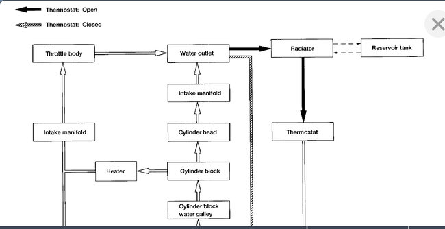

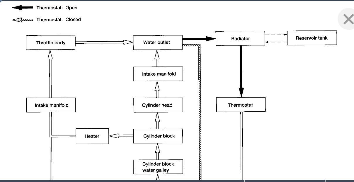

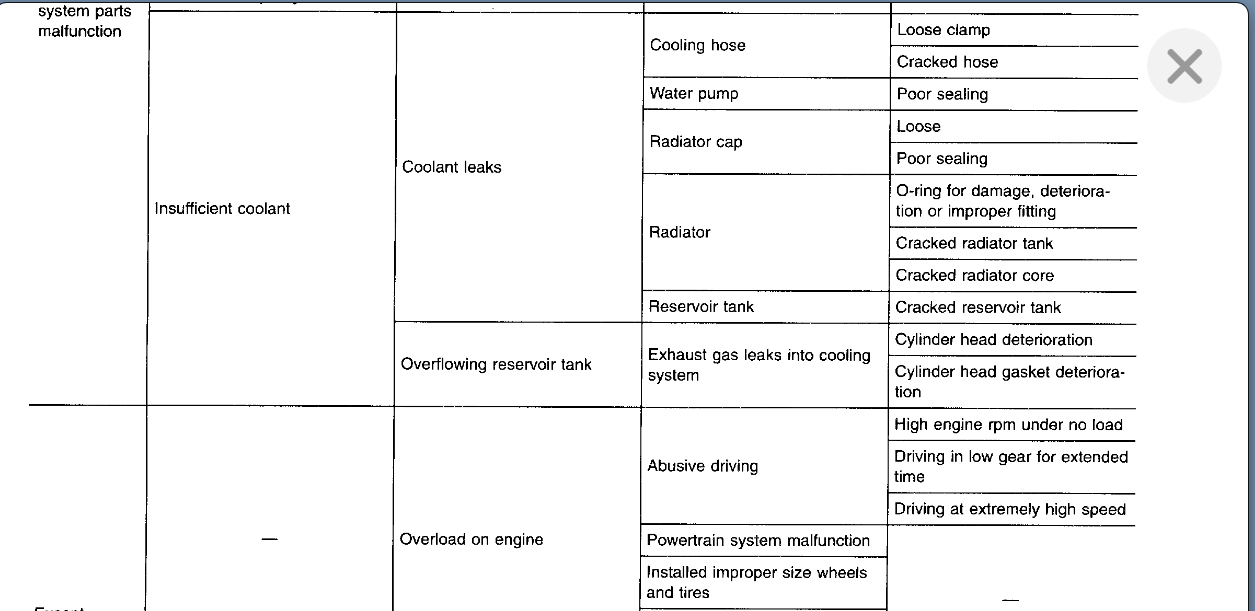

You're right. Cooling systems aren't that complex and are usually easy to figure out. I've double checked to see if there was a Technical Service Bulletin (TSB) or anything out of the ordinary with this cooling system and have nothing special about it. I've included everything that I could find in either of our resources that might be helpful in the diagrams down below. Save that, an air pocket that is impeding coolant flow would be my guess. I hope this information helps.

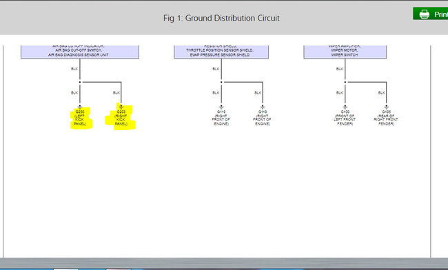

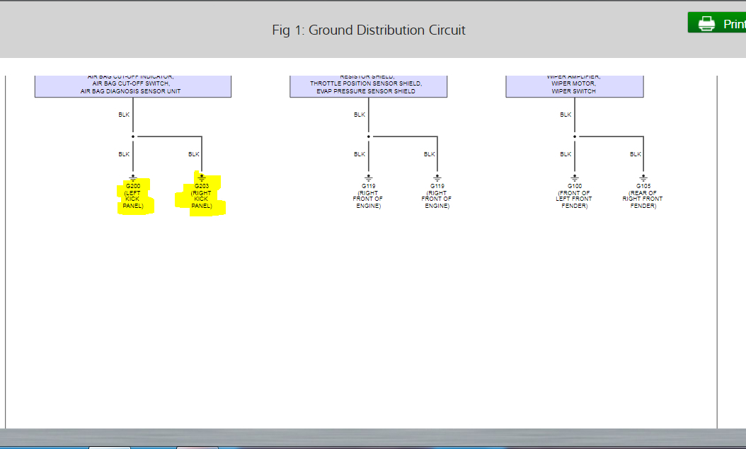

So replaced the radiator flushed the heel out of my system and I think I found my issue. I believe it's my cluster panel. It went crazy I started it and I know I had half a tank of gas but it read at empty, the tachometer was red lined and when I drove it the speedometer wouldn't get over 10 mph. The temperature gauge maxed out, dropped to below operating temperature then back to hot then down to operating temperature then bounced around a bit. Now they're normal again except the temperature gauge. It starts out cold the gradually moves up to behind overt heating. I popped the radiator cap and to my surprise the ease 0 expansion with the fluid so I stick my finger in it and it was Luke warm but the gauge was reading well over 210.
May 7, 2019 at 3:16 PM
THOMAS KNAPP
  • 5 POSTS
Good news is that if anything, I have a new cooling system and a bad cluster panel. Oh and the check engine light came on the transmission's speed sensor, which is another sign, along with the other issues, that the cluster panel went south.
May 7, 2019 at 3:18 PM

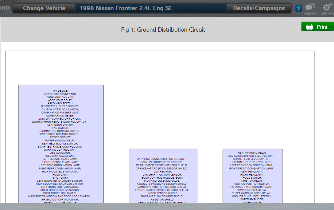

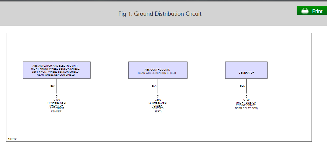

SCGRANTURISMO
  • 4,897 POSTS
Hello again,
Check out ground #200 and #203. They are by the left and right kick panels respectfully. I have included the ground distribution wiring diagram for your vehicle in the diagrams down below.
