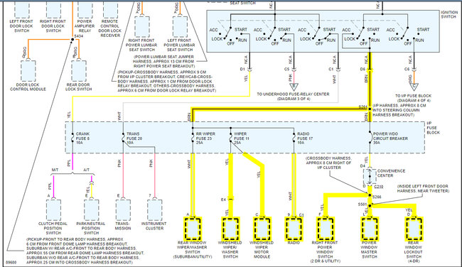

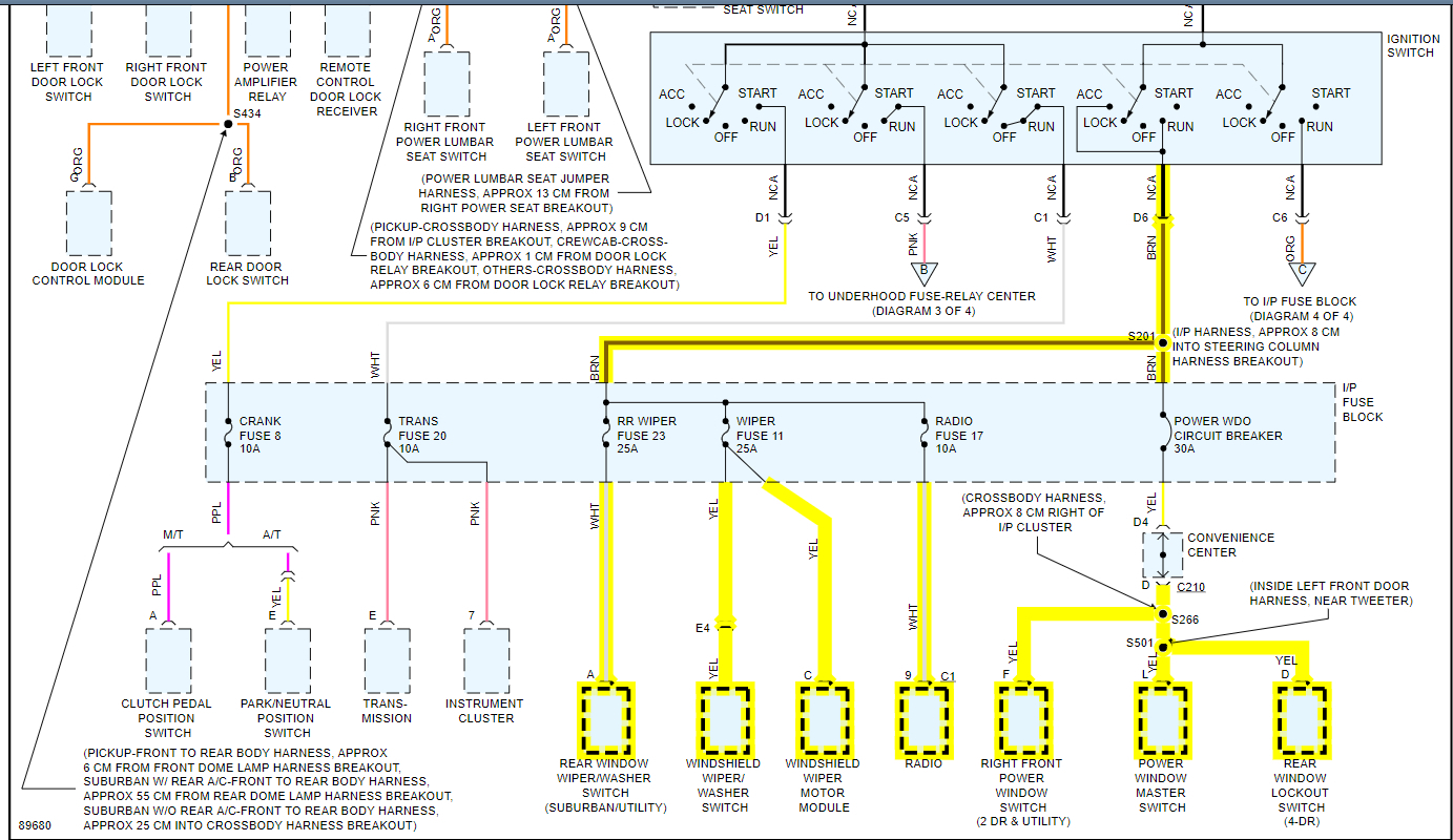

I have no ignition or battery power at the radio, I have tested at the fuse box on the left side of the dash and neither fuse has power on the distribution side. I do not see any fuses in the box under the hood for this. I am also finding the same for the wipers and power windows. What might the root of the problem be?
May 17, 2021 at 1:31 AM
Good afternoon,

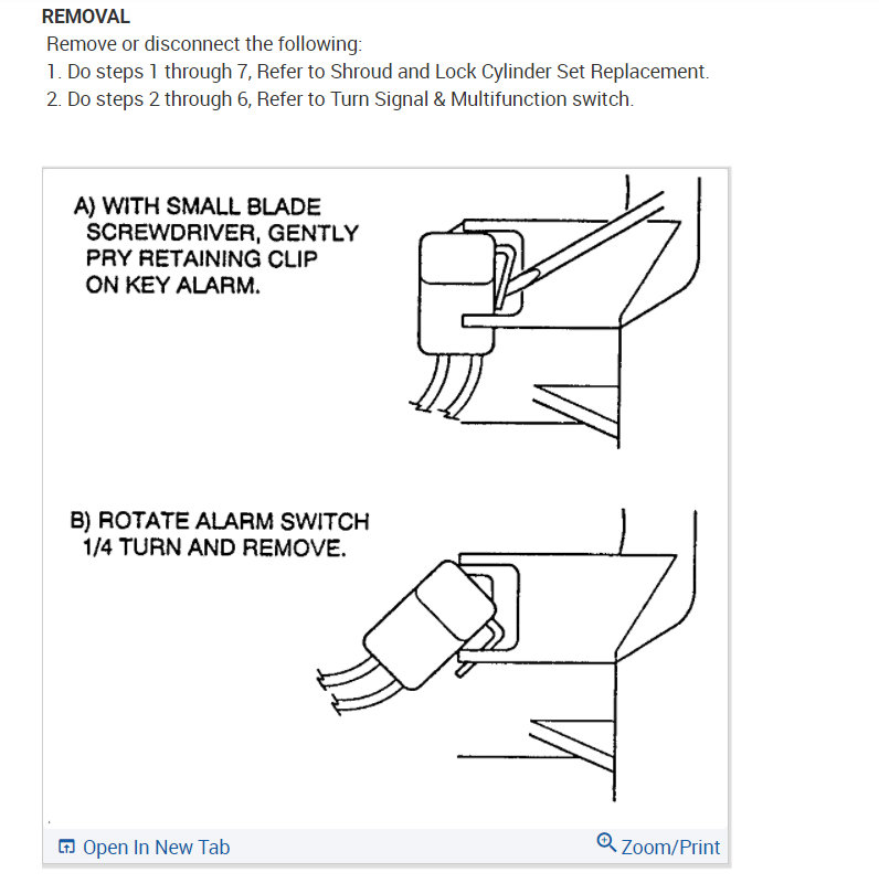

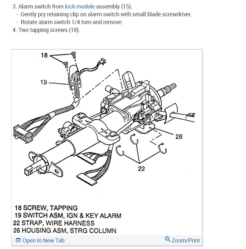

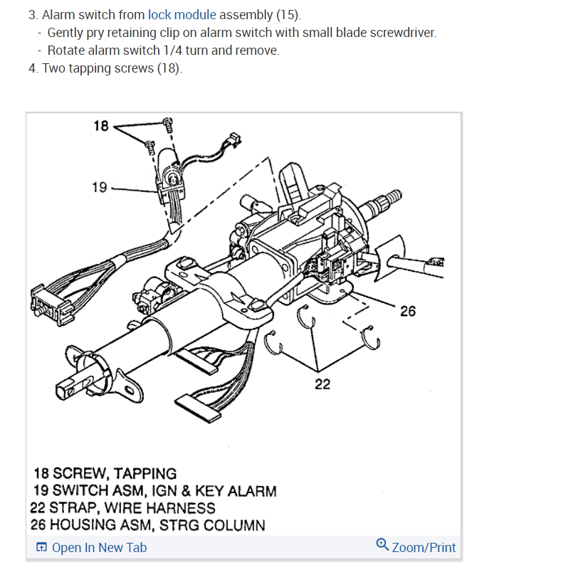

The ignition switch is what controls power to the fuse block for all the fuses that you listed. I attached the diagram for you to view.
It looks like the ignition switch is the issue.
