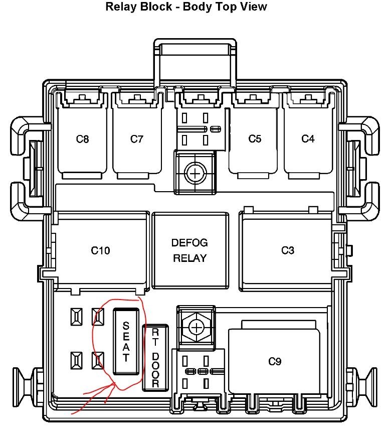

What size circuit breaker for power seat?
2003 CHEVROLET TAHOE
25,000 MILES
R. EVANS
circuit breaker for power seat.
May 25, 2021 at 1:21 AM
STEVE W.
  • 15,352 POSTS

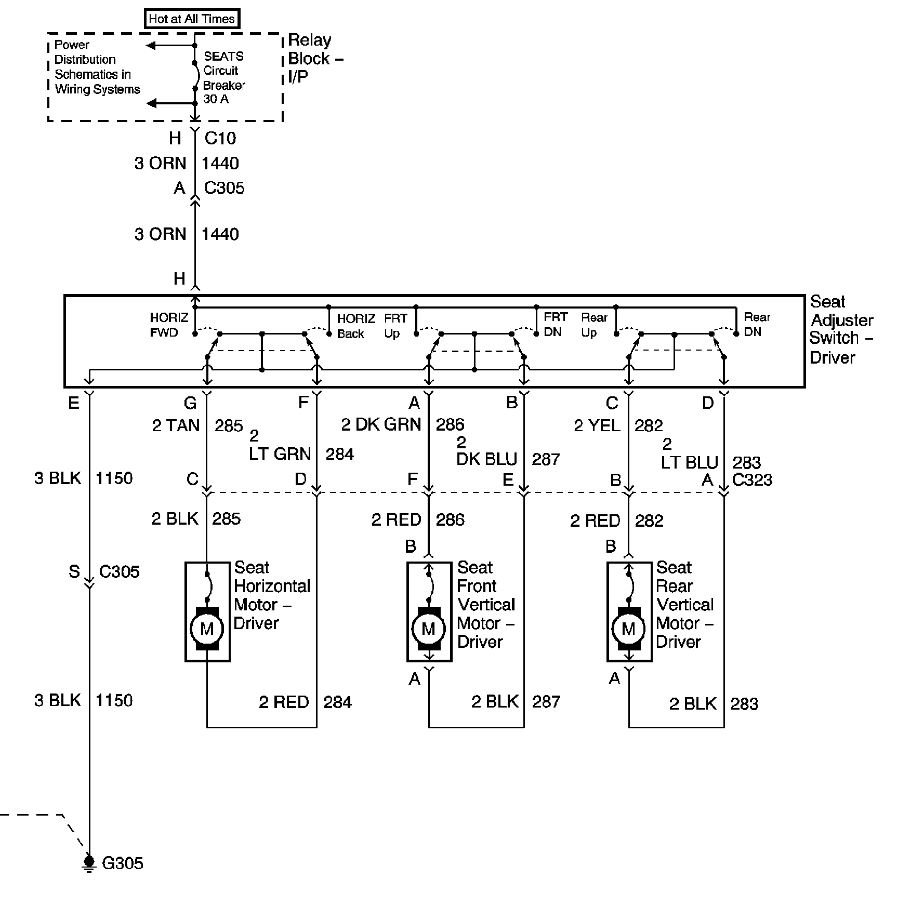

The factory one should be a 30 amp unit mounted in the relay block. If it has both seats as power they use the same breaker. Check out the diagrams (Below). Let us know what happens and please upload pictures or videos of the problem.
