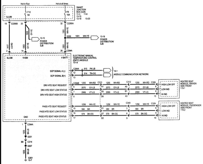

All environmental controls stopped working. No fan speed, no heat control, no A/C control, no vent control.
This is a manual control system.
There is a circuit board behind these control switches which I believe is the problem, but I cannot find anyone who has one or can order one.
Can you help please?
Oct 17, 2017 at 6:39 AM
STEVE W.
  • 15,413 POSTS

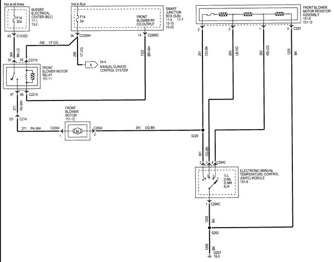

That is not a separate part you have to get the complete control panel either from the dealer or a salvage yard. Yard pricing around me runs from $20.00 to $90.00 depending on if you have rear controls as well.
However, you might want to check all of the fuses first. That unit has a bunch.
Fuses 8, 12 and 14 in the smart junction box all provide power to it in some manner.
I would also pull the control and verify power at the actual connections before condemning it. I have seen quite a few of the "Smart Junction boxes" act dumb.
