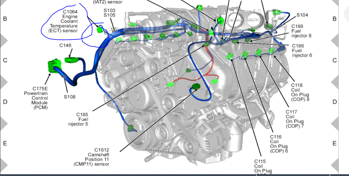

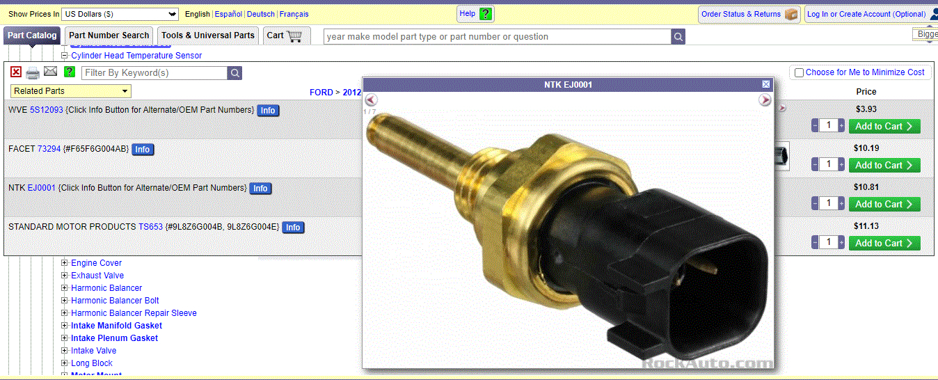

Hello everyone! I need help finding the location of the CHT sensor on the car listed above. Thanks in advance.
Oct 11, 2020 at 12:53 PM
Experienced Mechanic
52,796 POSTS
Good morning,
The sensor is on the back drivers side of the motor. It is not an easy replacement as it is very tight back there.
https://www.2carpros.com/articles/how-a-coolant-temperature-sensor-works
I attached a picture of the location for you to view. I also attached a connector for you to view. It has the color of the wires for the sensor. You will need a 3/4 or 7/8 socket or wrench to remove the sensor.
