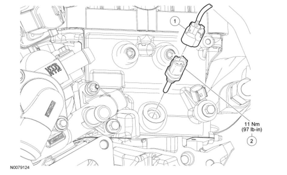

Where is the CHT sensor located on my vehicle listed above XLT?
Mar 27, 2019 at 6:48 AM
Good morning,
I attached a picture of the sensor location for you and the procedure for replacing it.
NOTE: If the cylinder head is being replaced, the CHT must be replaced.
1. Disconnect the Cylinder Head Temperature (CHT) sensor electrical connector.
2. Remove the CHT sensor.
- To install, tighten to 11 Nm (97 lb-in).
3. To install, reverse the removal procedure.

Awesome, thanks.
