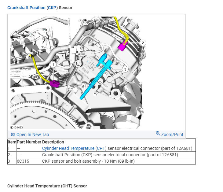

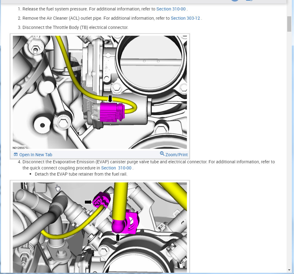

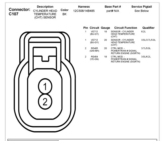

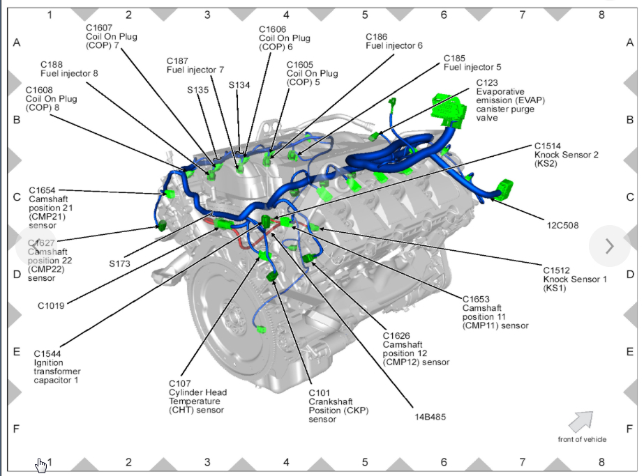

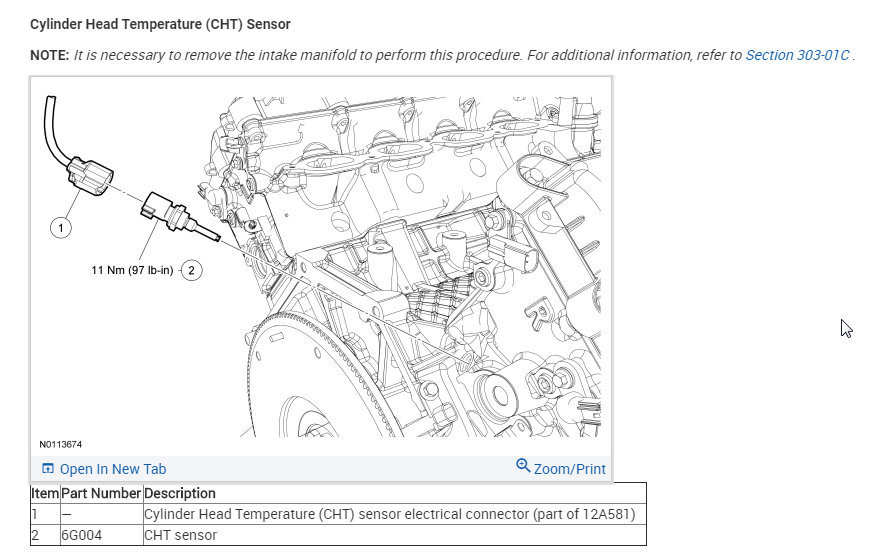

Where is the CHT located on my engine?
Jun 11, 2020 at 4:48 AM
Experienced Mechanic
18,907 POSTS
I attached the location view of the CHT.
Let us know if you need more info. Thanks
Images (Click to enlarge)
Jun 11, 2020 at 10:22 AM
LINGR100
MEMBER
2 POSTS

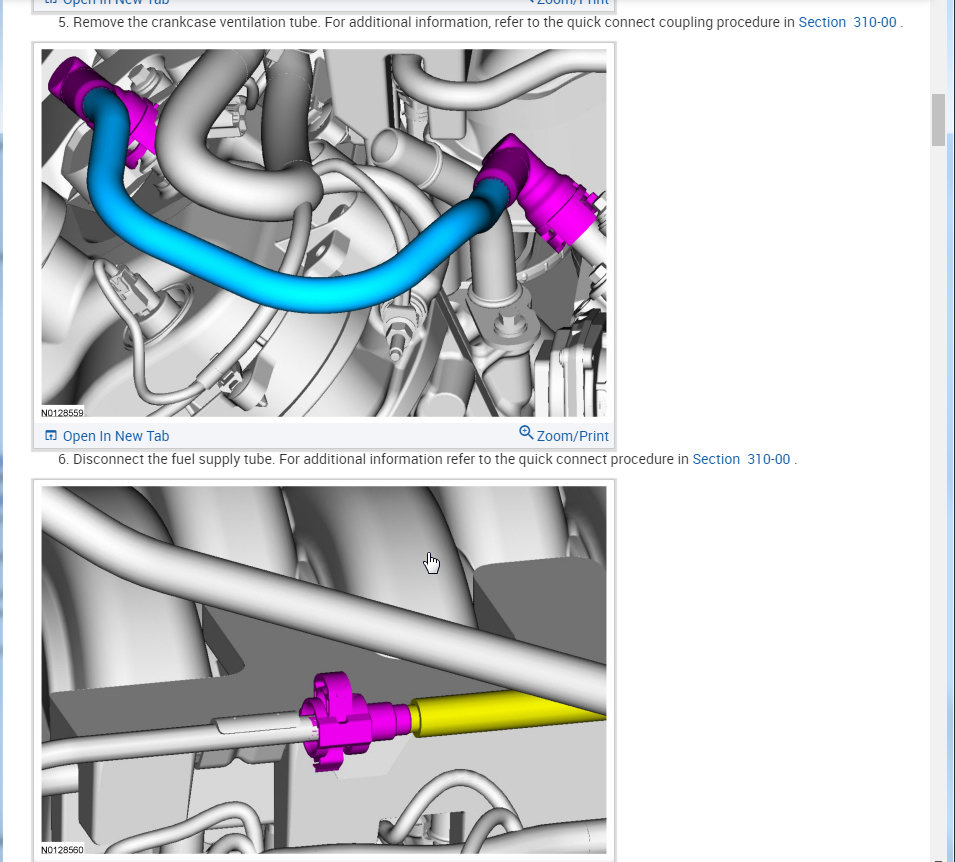

Thank you! Found it, now to try and actually get to it!
Jun 12, 2020 at 1:57 AM
18,907 POSTS

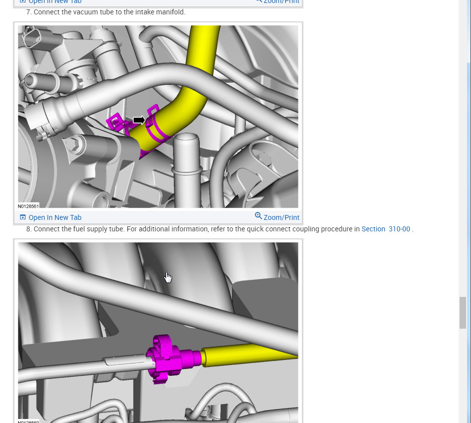

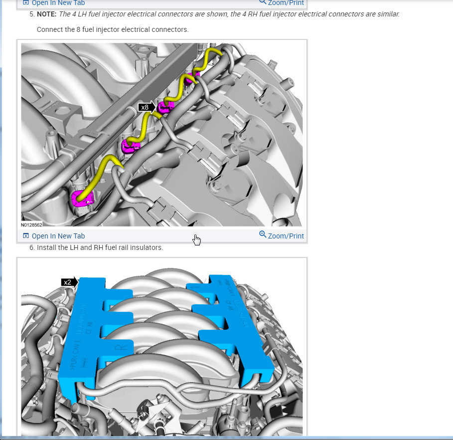

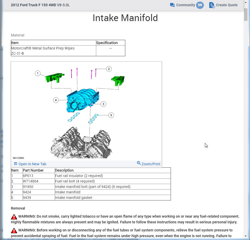

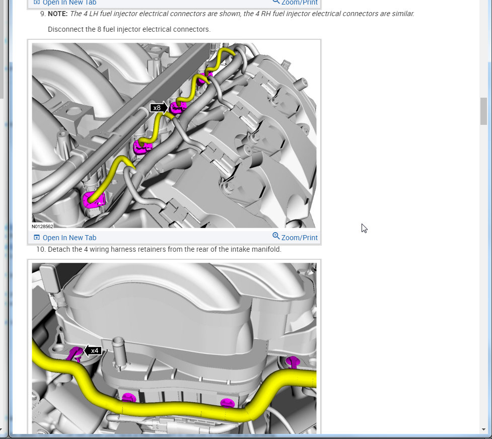

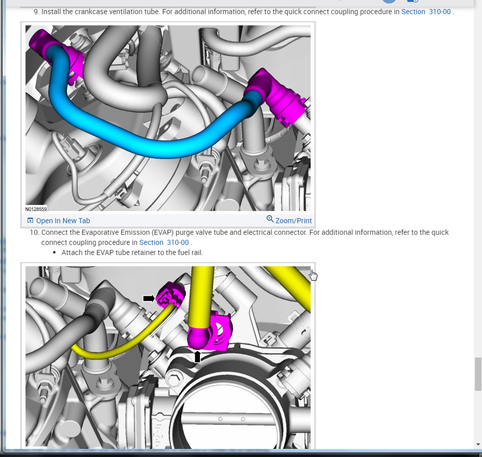

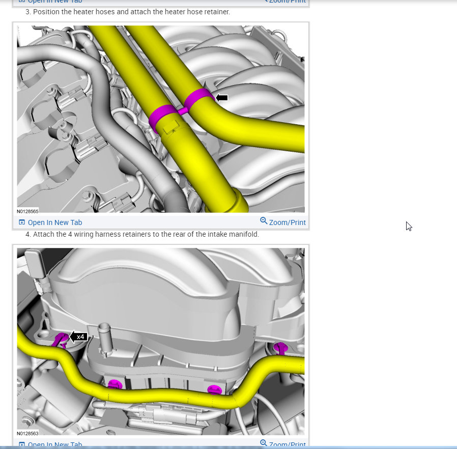

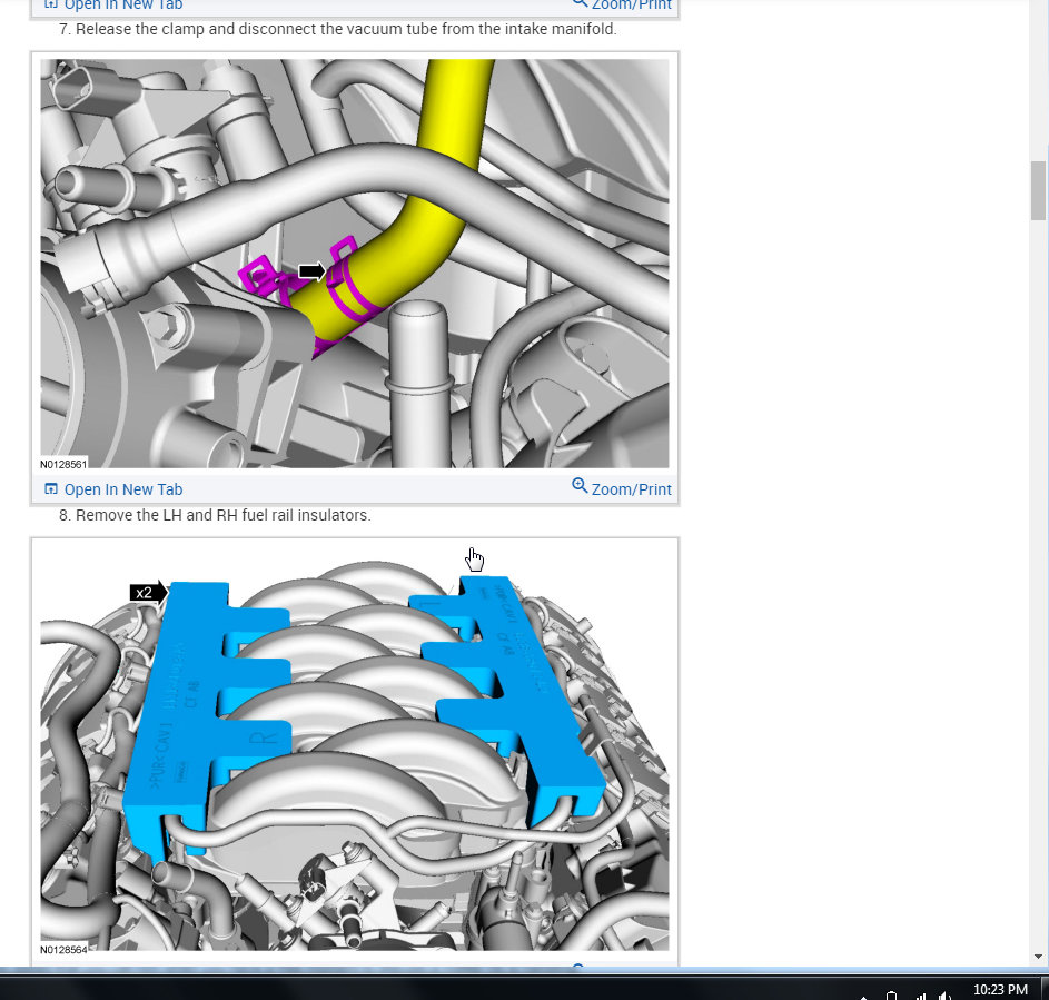

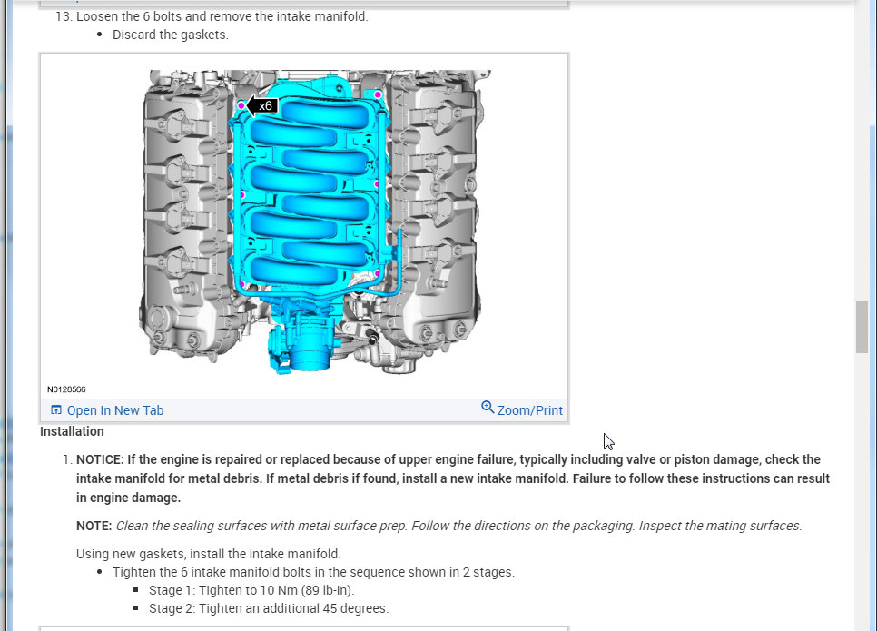

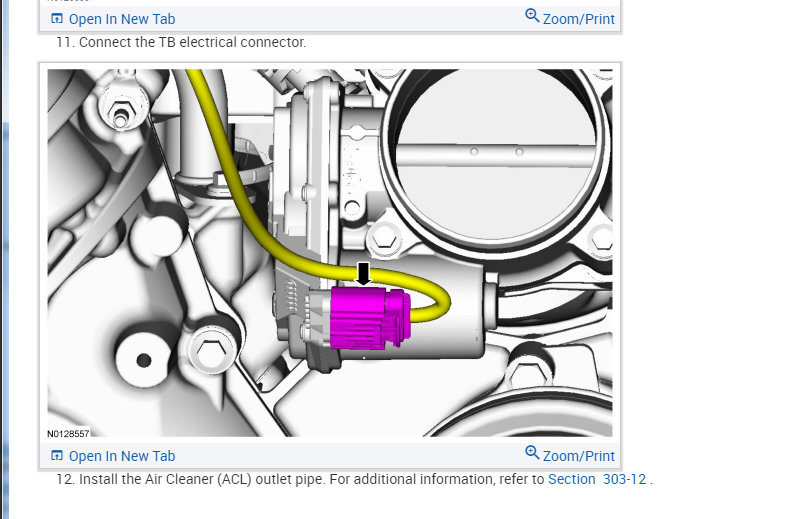

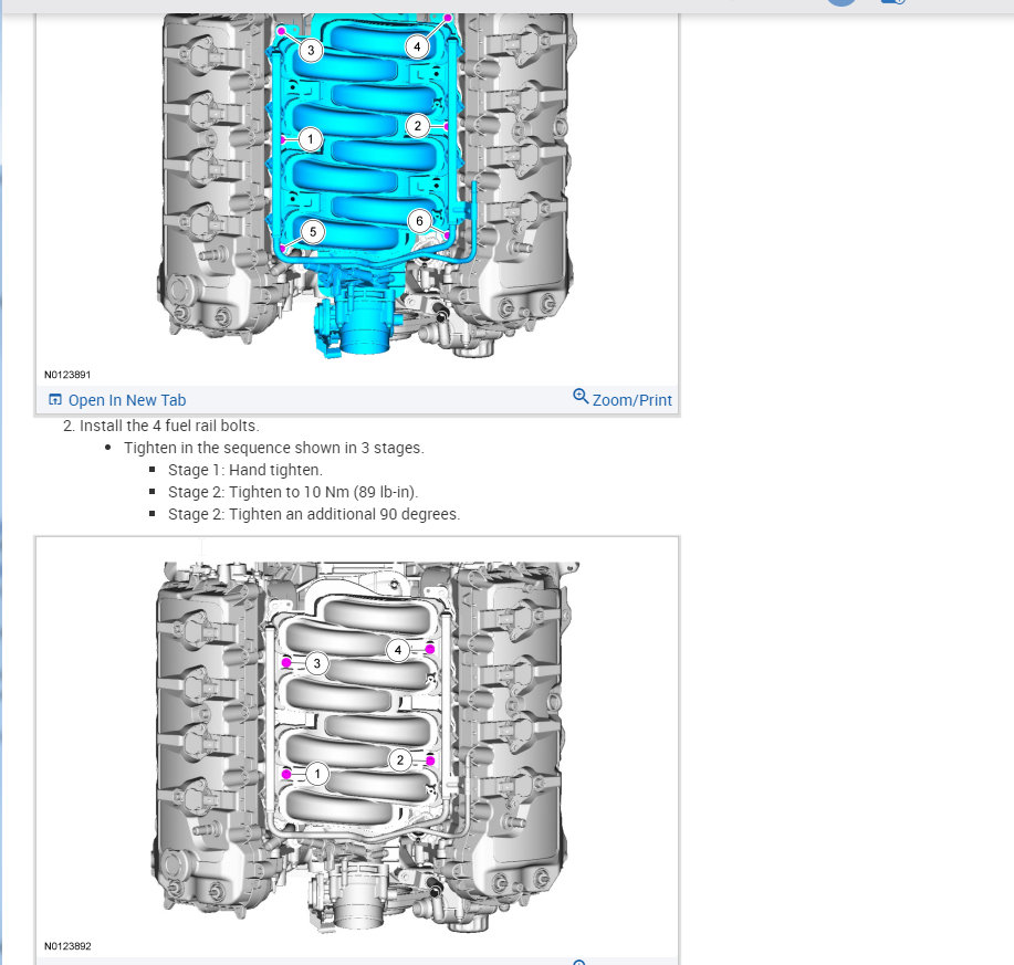

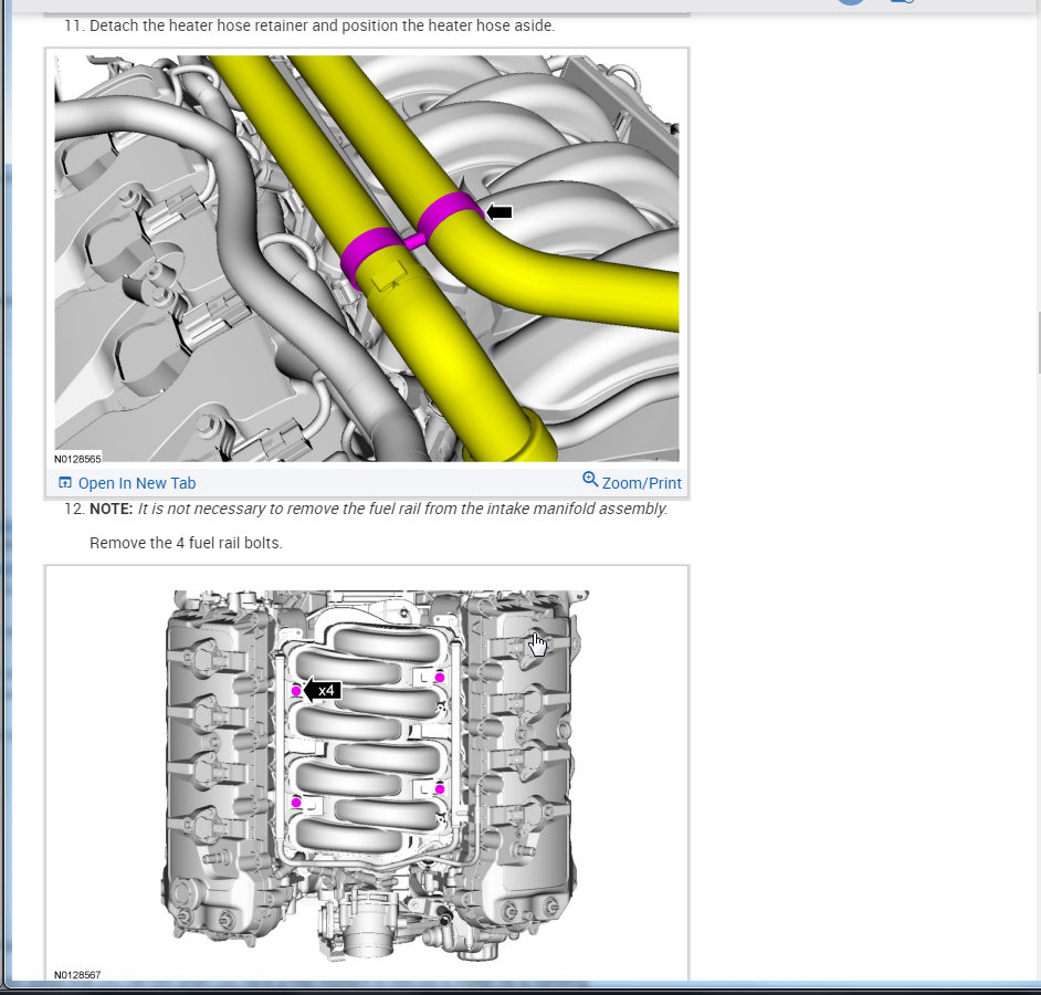

Haha. Yes. That is the hard part. You actually need to remove the intake. I attached the process on how to do this.
