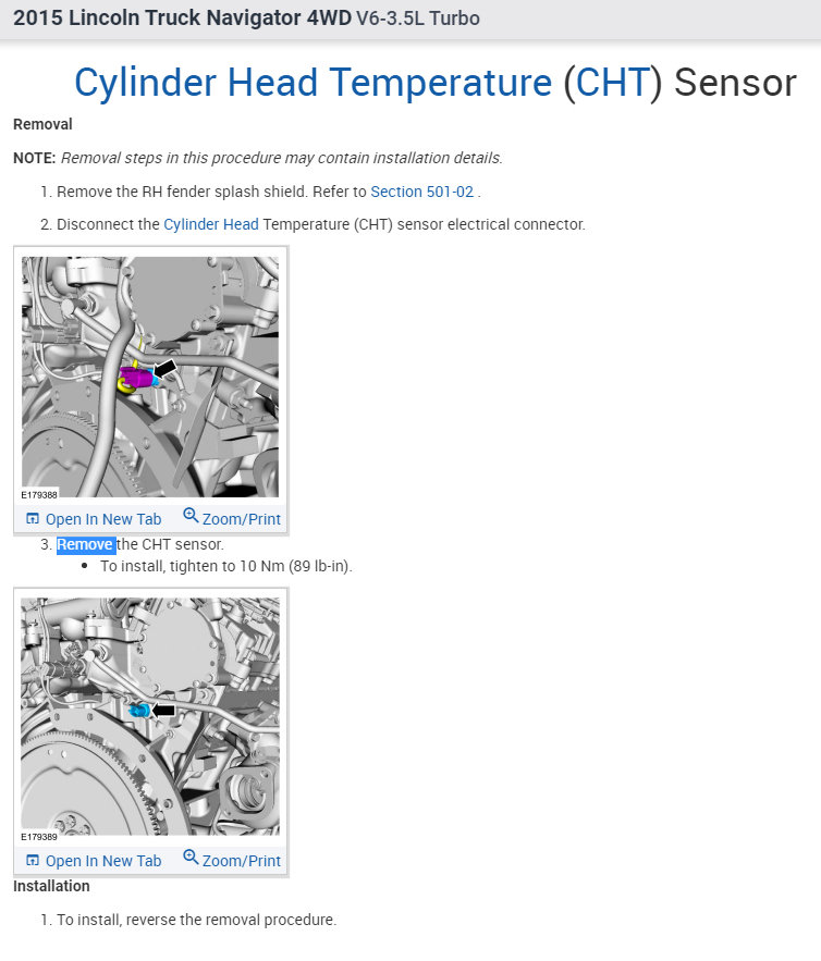

Need to locate cylinder temperature sensor.
Jun 21, 2022 at 12:46 PM
SQM
Experienced Mechanic
6,383 POSTS

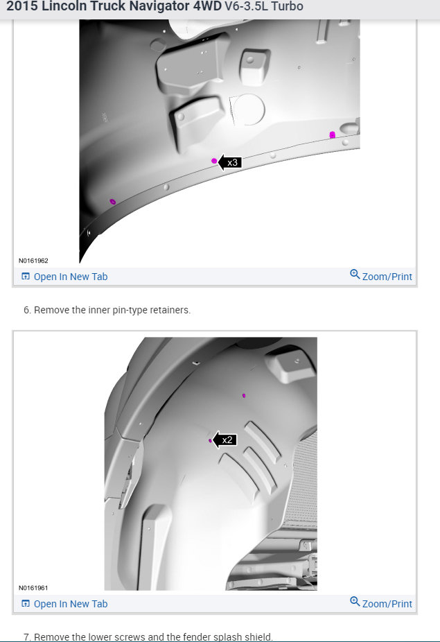

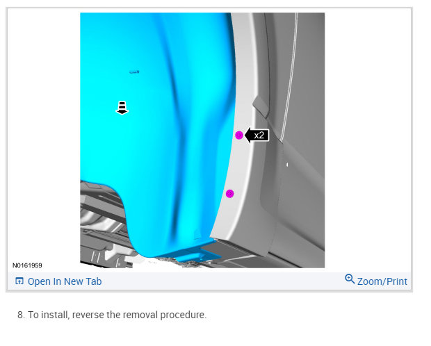

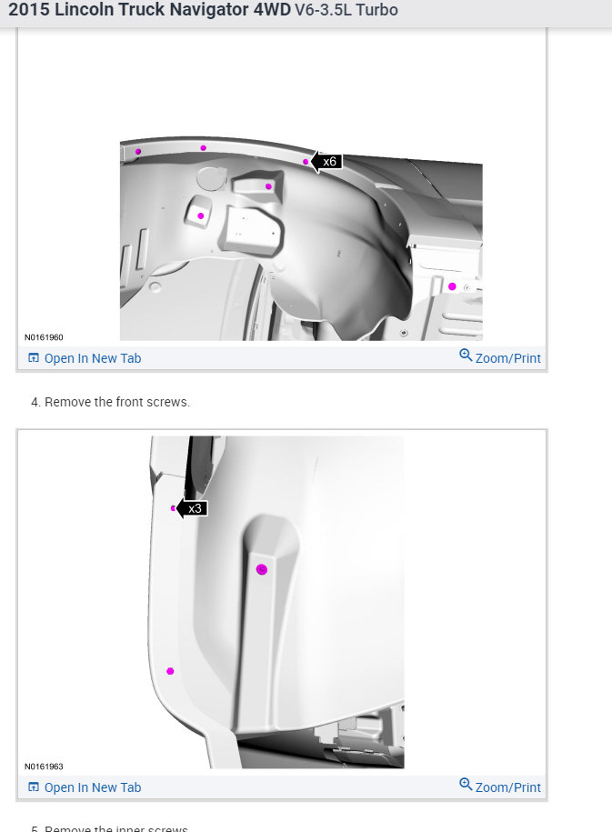

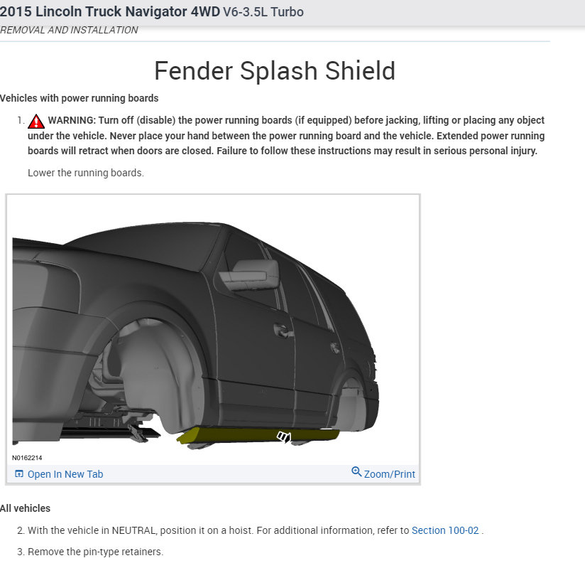

In order to access the CHT you will have to first remove the right-hand inner fender liner. This will allow you to get to the sensor.
I have attached diagrams below showing the location.
Let me know of any questions.
