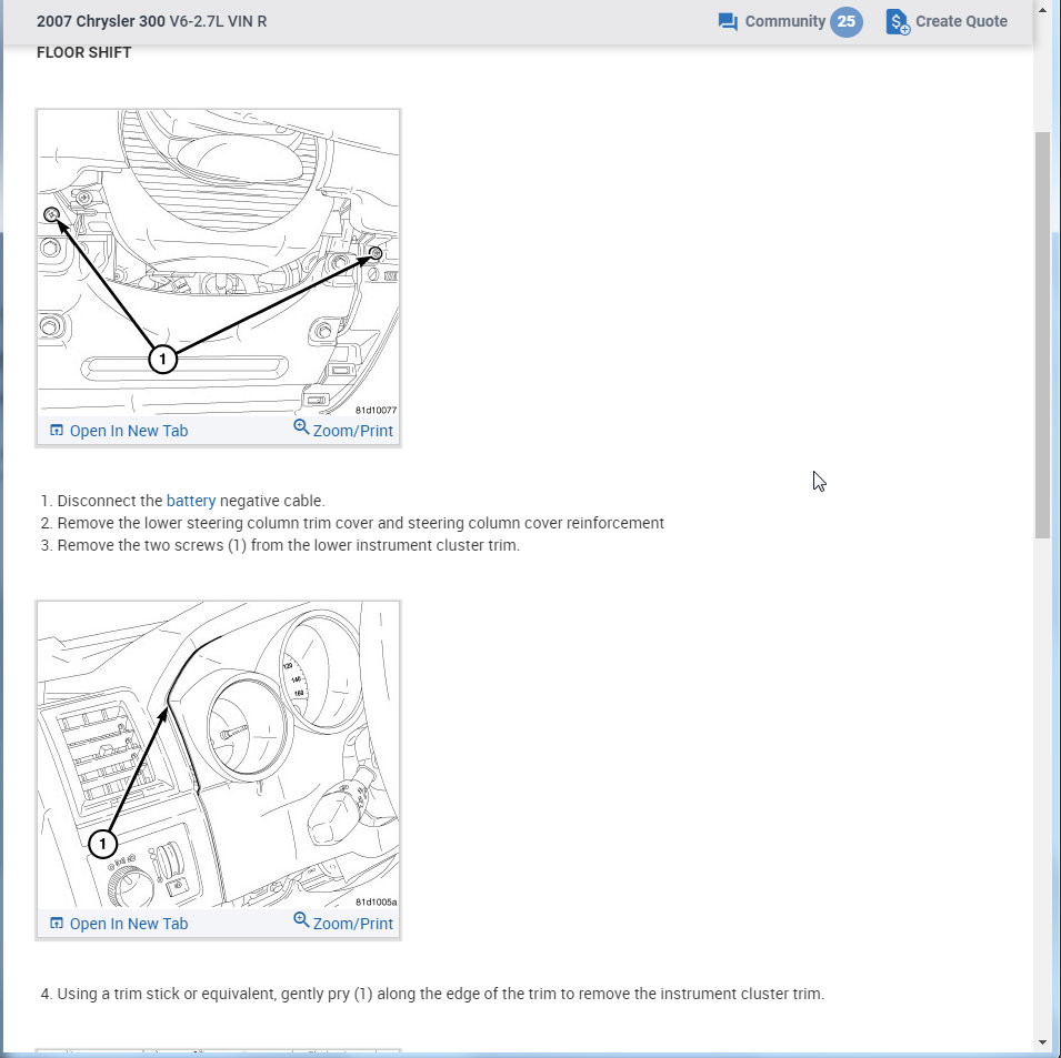

I obtained the car listed above because I was owed money. When the car showed up, it was being towed which was funny to me because the guy said It was working fine, I had my suspicions and looked around and found out that the car was broken into and I believe it was it and he tried to steal the car but we’re unsuccessful. When I put the key into the ignition it turns freely. The ACC lights turn on but no crank no start. What could be the problem/problems?
Apr 24, 2020 at 8:16 AM

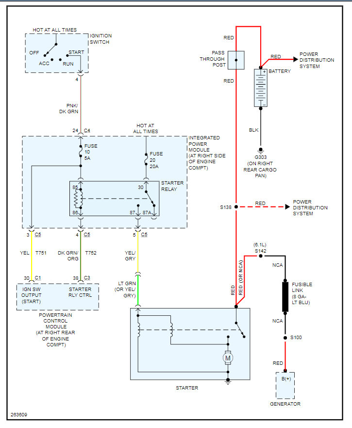

Does the theft light turn off when you turn the key to the on position? If not, we need to check for codes because I suspect the engine is disabled due to an active theft event.
If the theft light goes off then we need to go to the starter and see what voltage we have on both connections while cranking. Let me know what you find with this and we can go from there. Thanks
Apr 24, 2020 at 8:31 AM
SAUL OROZCO

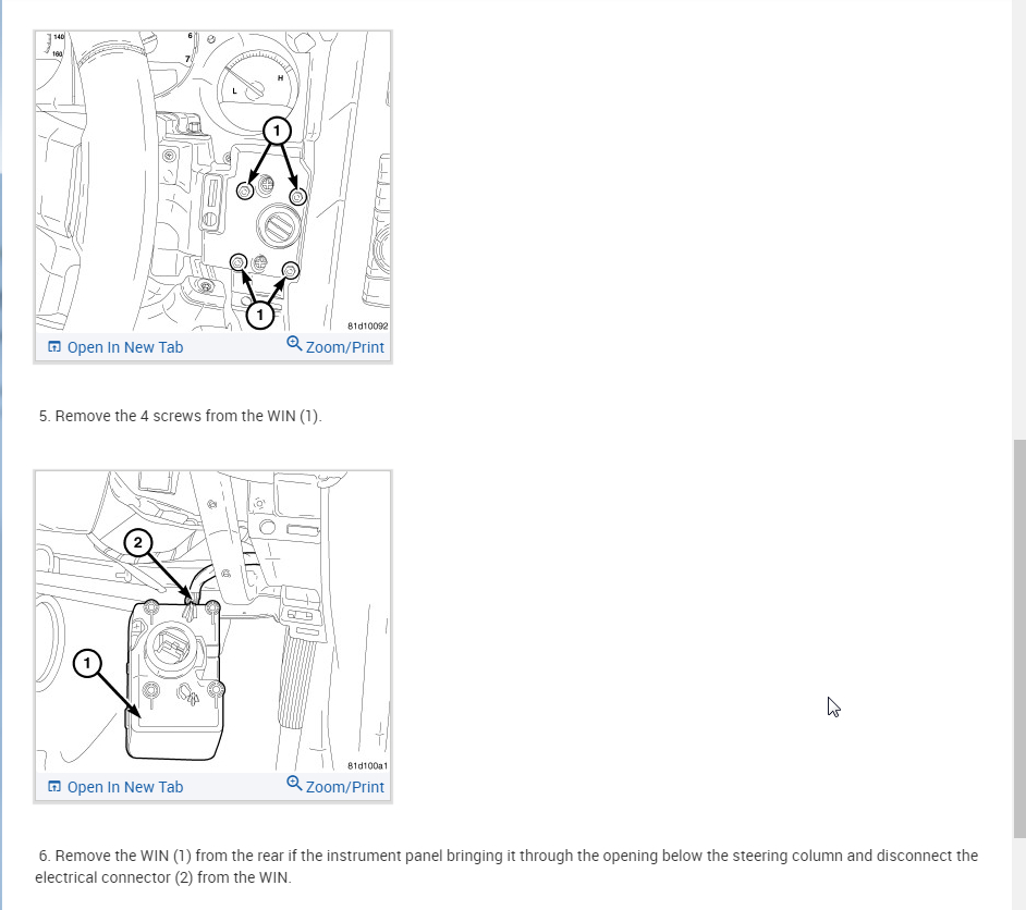

The light does turn on but I just realized that I do not have to put in the key in order for the ignition to be in the "on" position. It’s basically stuck on "on" position without me inserting the key. But no crank. I can’t be it’s on "on" position.
Apr 24, 2020 at 9:09 PM
Okay. If this is stuck then it will need to be replaced and then we can test the system. This is called a WIN wireless ignition node, and basically just get the code from the key and if it matches that in the system it tells the PCM to start the vehicle. If it doesn't move then there is no repairing them.
