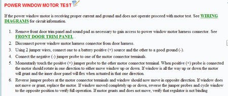

Last week power window on passenger side made a noise and quit with window open about 4 inches. Today the driver side window was in wide open position, made the same grinding noise when I tried to shut it and quit.
Any suggestions on what could be the cause: fuse, wiring, computer or window motor?

You failed to give the year? some chyslers have a plastic track with gear teeth on it, you might need to replace the tracks...

the power windows failure referred to in my post was on a 1999 T&C short wheel base.

Start with this test.
https://images.2carpros.com/forum/automotive_pictures/62217_Window_Motor_1.jpg
