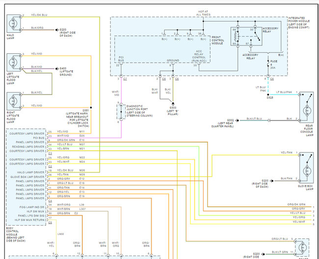

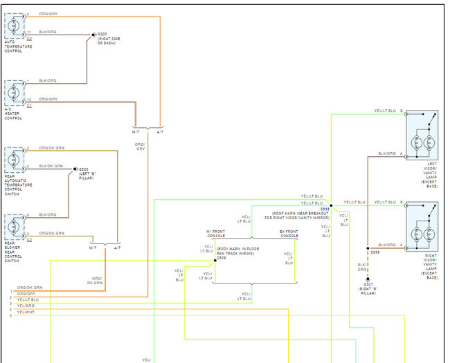

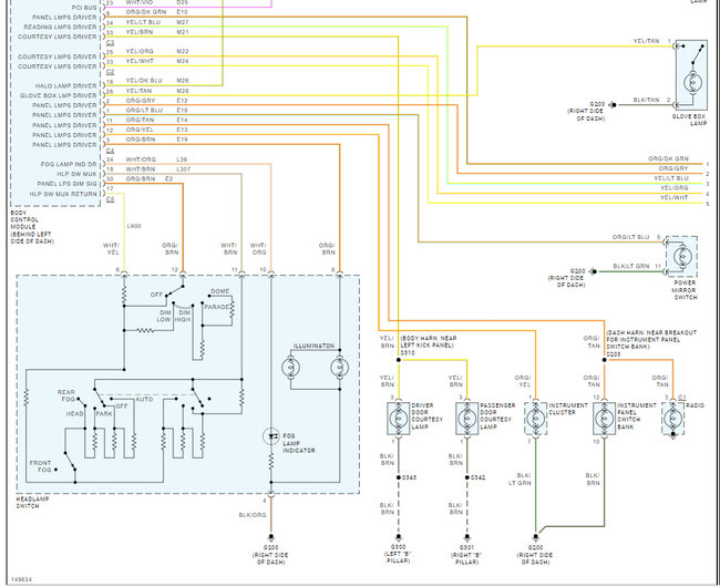

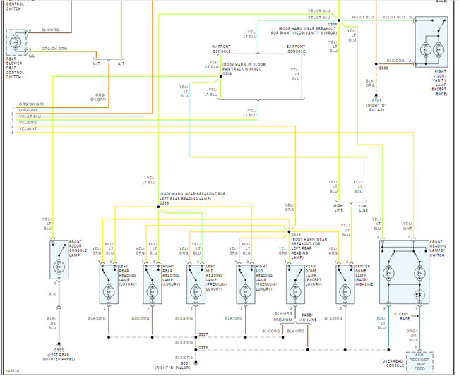

our 2002 chrysler voyager van had 2 bulbs out in the dash for backlighting the temp gauge, and the fuel gauge. I replaced the bulbs and all was fine. Then out of nowhere, after a week or so, I lost all the dash lights as well as the backlighting on the A/C control panel. I have checked the fuses and they are all good, unless there is a fuse panel other than the one I checked. The only one I can find is the one under the hood. This is frustrating. This vehicle is gradually turning into a lemon. Any ideas? Thanks, JB

Just above the brake pedal, right of the parking brake is another fuse box. Never had to change any fuses, so don't know what's inside.

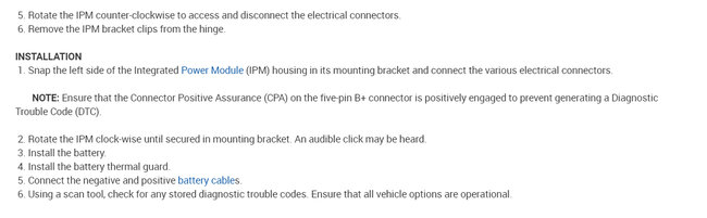

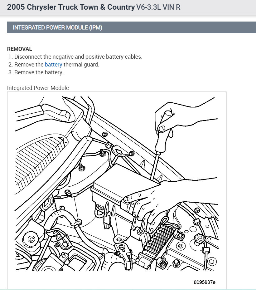

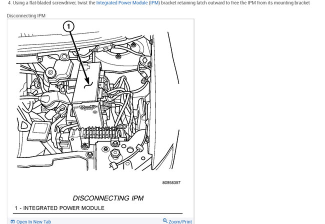

Those lights are controlled by the IPM and the BCM. Here is the cluster lighting wiring diagrams so you can see how the system works. FYI they had problem with the TIPM which are easy to replace. Here is how in case you want to give it a try, also you should do a CAN scan which should help us as well, you can get a CAN scanner (Controller Area Network) which will work on most cars from Amazon here is a video to show you how.
https://youtu.be/u-4syLc-ifQ
Check out the images (below). Let us know how it goes
