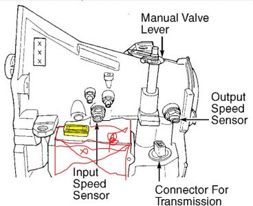

Chrysler does not have any sensors or relays inside the transmission. all on the out. First step should be to check for codes. most likely to be a faulty solenoid pack located side of transmission under the speed sensor. it is a black box with a square connector. Codes first.

I found that there is a transmission range sensor in the transmission. Some where after the filter. I guess it has something to do with the temperature.
I checked the transmission control relay and that is good to go, as well as the fuse. So I guess I am down to the transmission control solenoid or possibly the range sensor. Anyone know how I can test those?

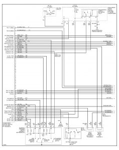

I tested the TCM to the best of my ability (and I do not know much of anything about electricity nor testing it). I took the wiring off and tested the actual unit. But I put voltmeter to the Ohms setting. Put my black wire to pin #57 (ground) then to the different solenoid controls and senses. I see by my book there are four control pins and three pressure switch sense pins. Out of the four solenoid control pins only pin 19 came back with 47.6 ohms and the others came back with open lines. :( I am assuming that I did the test properly. can anyone validate that? One thing, with my voltmeter set to ohms, I put the black to my neg terminal on my battery and red to pin 57 (ground) and it still said OL. Is that the proper way to test for a ground. Do I just have a bad ground? Or is it still my TCM?
What is the difference between a solenoid control and a pressure switch sense? Was I right in testing the controls and not the senses? I honestly tested everything that I could in many different scenarios and this one seemed to make the most sense.
Sorry for all the questions, I am just trying to figure this out without taking it into a shop. Just had a new baby and we are trying to save money we do not have, lol.
Sorry for all the questions, but if my TCM is working properly to my solenoid cannot I test the values at my solenoid wiring harness? I have a picture an description of pins and stuff, I am just not sure on what or where to test and what to expects.
I am unable to find the ground location for the TCM. After thinking on it for a while, maybe I just do not have a good ground? Where are the grounds for the TCM? I have a service manual but cannot find it in there. It tells me near the T/O. But no pictures. What is a T/O? Maybe i knocked the ground loose when I hit the road debris that went under the van?

https://images.2carpros.com/forum/automotive_pictures/99387_1_9.jpg
Oct 10, 2010 at 12:04 AM
BMRFIXIT
  • 19,053 POSTS
TCM ground location is above the starter.
check black/red and black/yellow wires for a good ground.
