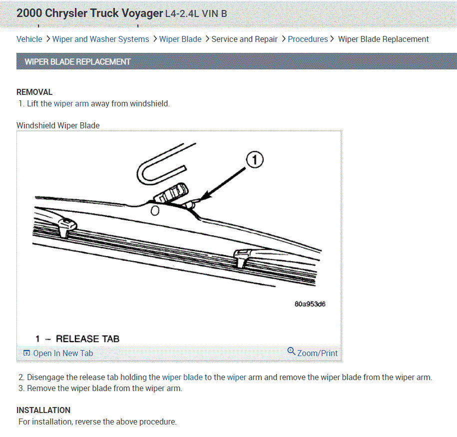

It poured for about an hour and the windows were all the way down. What should we do to dry it out and I need to replace the wipers can you help me?
May 25, 2008 at 3:28 PM
  • 110,190 POSTS
The best thing to do is get a wet/dry shop vacuum and suck out as much of the water from seats and carpeting as you can. Then, I would have a fan blow air through the vehicle to help dry things the rest of the way.
As far as the wiper blades, I attached the directions below for you. It is really easy to do.
See pic below.
