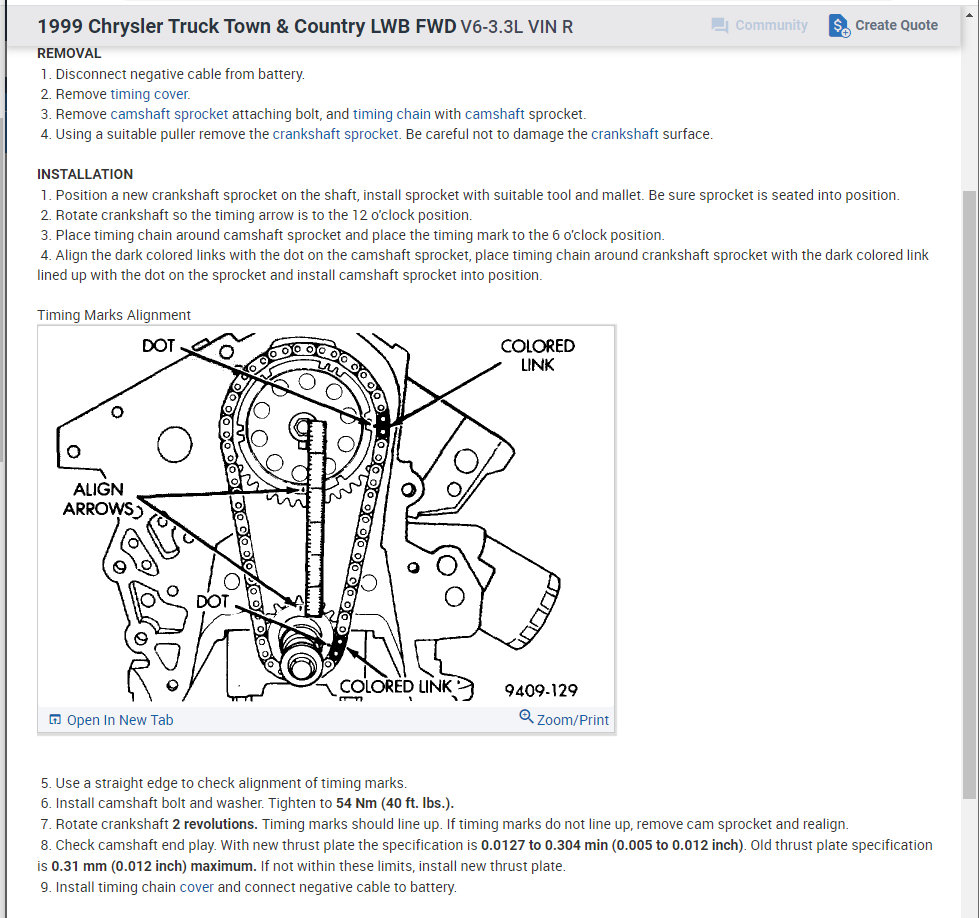

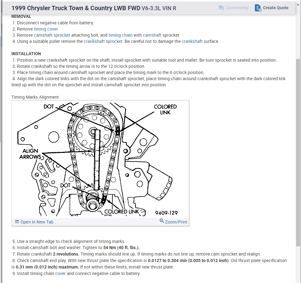

I have had a water pump replaced before but do not remember a timing belt at the same time. How can i know for sure if i have a timing belt or chain?
Nov 21, 2009 at 7:09 AM

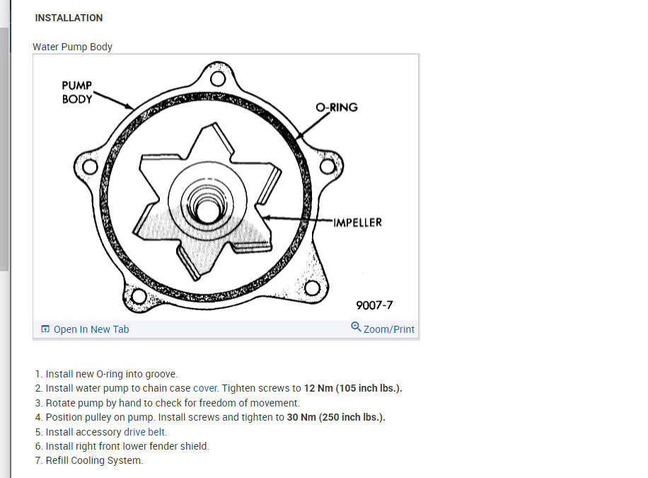

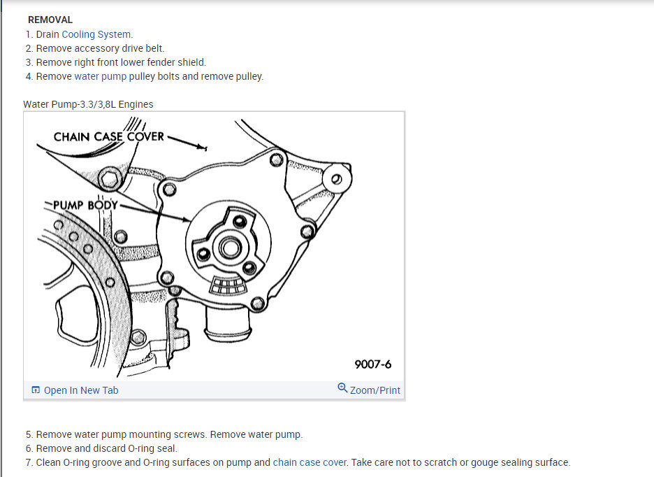

You have a timing chain and does not require replacement unless there is an issue that causes you to need to do this.
Here is a guide that will help with replacing the water pump if you need this info:
https://www.2carpros.com/articles/water-pump-replacement
Also, your engine has a water pump that does not require you to remove the front cover like on some other vehicles so I included the timing chain and water pump process below just so you can review this or if others need it in the future.
Let us know if you have other questions on this. Thanks
