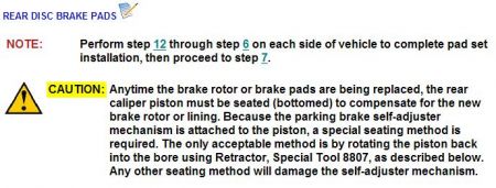

I cannot reset the caliper on the rear brake. It has a combination foot and emergency brake on the rear cylinder. It does not retract when presure is applyed.

Hi there, There is a special tool required to screw the piston back into the caliper see pic and text for details. Mark (mhpautos)
