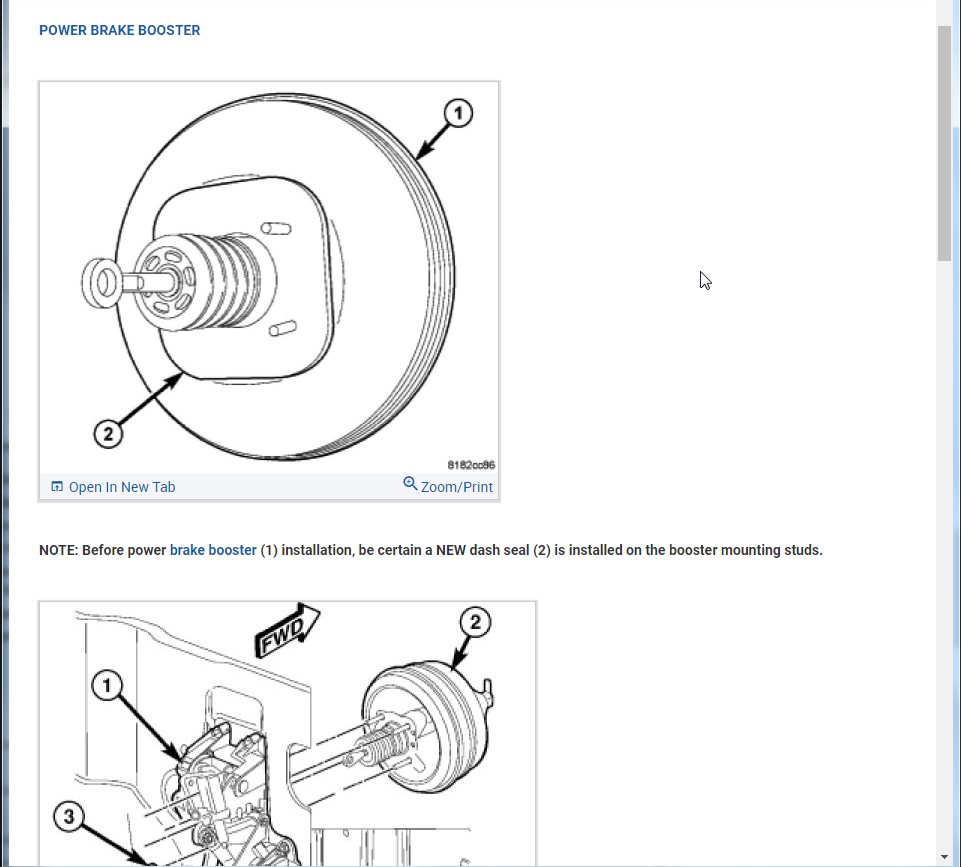

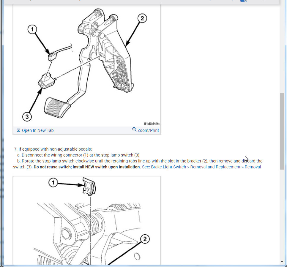

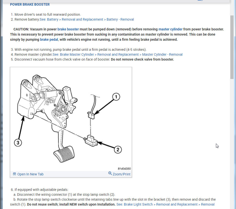

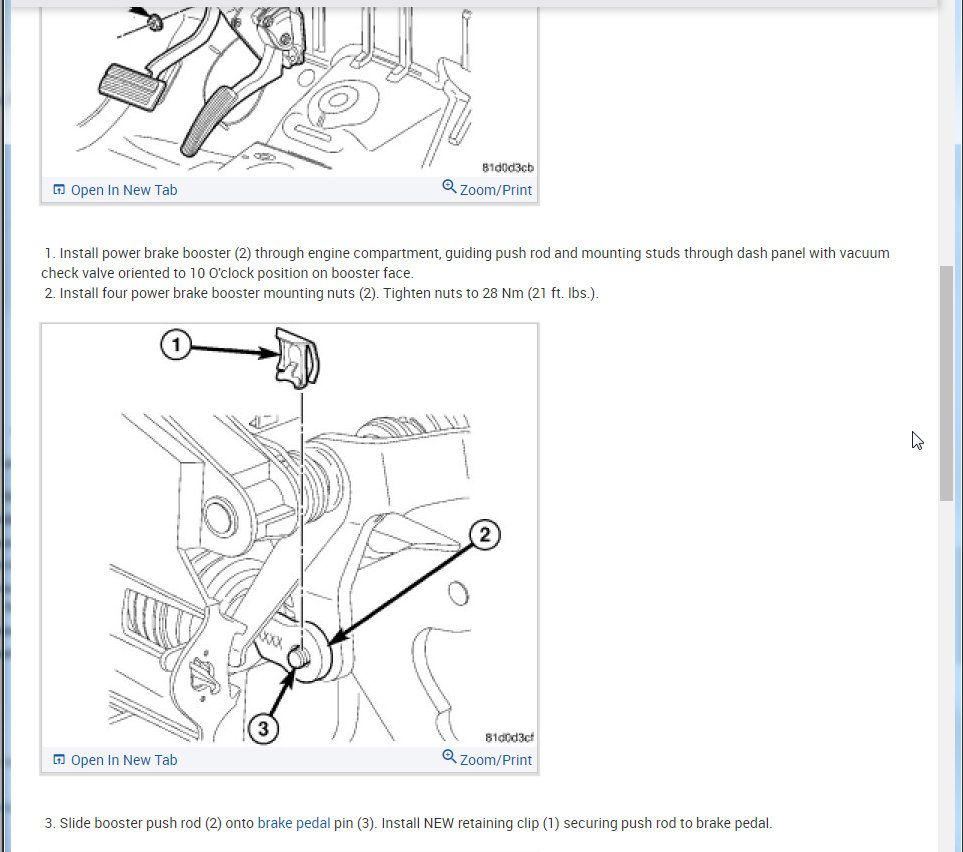

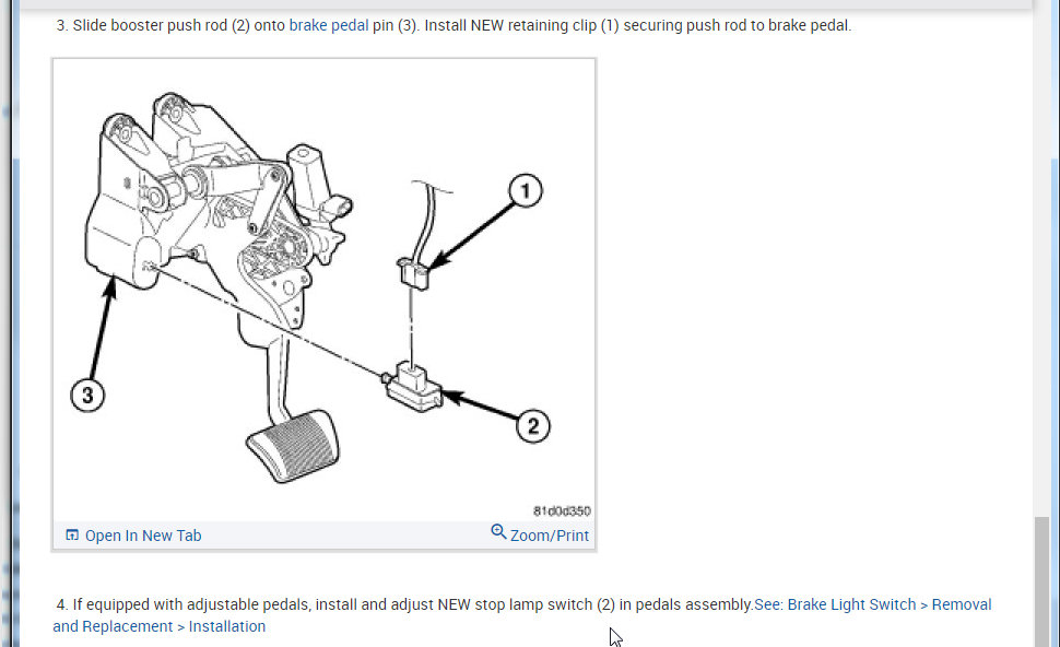

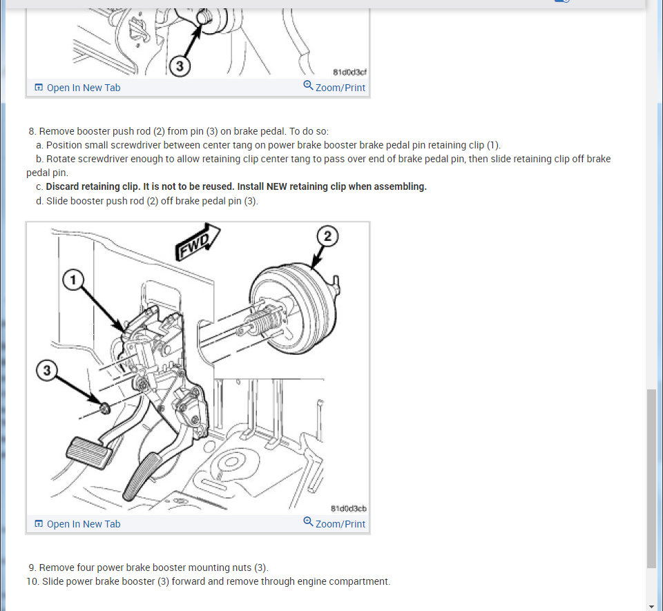

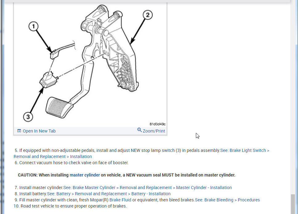

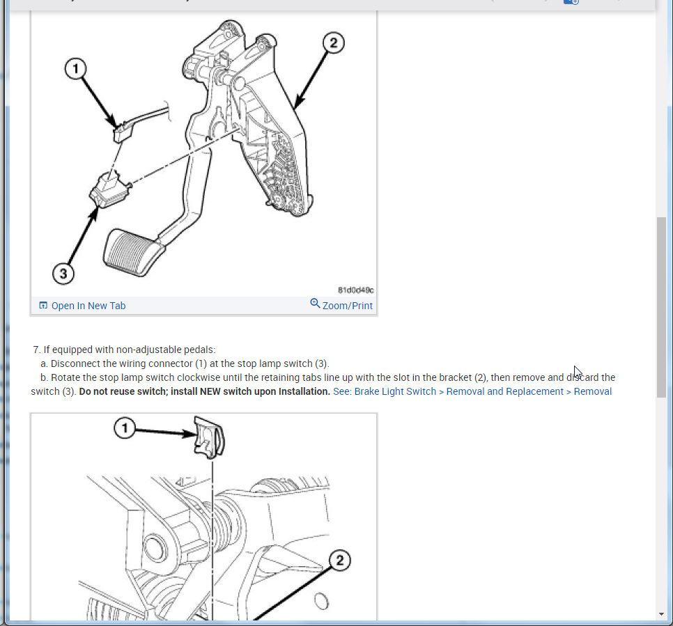

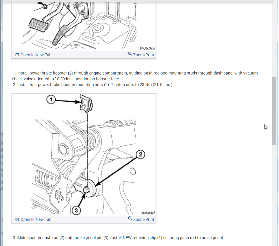

how do you install the brake booster?
May 29, 2010 at 9:55 PM
Below you will find the process from the manual on how to replace this booster. Let's run through this and let us know if you need more info. Check out the diagrams (Below). Please let us know if you need anything else to get the problem fixed. Thanks.
