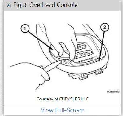

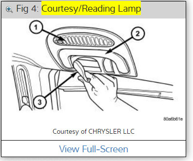

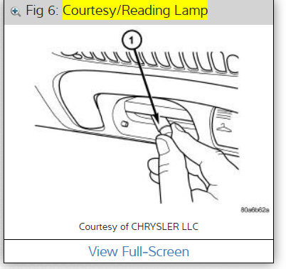

how do you replace the bulb in the map light that is by the rear view mirror?
Jan 24, 2009 at 1:06 PM
BLUELIGHTNIN6
  • 16,542 POSTS
Disconnect and isolate the battery negative cable. Using a flat bladed tool, pry off the lamp lens. You have to pry at the bottom of the lens or you break the top hinge. Remove bulb from lamp. Install bulb to lamp. Press lens into place. Reconnect the battery negative cable.
