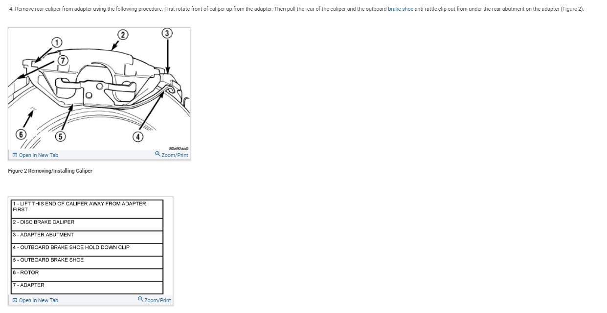

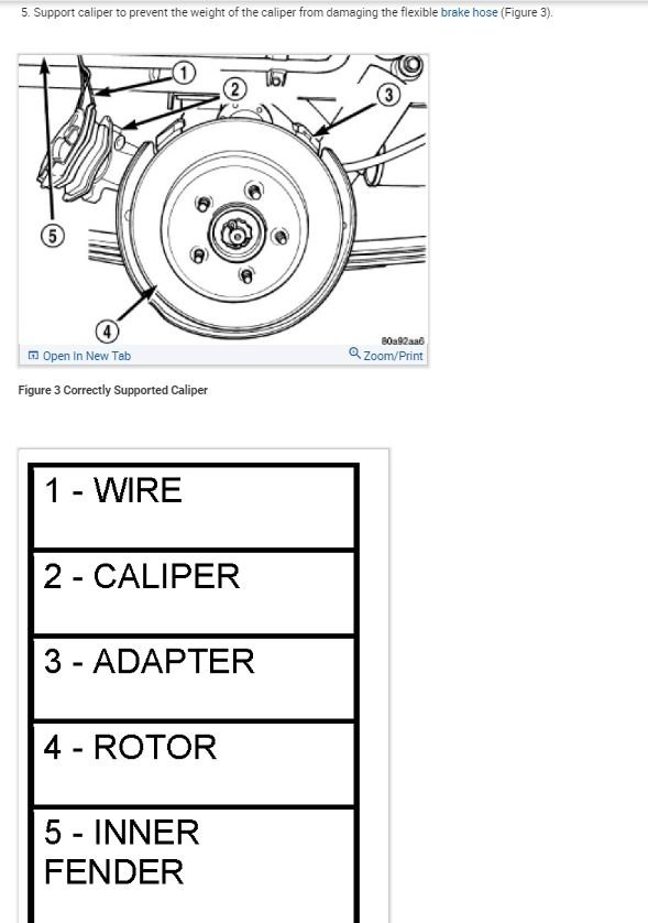

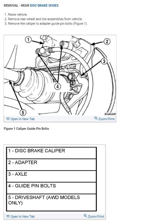

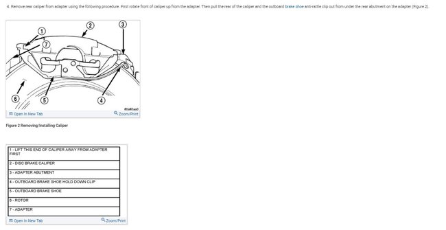

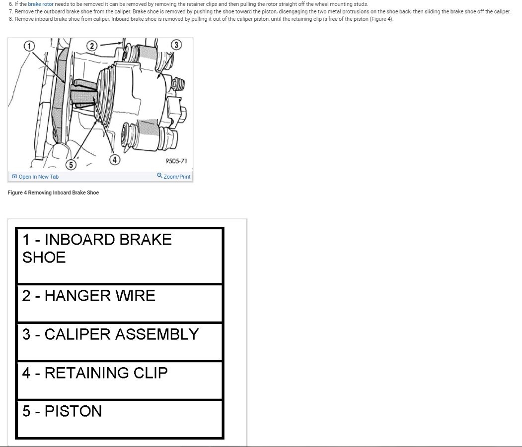

I can't figure out how to replace rear pads. Please help.
Sunday, July 25th, 2010 AT 1:01 PM
EDWARD.S
MECHANIC
166 POSTS
The rear pad procedure is similar to the fronts...
Read the guide below on rear pad change, it will help.
https://www.2carpros.com/articles/how-to-replace-rear-brake-pads-and-rotors
The vehicle specific instructions fro you vehicle are attached below
