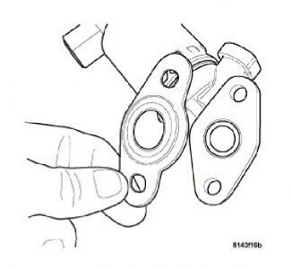

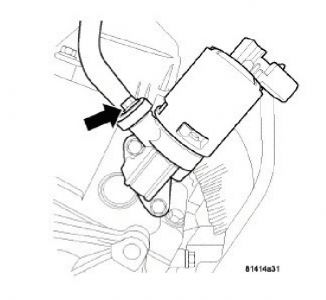

I am trying to change the EGR Valve and I can not get to the bottom bolt on the valve. I am woundering if I have to take the Alternator off or not to finish this or is there another way to get to the bottome bolt?

REMOVAL - 3.3L/3.8L
https://images.2carpros.com/forum/automotive_pictures/12900_egr1_3.jpg
Disconnect and isolate negative battery cable. Remove accessory drive belt. Remove generator mounting bolts and reposition generator. Unlock and disconnect the electrical connector from the EGR valve. Remove the 2 EGR tube bolts.

Remove the 2 mounting bolts for the EGR valve and gasket. INSTALLATION - 3.3L/3.8L
https://images.2carpros.com/forum/automotive_pictures/12900_egr2_2.jpg
Install a new gasket on the EGR valve.
Position EGR valve to cylinder head and install the 2 mounting bolts. Tighten EGR valve mounting bolts to 31 Nm (23 ft.lbs) . Position EGR tube to EGR valve and install the 2 mounting bolts. Tighten EGR tube mounting bolts to 13 Nm (115 in.lbs) . Connect electrical connector to EGR valve. Install generator mounting bolts. Install accessory drive belt. Connect negative battery cable. https://www.2carpros.com/kpages/auto_repair_manuals_alldata.htm
Aug 7, 2010 at 5:30 PM
SLEEPYSANCH
No. Once you get the top bolt off, twist on the egr valve to be able to get to the other bolt.
