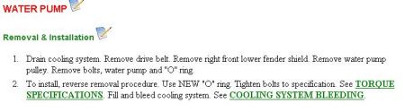

I need some direction on removing belt and water pump from my van.
Sunday, October 18th, 2020 AT 12:14 PM (Merged)
ZACKMAN
  • 4,202 POSTS
It is very advisable that you invest $20 for a Chilton or Haynes manual for a complete instructions and photos. Our TSB is meant for technicians and only has the following plus torque spec.
https://www.2carpros.com/forum/automotive_pictures/55316_98tcwp_1.jpg
DEVILDOG232
I just recently changed the pump on mine it is a 97 also it is simple. Just put a breaker bar on the tension pulley on the nut and pull towards the front of the van and should release the tension on the tension pulley and the belt can be removed then it is simple for the water pump take of the impeller outer casing and replace it with the new one.
