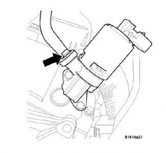

2006 Chrysler Town and Country Location and how to replace
PILWONDER2
  • 2006 CHRYSLER TOWN AND COUNTRY
Engine Performance problem
2006 Chrysler Town and Country 6 cyl Two Wheel Drive Automatic
just want to know the location of egr valve
Thursday, August 12th, 2010 AT 5:03 PM
  • 75,992 POSTS

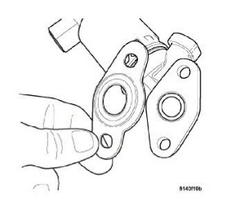

REMOVAL - 3.3L/3.8L
https://www.2carpros.com/forum/automotive_pictures/12900_e1_2.jpg
https://www.2carpros.com/forum/automotive_pictures/12900_e2_2.jpg
Disconnect and isolate negative battery cable.
Remove accessory drive belt.
Remove generator mounting bolts and reposition generator.
Unlock and disconnect the electrical connector from the EGR valve.
Remove the 2 EGR tube bolts.
Remove the 2 mounting bolts for the EGR valve and gasket
