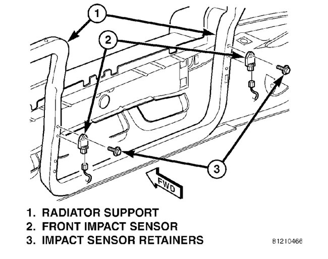

Airbag light is on. Scan tool says DTC code Right Up-Front Satellite Acceleration Sensor internal diagnostic code. No number with the code. I'm assuming it is the right front impact sensor on the frame. Any help?
Feb 21, 2010 at 5:44 PM
  • 110,194 POSTS
That sounds correct. I believe it is located under the bumper near where it attaches to the frame. Check out the diagrams (Below). Please let us know if you need anything else to get the problem fixed.

I am currently stationed in Germany with my American 2006 Chrysler Town and Country 3.8L V6 and I have an Airbag Light on. I took it to a Alpha Romeo Dealer to have a computer diagnose it and they gave me a print out that stated that the front left and front right impact sensors are the problem. I am having a difficult time believing that both sensors went bad at the same time so can you offer me some suggestions on where the problem is?
May 30, 2019 at 3:48 PM (Merged)
SATURNTECH9
  • 30,869 POSTS
The first thing I would need from you is the exact code numbers you have not code descriptions? Its hard for me to believe that both went bad at the same time also.Depending on the code numbers it might take a expensive scan tool that can read live air bag data to diagnose the problem.

My Town & County's Air Bag Warning Light keeps coming on and off. I've checked the connection to the sensor on the front bumper and nothing's loose.
I'm not sure where the Side Impact Sensors are located and where any other connections that I should check are located.

Unfortunately, parts store's (Autozone's Actron or Checker O'Reilly Equus) OBD-II scanner only scans PCM codes, not from ORC occupant restraint controller (air bag) codes. You will need a DRB scanner such as Genesis (nationally-reputable repair shops have it).
Your side impact air bag sensor is located on the lower B pillars (both sides), side airbag sensor on the outboard side of front seat back frame, ORC is under dash/instrument panel, forward of storage bin.
