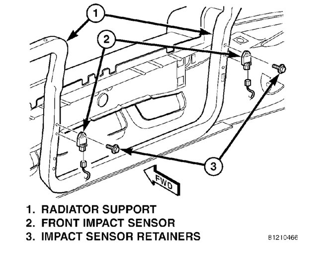

Airbag light is on. Scan tool says DTC code Right Up-Front Satellite Acceleration Sensor internal diagnostic code. No number with the code. I'm assuming it is the right front impact sensor on the frame. Any help?
Sunday, February 21st, 2010 AT 5:44 PM
17 Replies
  • 109,885 POSTS
That sounds correct. I believe it is located under the bumper near where it attaches to the frame. Check out the diagrams (Below). Please let us know if you need anything else to get the problem fixed.
