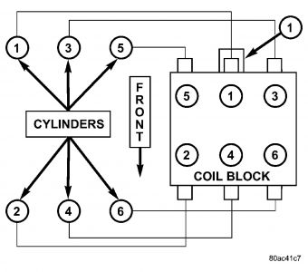

spark plug wires firing order
2005 CHRYSLER TOWN AND COUNTRY
BCARTY1960
Six cylinder front wheel drive automatic 110,000 miles.
i took off the three back wires and had to leave i do not remember the order they came off the distributor. can you help please and have a great day!
May 24, 2008 at 12:54 PM
  • 55,423 POSTS
Hello, Here is the engine firing order below The cylinders are numbered from the front of the engine to the rear. The front cylinder bank is numbered 2, 4, 6. The rear cylinder bank is numbered 1, 3, 5. Check out the diagram (below)
https://images.2carpros.com/forum/automotive_pictures/99387_05_chry_1.jpg

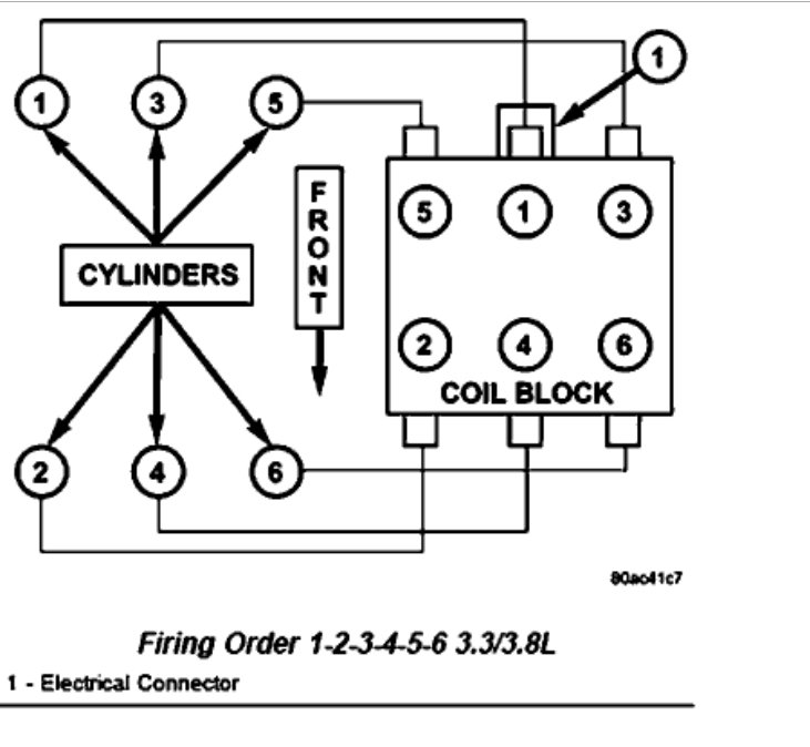

Hi Ken, I have a 2008 Chrysler Town and country 3.8. after changing cylinder plug and wire on 4 I still get heavy vibration from my engine at startup.
Mar 29, 2021 at 3:44 AM
BROTHA DAVE
So I changed all wires and plugs. To find out the the engine was doing the same thing.
Mar 29, 2021 at 3:54 AM
  • 110,244 POSTS
A cylinder misfire can be caused by a couple of things. How many miles are n the vehicle? Also, are there any noises from the engine? Are there any odd smells or smoke from the exhaust?
Let us know.
Mar 31, 2021 at 11:36 AM
FIREMEN2024
got 2014 town and country my code is Po303 I've changed all plugs still have a code P0303. what to do next? thank you
Mar 23, 2023 at 2:07 AM
  • 110,244 POSTS
If the misfire is still present at cylinder 3, switch the cylinder three coil pack with a different one on the engine. If the coil pack is bad, the misfire will move to a different cylinder.
For example, if you switch the coil packs on cylinders 3 and 4, if it is bad, you will get a P0304 and the P0303 will go away,
