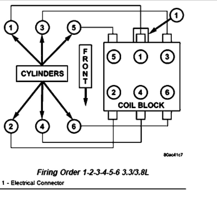

i took off the three back wires and had to leave i do not remember the order they came off the distributor. can you help please and have a great day!
May 24, 2008 at 7:54 PM
  • 54,861 POSTS
Hello, Here is the engine firing order below The cylinders are numbered from the front of the engine to the rear. The front cylinder bank is numbered 2, 4, 6. The rear cylinder bank is numbered 1, 3, 5. Check out the diagram (below)

If the misfire is still present at cylinder 3, switch the cylinder three coil pack with a different one on the engine. If the coil pack is bad, the misfire will move to a different cylinder.
For example, if you switch the coil packs on cylinders 3 and 4, if it is bad, you will get a P0304 and the P0303 will go away,
