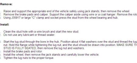

Snapped a rear wheel stud. How do I properly get the old stud out and get the new one in? Thanks!

https://images.2carpros.com/forum/automotive_pictures/170934_2005_lugstud_1.jpg

Thanks for the reply! I'm able to get the brake caliper off and out of the way. But how do I get the rotor off? Is it pressed onto the hub? Or are there bolts somewhere that hold it in place? Thanks again!

You may have to tap a little around the rotor with a hammer to get it loose. Sometimes they get a little rusty around the lug holes. There shouldn't be anything else holding it.
