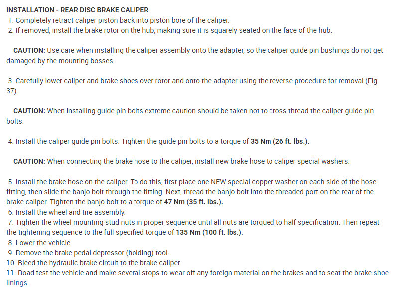

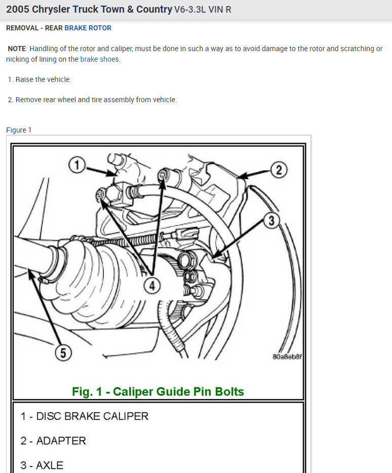

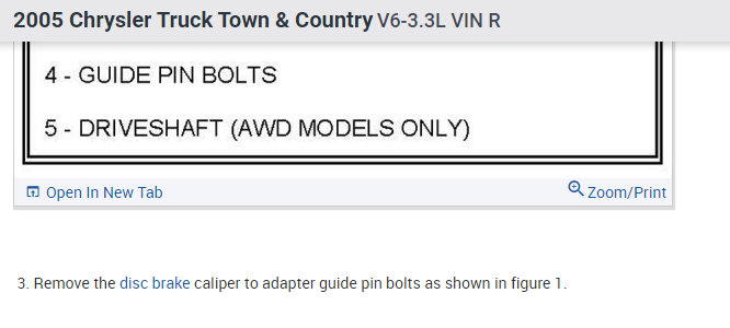

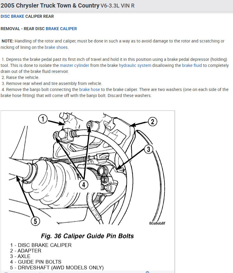

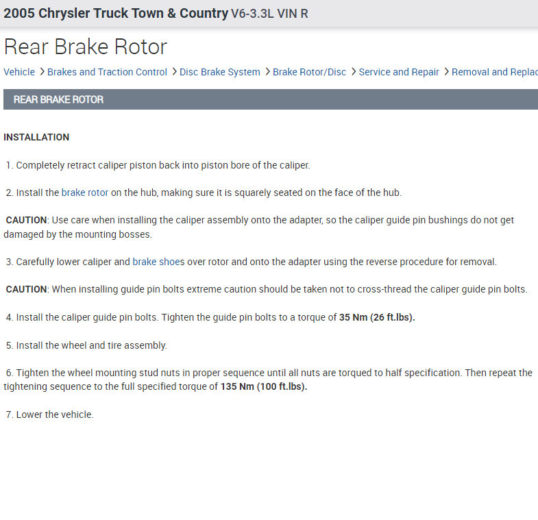

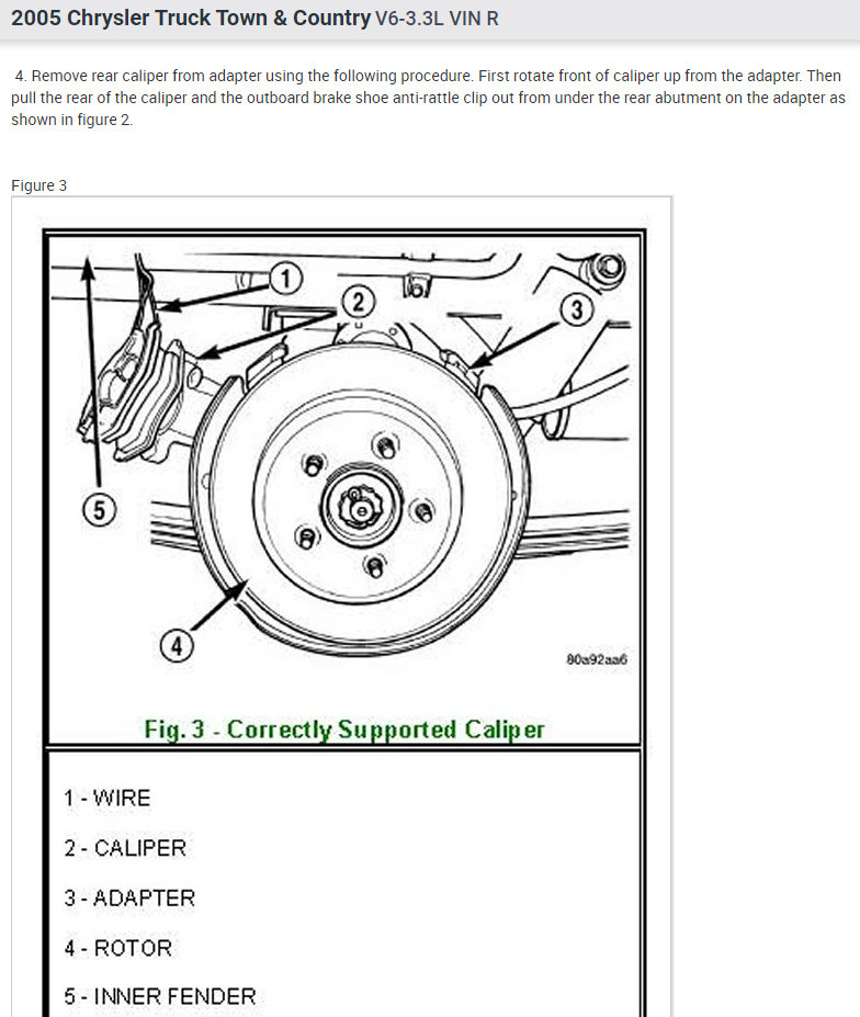

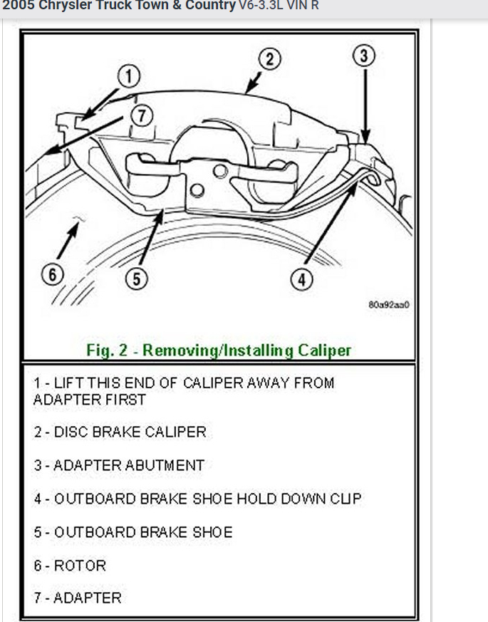

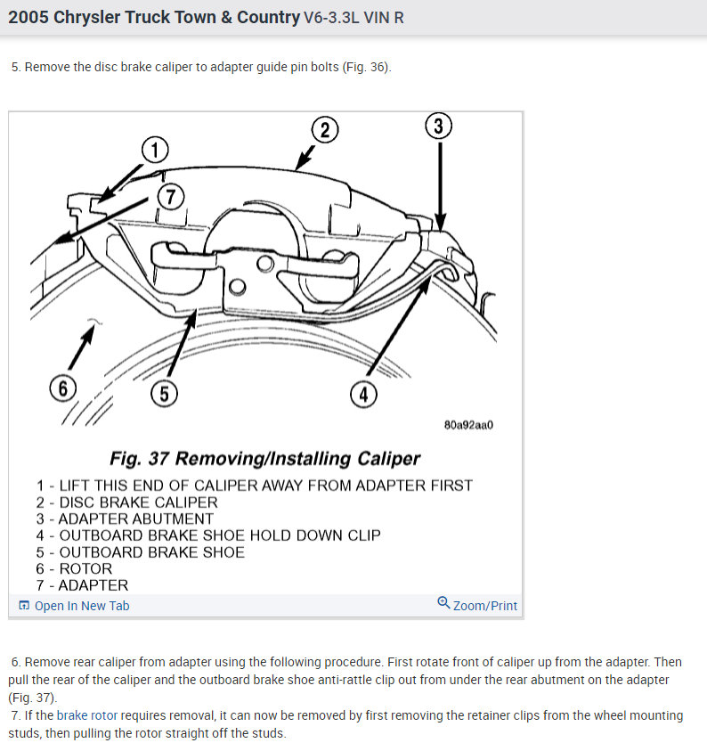

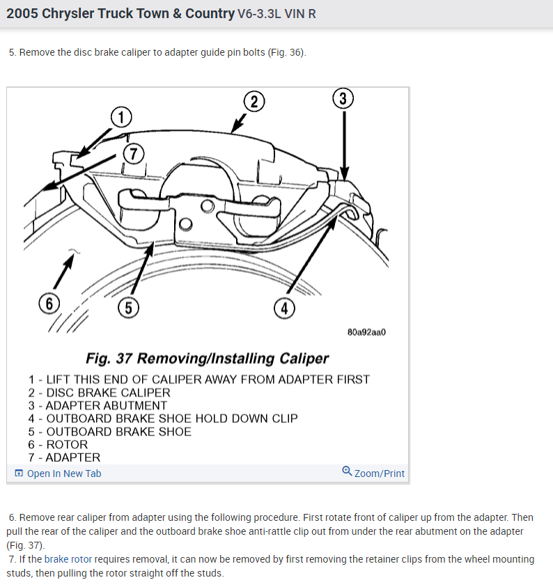

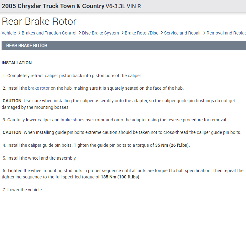

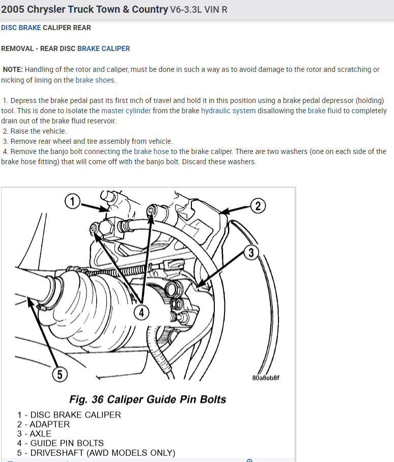

I have attached the rear brake rotor replacement diagrams below. Also included the caliper removal and installation procedure as well.
https://www.2carpros.com/articles/how-to-replace-rear-brake-pads-and-rotors
Any questions please feel free to let us know.
