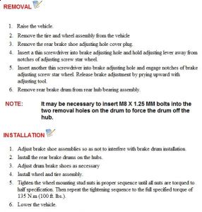

How do you remove the brake drums to get at the shoes.

hello and thanks for donating
https://images.2carpros.com/forum/automotive_pictures/261618_Noname_1913.jpg
