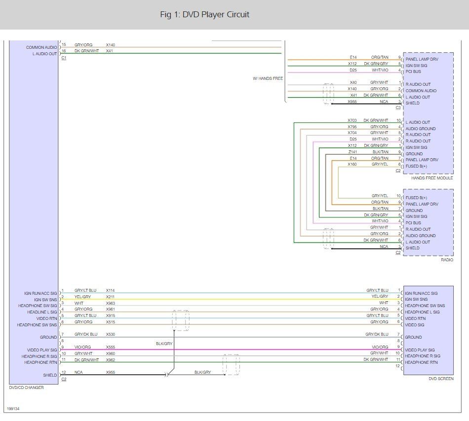

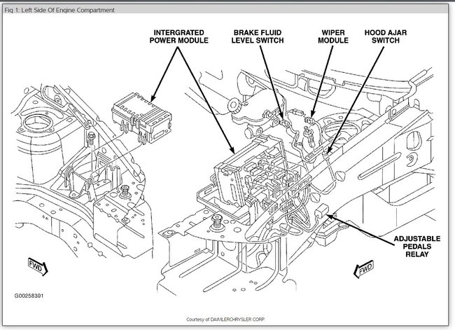

I live in Wisconsin. My Chrysler T&C has a CD/DVD player that holds up to 6 discs. The van was outside on an extremely cold day last week. It has not been uncommon in the past for the CD/DVD player to not work immediately upon starting after the car has sat in the cold for a while. However, after the car would warm up, the CD/DVD player would go back to normal - until last week. Since then, the lights on the CD/DVD changer simply flash back and forth - first the 3 lights on one side will flash on and then the 3 lights on the other slide will flash. They flash back and forth quickly. A couple of people (not mechanics) have suggested that it might be a fuse. We found the fuse box under the hood but could not figure out which fuse was for the CD/DVD player. I'd like to find out if it's a fuse that I can fix on my own or if it's a bigger issue that I need to take to the dealer.
Dec 23, 2009 at 9:03 PM
  • 54,861 POSTS

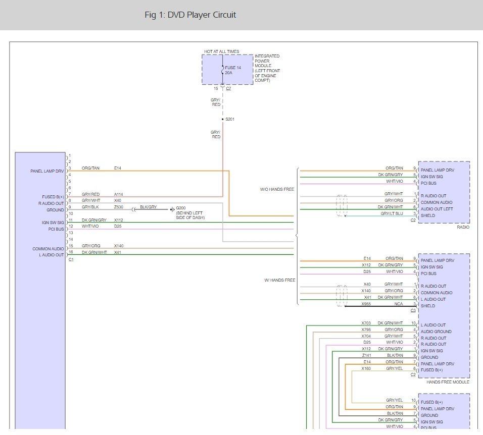

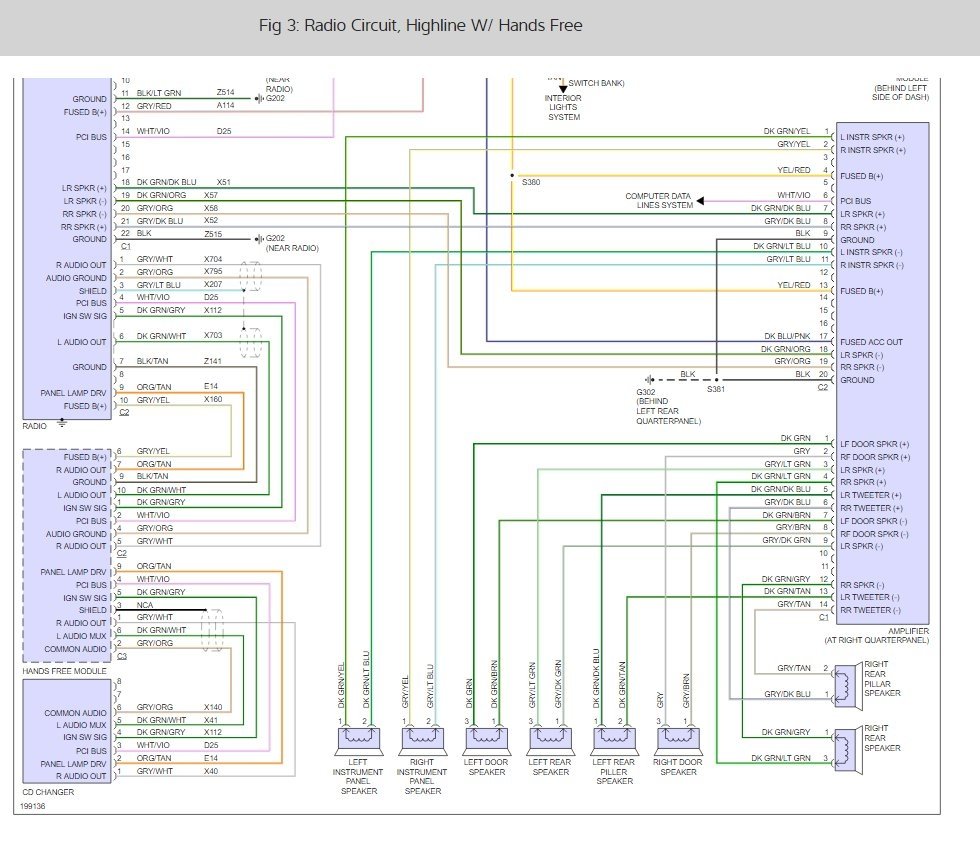

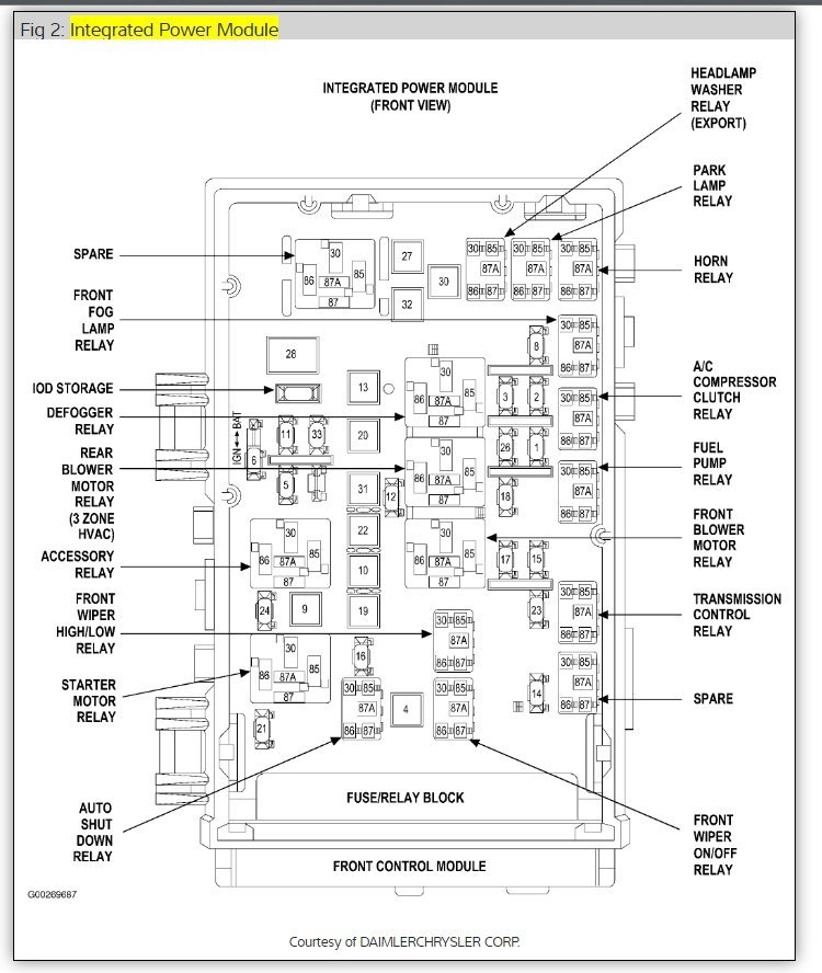

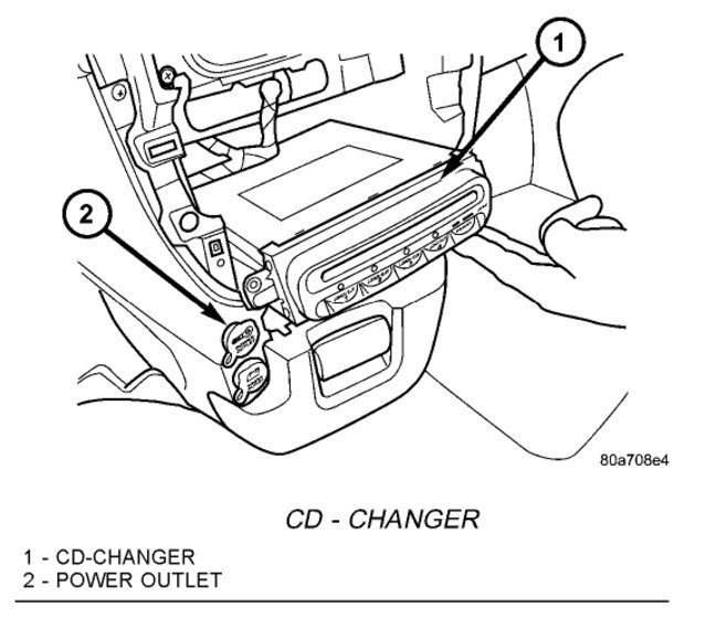

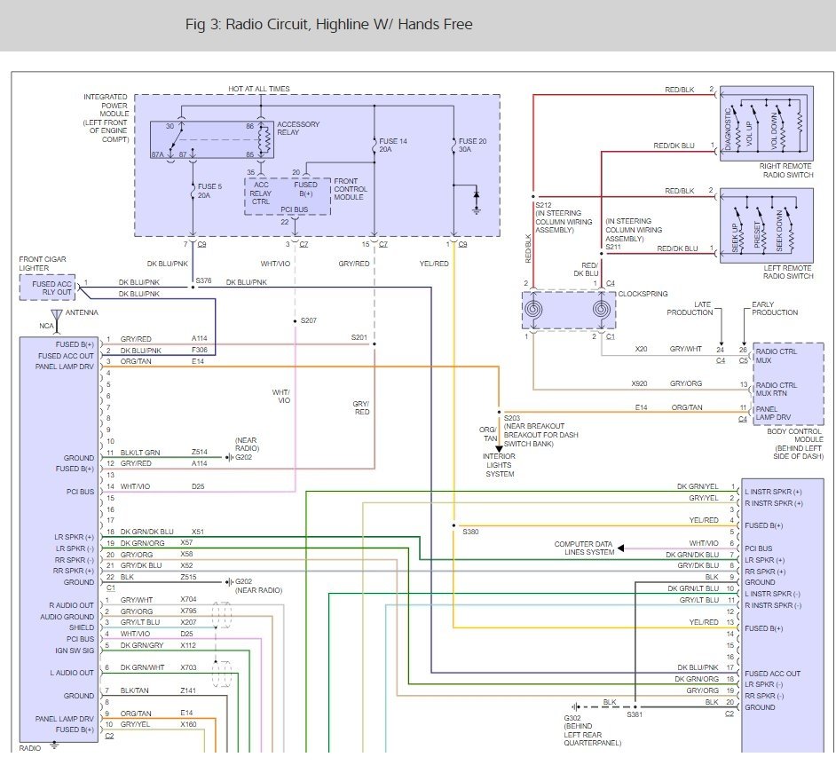

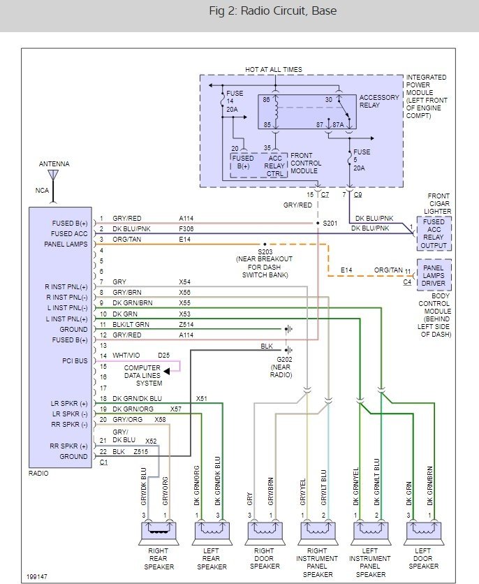

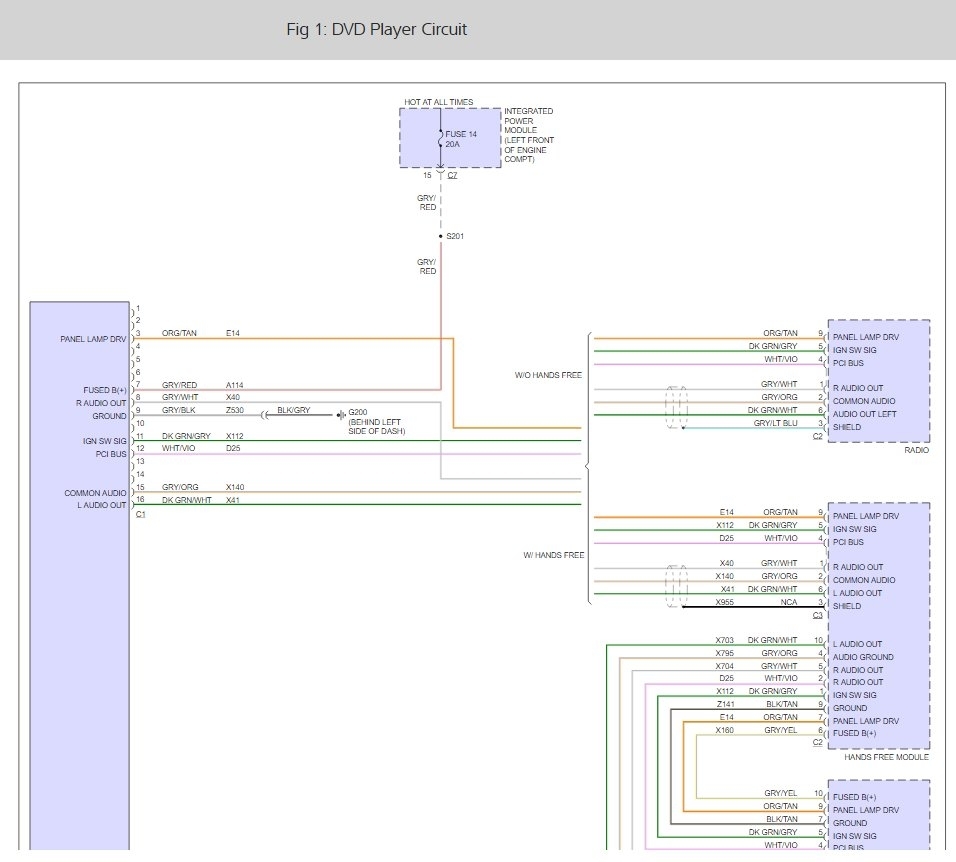

Sometime things get stuck in the player like pennies from little kids extra, This would require for you to remove the unit and remove the inspection panels to see if you can find out whats causing the problem. Here is the location of the CD player fuse and a wiring diagram (below) to help you do some testing. It is fuse 14 on the diagrams below.
It could also be the accessory relay, here is a guide to check that as well
and
Please run some tests and get back to us so we can continue helping you.
