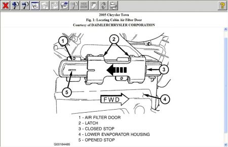

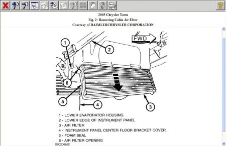

Where is the Cabin Air Filter located and how do I change it on 2005 T&C Touring.

https://images.2carpros.com/forum/automotive_pictures/12900_filter1_2.jpg
https://images.2carpros.com/forum/automotive_pictures/12900_filter2_2.jpg

Problem post! I am not sure whats going on here because ALLDATA and MITCHELL1 both say these images are right but the it keeps getting voted down? Can someone help me see whats wrong here?
