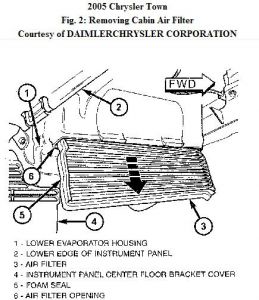

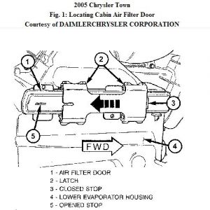

Six cylinder two wheel drive automatic.
I cannot locate the filter. According to the owner's manual, it is under the dash on the passenger side and does not require any tools, just slide the lock back, remove the access door and pull out filter. But I cannot find it. Perhaps you could provide a picture. Van is an LX model. Thank you!
Mar 6, 2009 at 2:59 PM
BLUELIGHTNIN6
  • 16,542 POSTS
Please note that the cabin air filter only comes equipped on vehicles with automatic temperature control and it was an option so some have it and some do not.

Thank you. Your site had the right answer.
