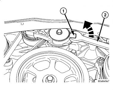

How to loosen the belt to change the alternator?

release belt tension by rotating the tensioner counterclockwise
https://images.2carpros.com/forum/automotive_pictures/261618_Graphic_95.jpg

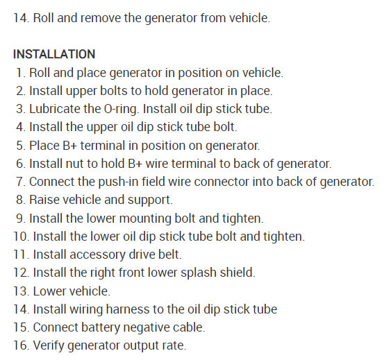

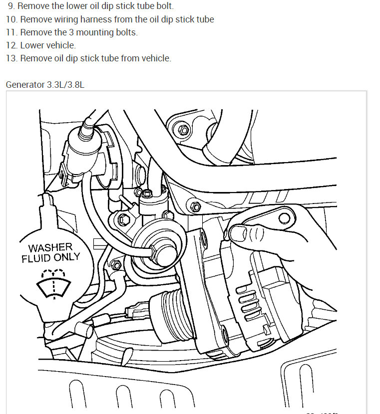

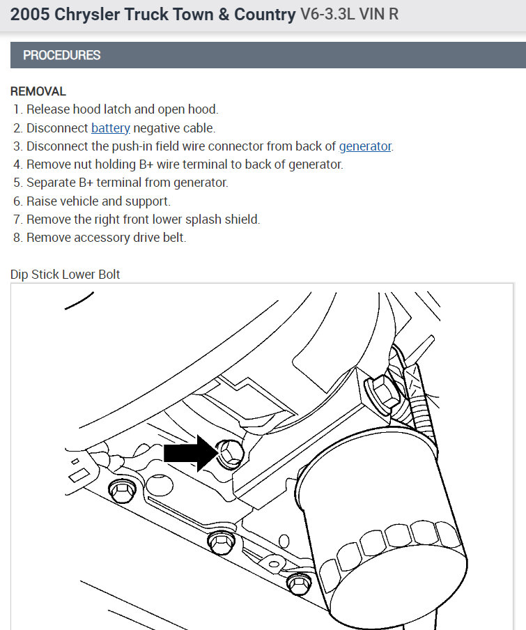

Here is how to change the alternator out in case you need it. Check out the images (below). Let us know if you need anything else.
