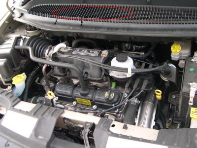

When I am sitting in the drivers seat I can hear water running in the car. When I go around a corner you can hear it run to the other side like it is up under the dash. I do not have any water leaking into the car or leaking under the car. I took it to the dealer and of course they could not figure out why you could hear this. This has not been happening all along so I know something must be wrong. The heat work and so does the air conditioning.

https://images.2carpros.com/forum/automotive_pictures/55316_05tccowl_2.jpg
Remove the windshield cowl (red circle) and check. That black cowl is one piece from end to end.
